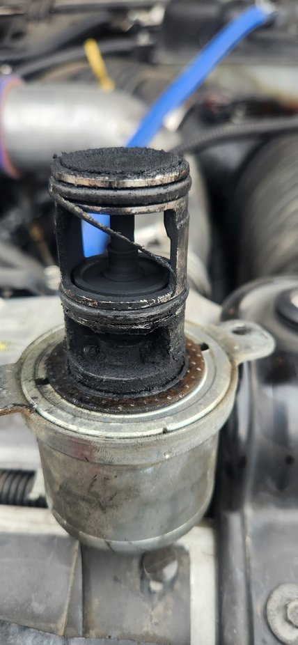

No bubbles at the fuel bowl. Pulled the EGR valve, bottom oring was split. Could have happened installing or removing not sure. Got a new egr valve. Drove about 10 miles on it and it felt unexpectedly better. Also watched for smoke after starting and didn't see any. Check again in the morning.
Here's a picture of the EGR valve
Installed 4k miles ago
Still going to look into new injectors. I like the idea of going with the Pure Power ones, basically good as new with updates. Looks like I dodged it for now but soon enough who knows. Wouldn't hurt to check the turbo too.
Appreciate the help, never would have thought egr valve

So, even with a welded plug in the Y-pipe, a leak in the (weak) EGR cooler could allow coolant to reach the EGR valve. I have never counted on EGR valves to be capable of being completely closed (leak free) even when commanded closed.

Just to be thorough I pressure tested the EGR cooler when it was out 4k miles ago. Only took it to 40psi but there were no leaks at that time. Did that before touching the heads and since then there has been no exhaust going through it.
I was surprised to see the EGR valve a little wet and thinking it was just oil residue from ccv / intercooler over the years. Coolant level has not changed.

All that I am saying is this - if the y-pipe block-off plate is solid, and the EGR cooler isn't leaking, then I don't see how the EGR valve itself can make any difference.....one way or the other. Afterall, the EGR valve's purpose is simply to regulate the flow of exhaust gas evenly to both sides of the engine (intake manifold).

Yeah I agree should not have made a difference. Maybe I got a leak at one of the egr cooler sealing surfaces. Maybe I'm imagining the difference. Hard to tell sometimes. I can tell you one thing for certain the ypipe is solid.
