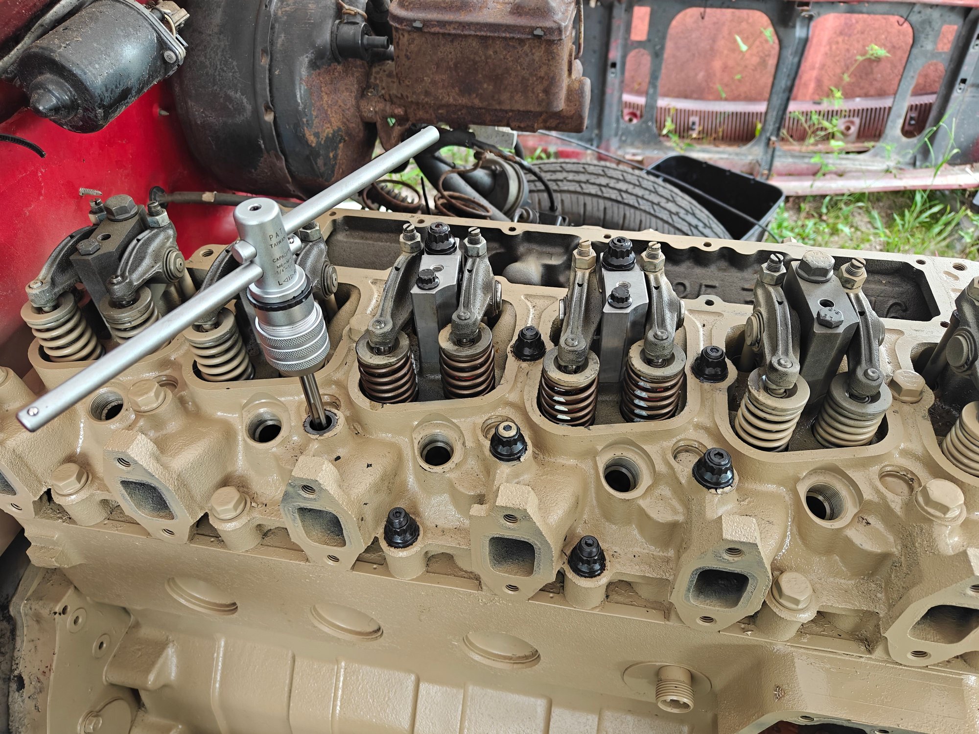

Yes. The performance parts have been ordered. Hx35 60/67/12, 5x0.014 Injectors, 3800 spring and fuel pin.
And many, many more parts. Most have arrived, but the injectors and turbo have a lead time of couple weeks.
Also, I'm installing ARP 2000 studs and 60# springs. I'm doing this without removing the head.

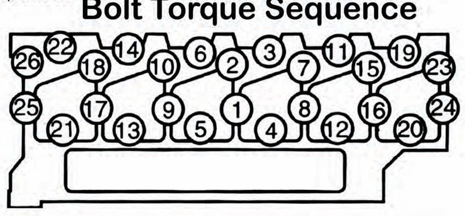

I almost finished the head studs and valve springs. All that is left is 21-26 on the studs. And the two springs on cylinder 6.
Not only was this easier than I expected, it was also a lot of fun. Soothing and relaxing, even.

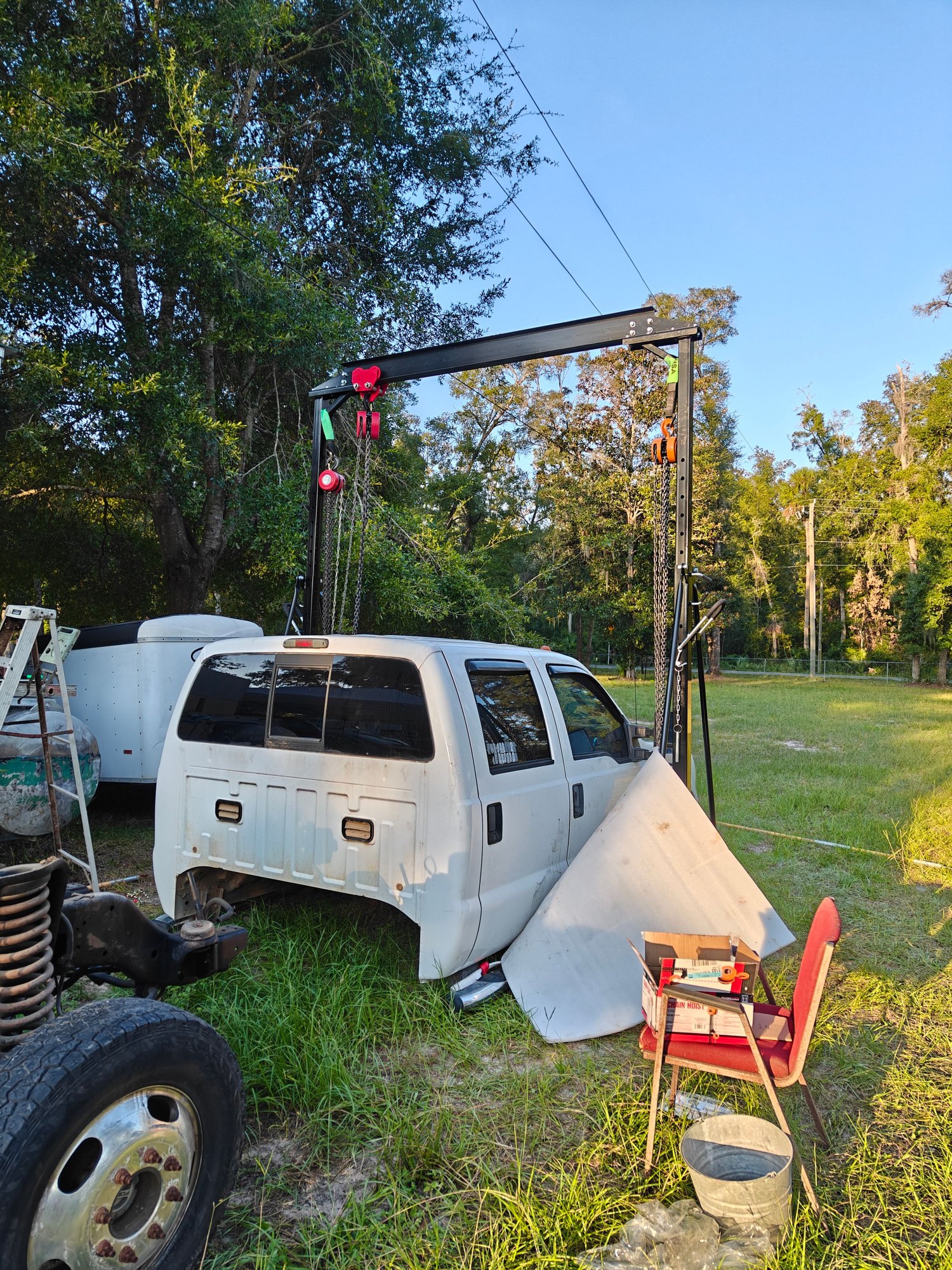

Not a lot of progress on the engine. Spent most of the weekend pulling the cab off the F350.

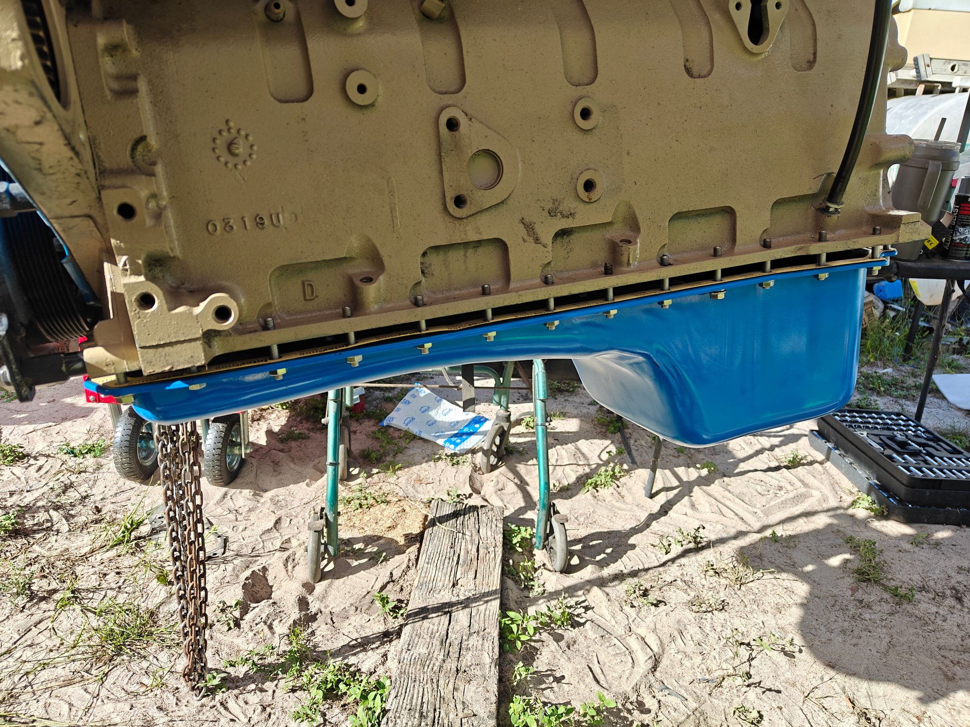

Instead of fighting with trying to get the oil pan and gasket lined up correctly and bolted, I ordered some studs instead,
This made it simple to install. I left it loosely attached until I get the new rear seal and seal housing installed next week.
