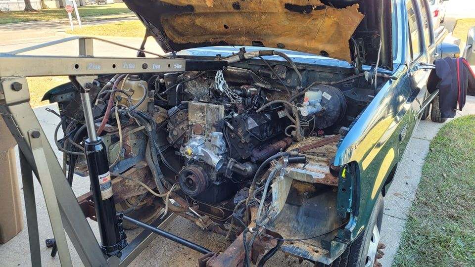

Hey folks. I just made what is arguably a poor financial decision and bought a 96 F-350, crew cab, dually. Unfortunately, it needed significant engine work, potentially an engine replacement, and had been sitting since 2005 sometime. Fortunately, I was able to talk the seller off his price quite a bit and also worked in him delivering the truck in the deal. Could have been better... but I ain't complaining. Anyways, here she is once she was delivered....

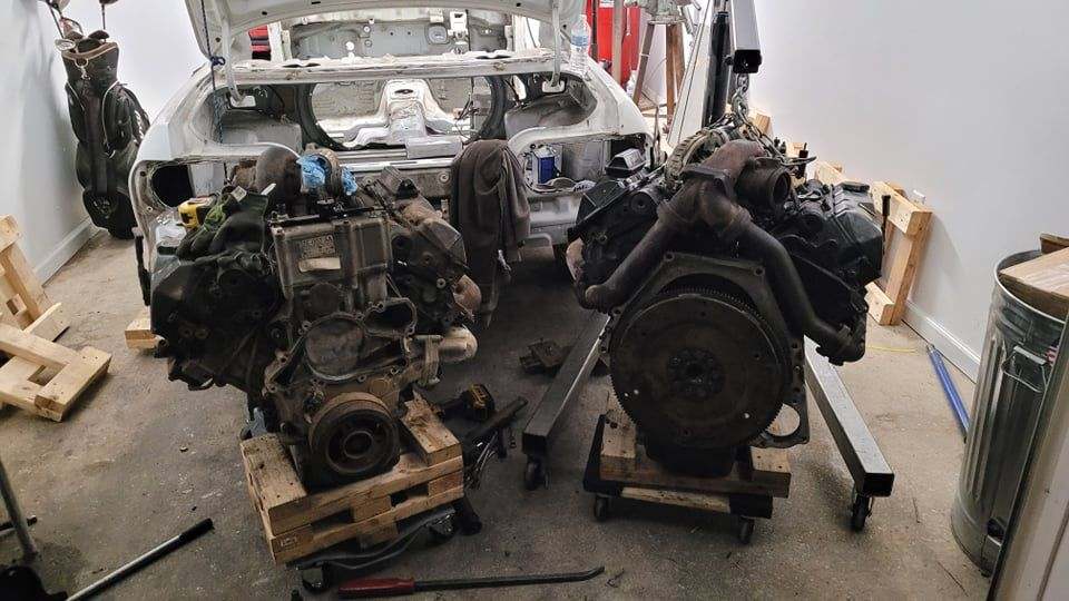

Once it arrived, I got busy with figuring out what was wrong with the engine. The person I bought it from believe it had an issue with leaking coolant into the oil due to bad o-rings/seals on the oil cooler (at least he said); however, one climb underneath the truck proved it to be a much worse issue. Turns out it had tossed a rod, there was a significant ding in the oil pan where the rod had hit and the block had chunk knocked out of it. So began the process of pulling the engine and trying to find a replacement.
I ended up finding an engine about 4.5 hours from me, and since I had not truck, I had to rent a Dodge Ram from Enterprise to go pick it up. Gotta say, this engine moved this truck around on the highway; no quick stopping or swerving at all.
The engine did come out of a higher mileage truck that had rolled, so after I got it home, I went ahead and resealed it and freshened it up a bit. Once that was knocked out it was time to pull the old engine. Out with the old....
In with the new!!!! Well, new to the truck.

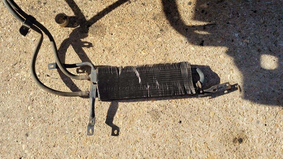

Also, anyone have a picture of how the trans cooler mounts? Once again, I didn't remove it, just trying to figure out where it goes until I end up replacing it.

as for the transcooler, get rid of the tiny factory cooler and install something bigger like one from a 6.0 powerstroke truck (03-07) or even a 99-07 super duty gasser cooler, anything is better than the factory one, well you can use the factory trans cooler as a powerteering cooler if you like.

That's the plan in the future, but for now I'll just get this one set back up. Though I do have an old oil cooler laying around I could probably make work.

Yah, those coolers are comical at best. Lots of GMT800 trucks (4.8/5.3/6.0) with tow pack and/or 4x4 like my '01 Z71 have a good sized trans cooler that could be pilfered from and 10th Gen F150s (5.4 at least with 70W or 4R100) and 1st Gen Expedition/Navigator 5.4s have large coolers could snag and repurpose. Only issue on the 5.4 ones I THINK they use 1/2" lines and the small block GM Gen III use a 3/8" pretty sure.
