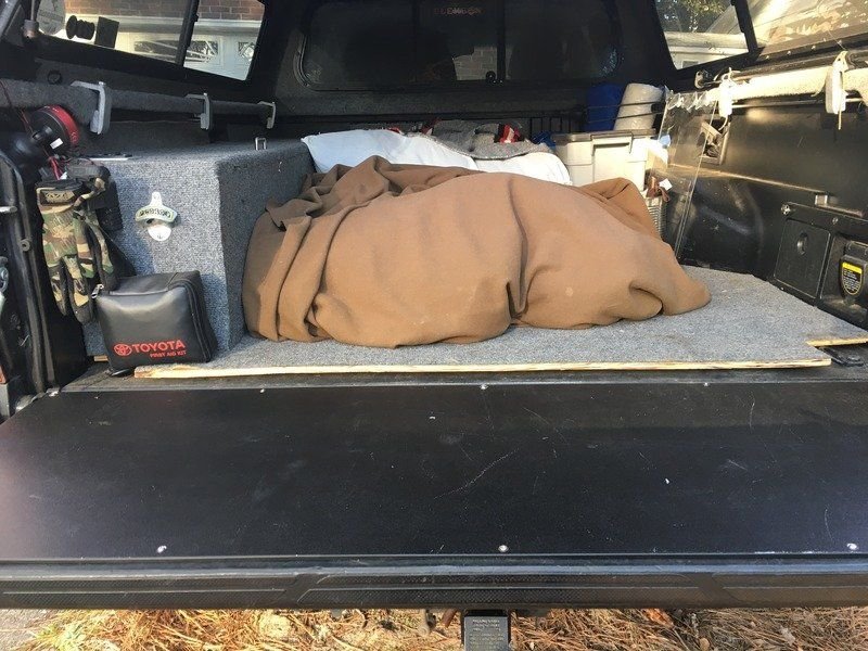

In the early '80s, My FIL plated his '77 TG on the inside with either 3/32 or 1/8" steel sheet, then had a piece of angle across the top that added strength to eliminate bowing under load and gave a reall secure grip as a fellow went to shut it, then it was all painted. Was a heavy tail gate, but no dents or bends from loads of firewood.
In 20r22 I just used the TG protector that came with my under lip drop in PendaLiner 83001SRX, but first I had installed a Stainless Steel bed top cover to add strength, this all on my NIB Ford tail gate. I had the TG and top guard since the '90s, bought this drop in liner in 2022.
Quick Question .... Drop In Bed Liner number? - Page 2 - Ford Truck Enthusiasts Forums but is post 17 what shows best view.
Was in the early 1990s I had used a similar drop in / TG protector and a Aluminum top protector, with great results.

Thanks for chiming in, @tbear853 That is a really nice solution. And it looks good too! I think a solution like that could work really well. Thanks!!

This was my solution.  About $30. of PVC and cement without any drilling.  Weighs nothing and easy to remove.
