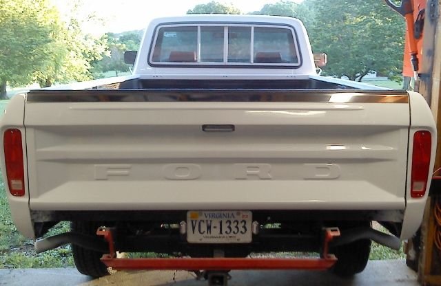

OK, here you go, the 83001SRX Pendaliner in my '77 F-150 long bed PU. I have not yet mounted the tailgate cover, but it fits great and this bed liner fit so close to the OEM bed insides that just the thickness of my reinforcements crowded it, so I trimmed it. I tempoapily removed the tie down U-bolts, gonna fab thin covers to cover the edges / gaps from bed liner to re-inforcements today.
Looking down from the porch, it rained last night. It came with tailgate panel that also protects top of tailgate, but I haven't yet put it on. Uses screws. It all has a non slip like feek.
It's OK, I had to notch the first one years ago for the same reason.
After notching, it lays nicely. I have a real bumper, but it's awaiting paint too.
Front does come up to the bend. I haven't yet screwed it down though, might use nut inserts and some shouldered 1/4" ss hardware. I think was here someone mentioned doing that. Maybe 1/4-20 button headed socket screws and short spacers to not pinch the bed liner, coat threads with never sieze, snug them. Might can reach with a wrench (piece of paper to wedge nut in wrench securely) and apply a lock nut on cab side of front wall, just skip the threaded inserts. All in stainless natch'.
Between some showers and dust, the bed liner could use a wash now. Later after posting, I put the polished stainless tail gate top guard (bought 20 yeas ago anyway) and Pendaliner tail gate cover on, I taped inside the stainless, then used some straps to pull it tight onto tail gate, then followed with tail gate inner liner that also sits over top. I had extra screws, added 4 extra holes along lower edge and a extra dead center of top. Those screws self tap, the shoulder goes through a 5/16" hole in plastic.
