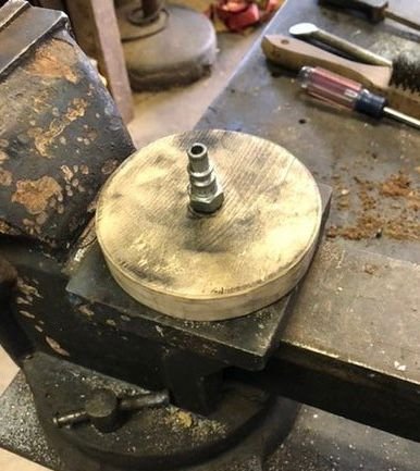

@F350towing My detector is similar to yours but I use a small pressure regulator with a gauge that has a short hose on it. I put the regulator between the tester and the hose from the compressor. I use the regulator for other things like my smoke machine and plasma cutter so it's has quick connects on it. I never put a ball valve on it to see how long pressure holds, I just put about 20 lbs on and use soapy water at the connections. Next time I'm going to use my smoke generator and see how it works.

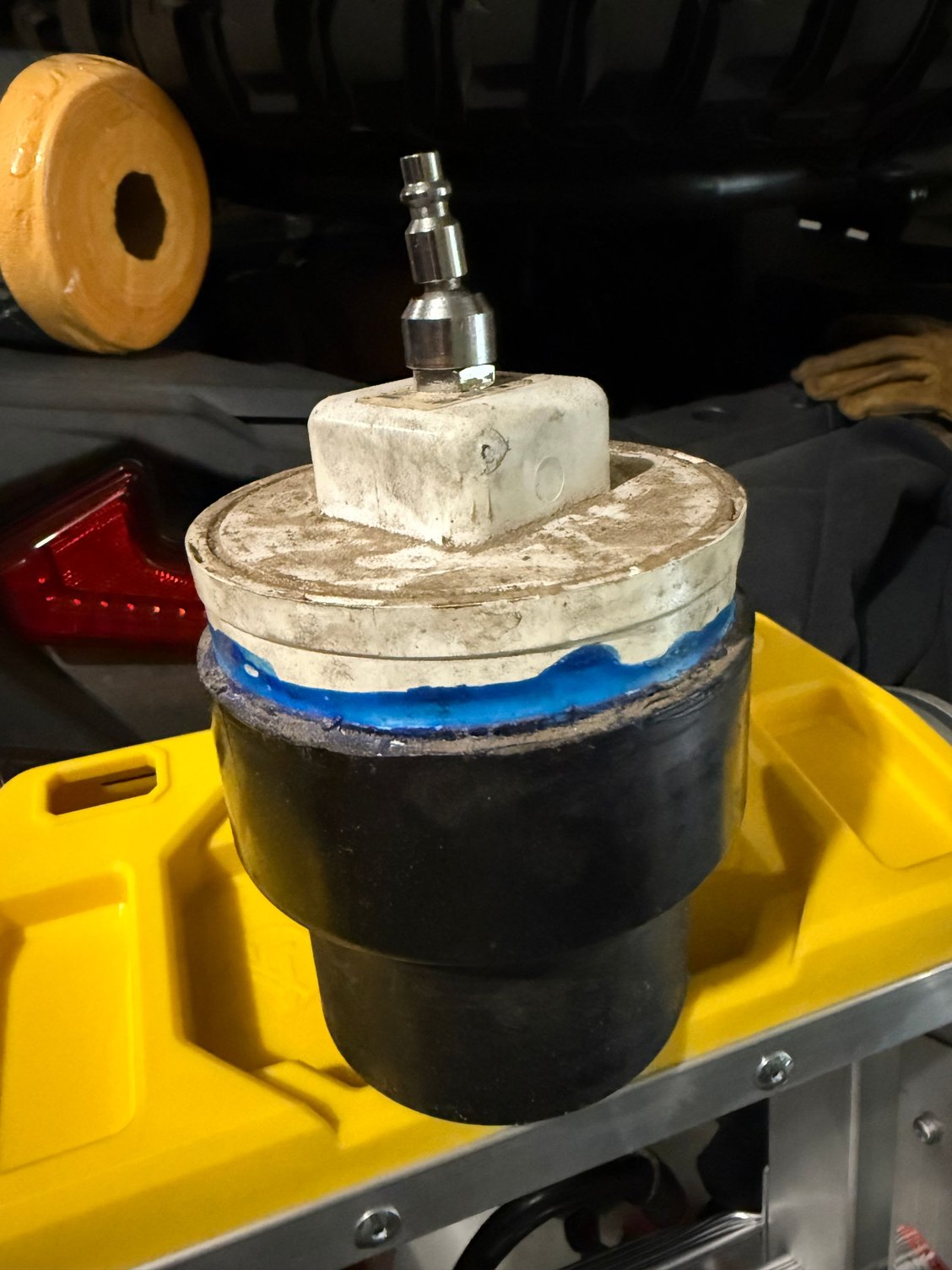

While something like the KC tester is very nice...if you go to your local hardware store, you should be able to get what you need for little money, that's what many did years ago. This is what i made...it's ugly but does the job. I have a gauged regulator i hook onto it; which also allows me to turn on/ off the air supply right there. I can also hook up a smoke machine to it, which makes life easier in finding leaks
