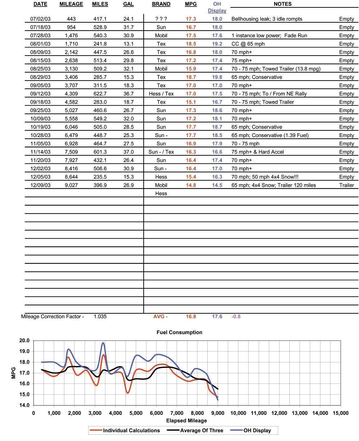

From when she was new. Towing a 9,000lb trailer in the snow was the worst.

In a 20-mile run to where I used to work, or 40 miles down to my farm, I have one hill. That's negated on the drive home. If you are at the NJ Shore, you are a flatlander. Basically, it's all highway driving. Winter takes its toll.
It gets worse (for you) when I later tried some fuel-saving techniques after 13,500 miles, like lowering my top speed and going back to the stock tires from the BFG 285s.
