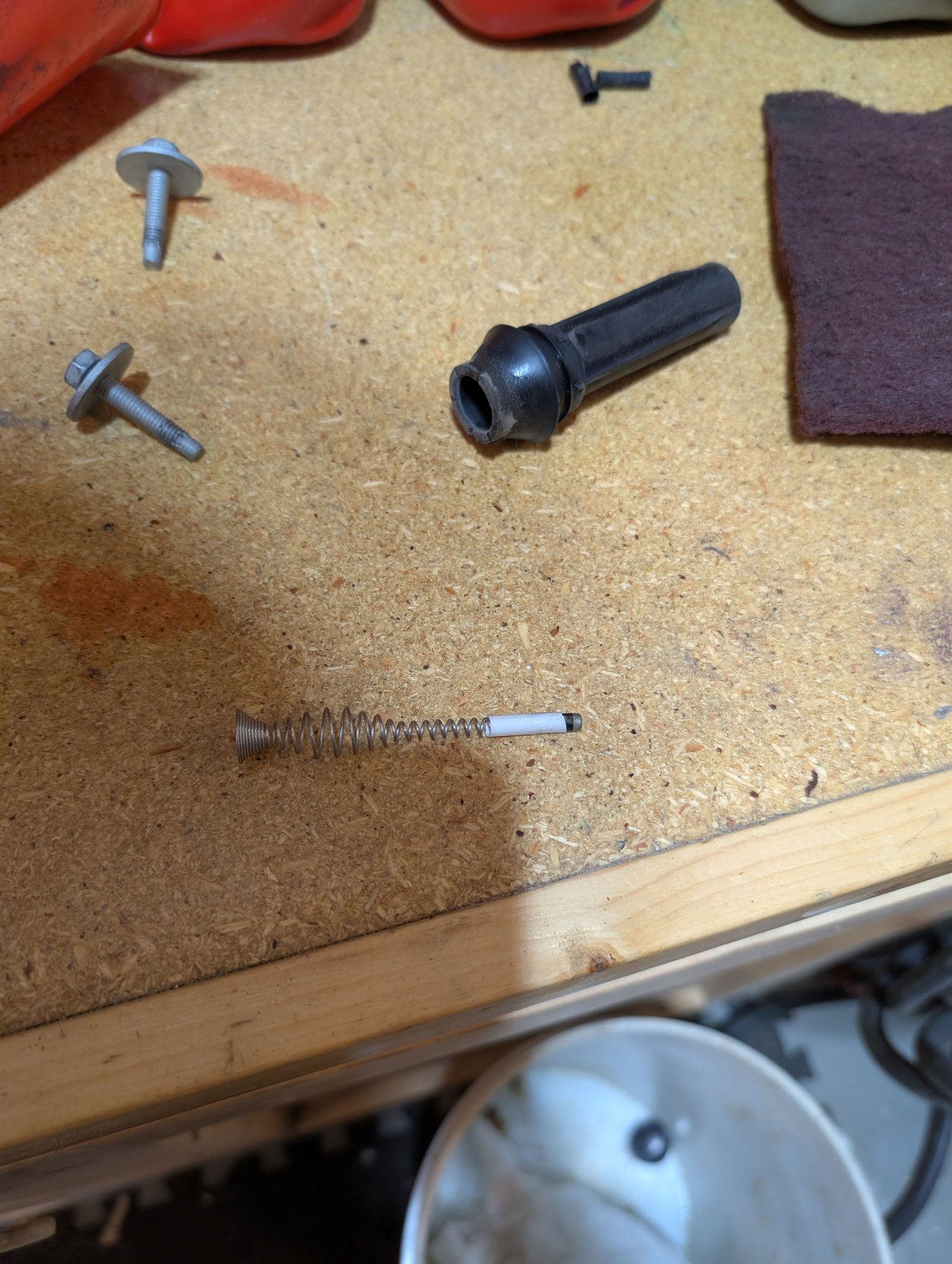

Manual says tune up is due at 97,500 miles (probably some conversion from km - confirmed, 150,000+Km), so I got plugs and wires and looked into it. The plugs look OEM, and the gap opened from .042" to .055". The coil packs are all functional, no idle/running issues, and no codes. Removing one of the coils, everything looks good, but the "fins" inside which holds the resistor "pill" and the spring are very degraded. The pill disintegrated when I tried to clean it - 2 metal caps, and dust. I was hoping to get a resistance reading, but I'll have to try on another - skipping any cleaning attempts.
I believe after 75-90,000 miles, the pill starts to corrode and swell. The corroded pill that came out was wider and almost 2x longer than the replacement. I'm assuming there is some resistance changes, then probably some internal arcing which weakens/eats the fins.
The new pill dropped into the coil pack, fell sideways, and was rattling around, "hotdog in a hallway" style.
Since a new pill would be useless, I took the old spring and stretched it out to make it fill the gap. While it will have more EMI/RFI, it's only temporary.

I take it your talking about a 6.2 gas. The coils eroding where the coil holds the resistor up is common and the easy fix is to use a piece of shrink tubing to hold the resister upright. When the resistors go bad the coil arks around the resistor eating away at the coil housing.

I changed my plugs, boots and wires at 80K and after seeing what the resistors looked like I will change the boots and resisters at no longer than 50K.

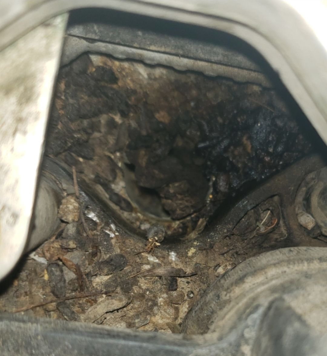

2 and a half hour job you say...
Hour 3:
Top plugs 3 and 4 holes were full of "Rodent Excrement", and are being dug out with an assortment of long pokers, and vacuumed with a HEPA bag. I finally got down to the plug themselves and they won't budge.
Um...
Um...
This is it after the 3rd excavation:
Plug spotted!
Plug spotted!
Pretty sure there is a corrosion creating puddle of filth at the bottom.
Soaking it in WD overnight should help.

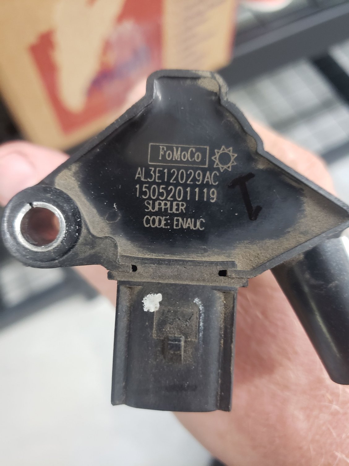

Old Coils:
Date Code: May 2015 - Fresh for a 2016.

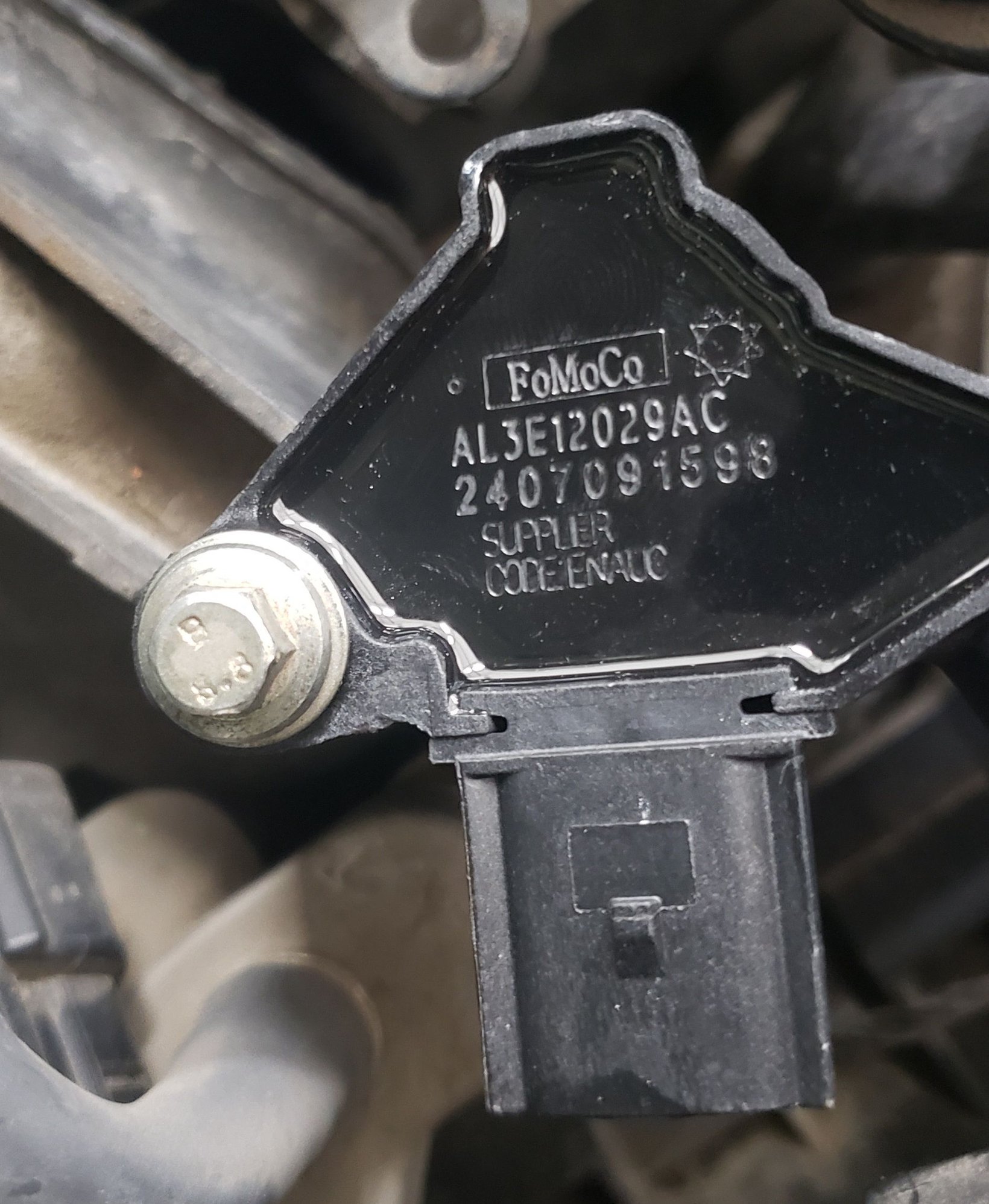

New coils:
Date Code: July 2024 - Nice!
