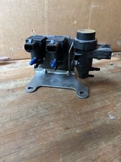

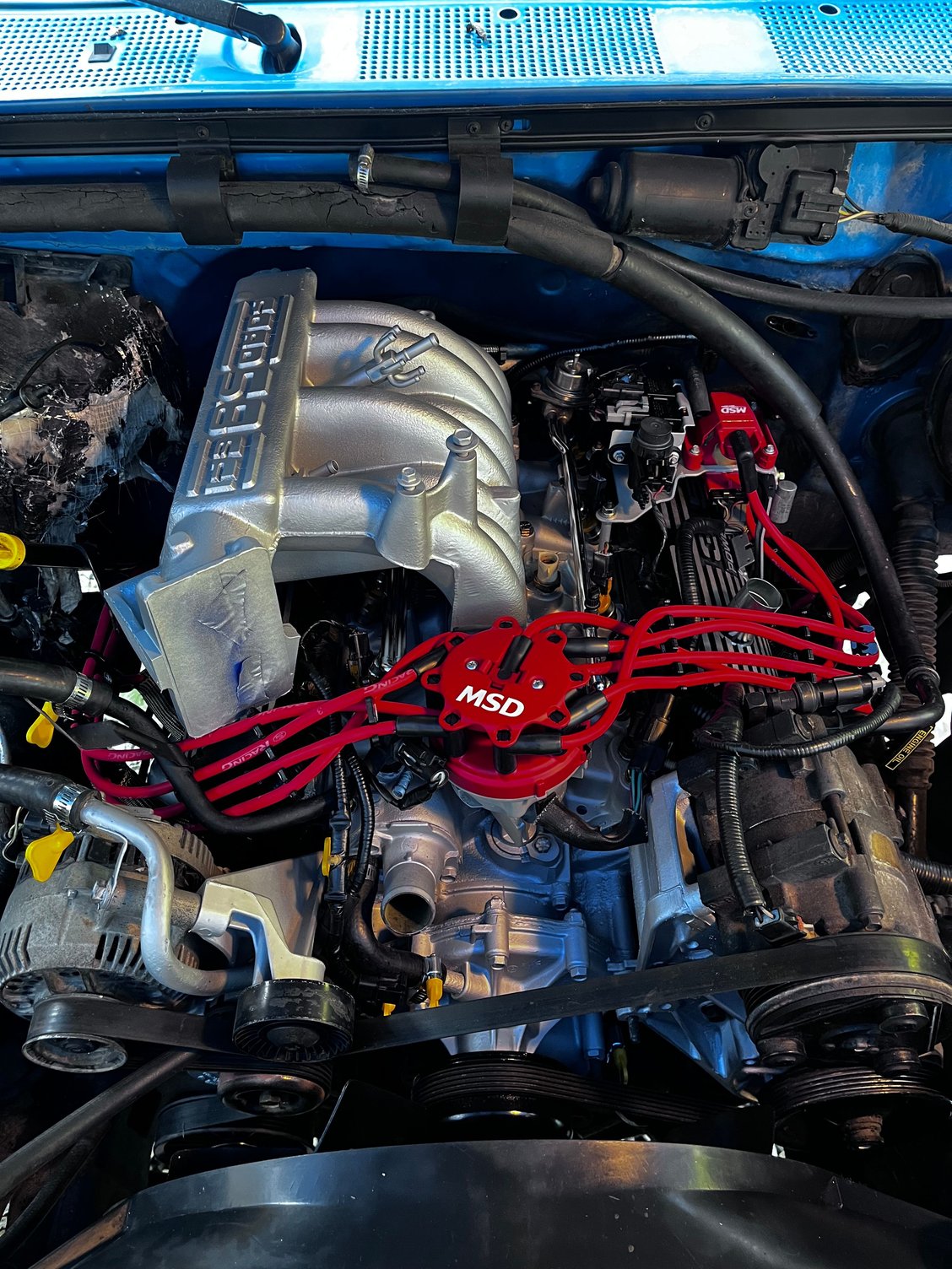

Iv relocated my egr diaphragm and sensor and plugged the back of the egr diaphragm with some gasket maker and an aluminum can. I had to extend the wire for the egr sensor. I just now got my upper intake back on and I’m about to put my vacuum lines on but I have two lines that have nowhere to go. They went to these diaphragms that are no longer on the engine. The vacuum lines that went to these are the ones in blue tape. What should I do with them?

Do I remove the vacuum lines attached to tad and tab solenoids?
I did not. I kept the vacuum lines attached to the vacuum supply side and to the TAB and TAD “in” port. Then I put a vacuum cap on the other port of the solenoid

What you do is...
Use your vac diagram & delete everything that is fed from the vac reservoir except the HVAC & EGR solenoid.
Leave the TAB/TAD solenoids electrically connected.
Your MAP, vac reservoir & fuel press regulator stay on the manifold vac tree.
Iv done a lot of research but I can’t get a straight answer
I found the answer by reading those delete threads and provided you with an explanation of what I did on my truck.
I found it was easier to keep the factory molded nylon hoses and cap off the output from the TAB/TAD solenoids than running new hoses for the EGR. I ran it that way for approx four years without setting any fault codes. Whatever works best for you.

I essentially kept the nylon tubing, just spliced it to run the necessities & left it in the split loom.

Thanks for the help everyone. I just took the truck for test drive and it didnt throw any codes and ran really well. I took it easy tho. I’ll do some more test driving soon
