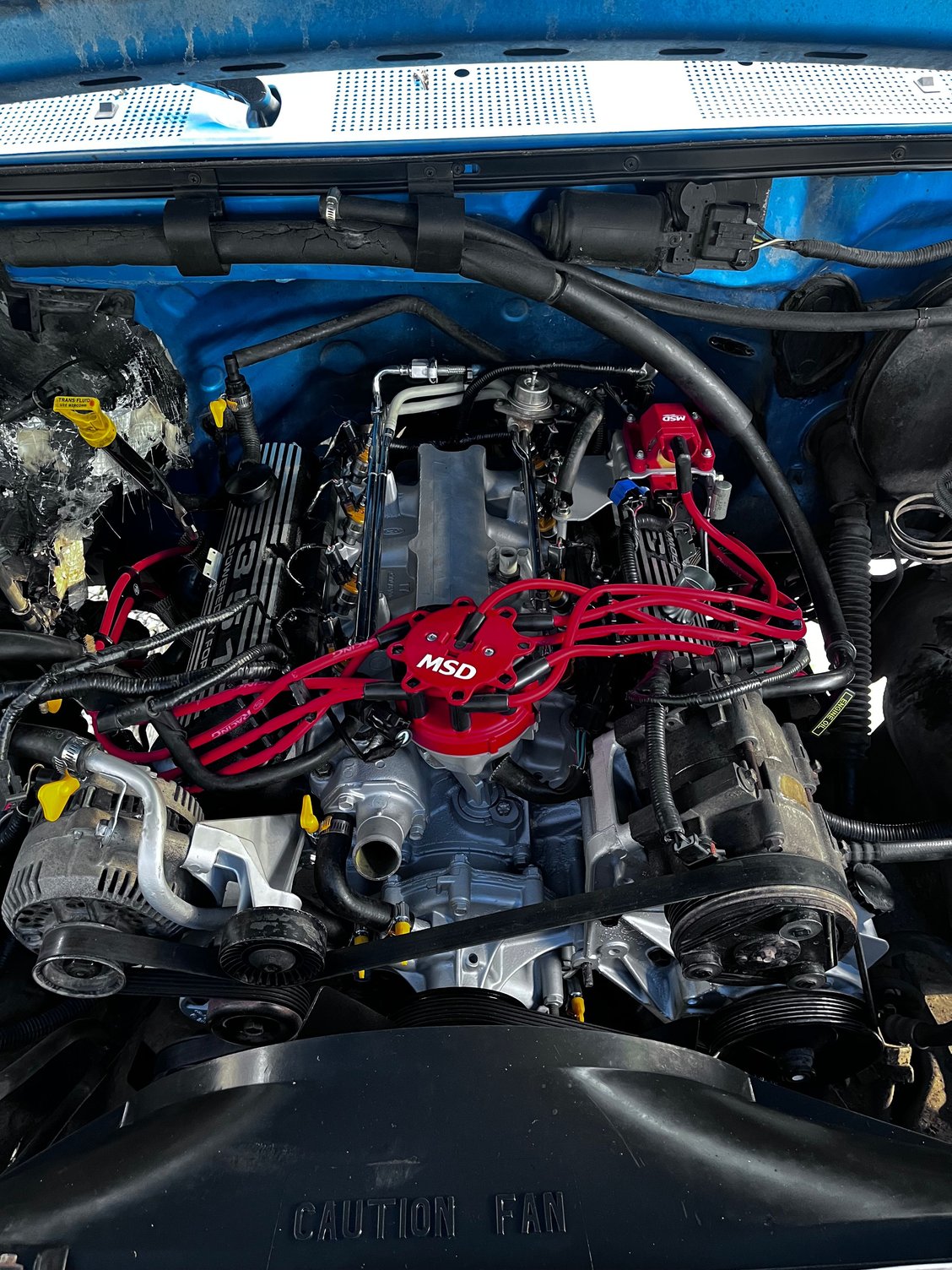

After thinking about it all day, I think I want to try and move my egr diaphragm to the fire wall, extend the harness wire for the sensor so the sensor wire will reach the fire wall and plug into the egr sensor. Then I will put the vacuum line on egr diaphragm nipple and put the vacuum lines on the TAD, TAB, and other solenoid in front of the coil. Then I will plug the wires into solenoids by the coil and call it done?
someone please correct me if Iv got something wrong here.
I definitely don’t want to spend $1400 on a custom ecu

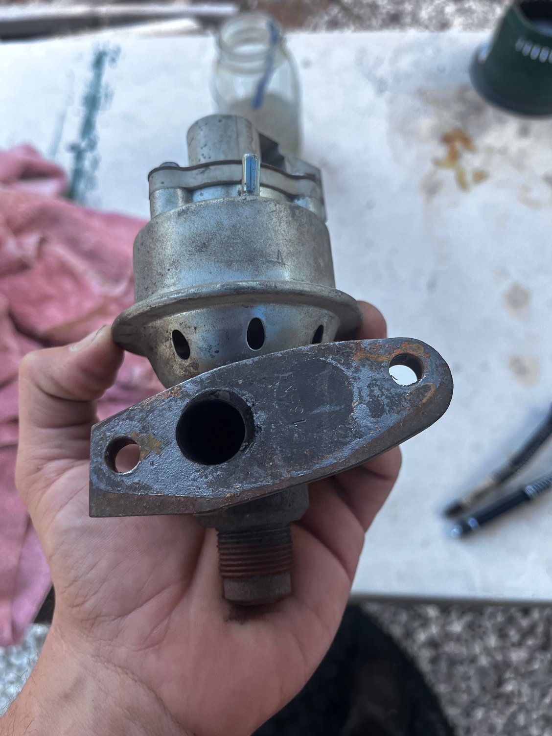

From: Branson West, MO
Between the EGR valve and the manifold.
This hole?
This hole?
Old Aug 6, 2025 | 02:48 AM
My4Fordtrucks's Avatar
My4Fordtrucks
Joined: Jun 2015
Posts: 12,870
Likes: 2,443
Yes. What is your reason for deleting the EGR?

I started the egr delete because I wanted to be able to maintenance the passenger side of my engine without all the egr tubes in my way, have a cleaner looking engine bay, the pipe going down the catalytic converter was cut off and plugged when my exhaust job was done some years ago. Then when I put gt40 heads on, I didn’t buy the gt40 heads with a hole in the back for the crossover tube between the two heads. It’s been about a six month project so far, working on weekends and free time and waiting on parts to come in the mail. I think my engine bay has never looked better. It actually started when I had to change out my lifters. I figured since I was already that far down into the engine, it was a good time to clean up the engine bay as much as possible.
Originally Posted by Nmaykdm
This hole?
This hole?
Do I have to plug the hole on bottom as well?
