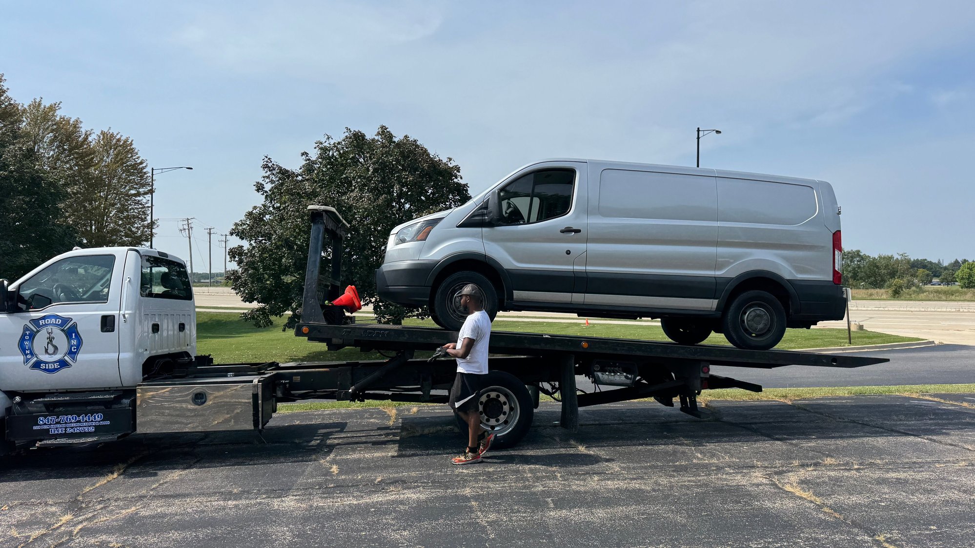

I’m driving a 2015 Transit T150 165,000 miles and recently broke down on I-80 and was towed to a central Iowa ford dealership where I was given the bad news of a blown engine and repair estimate way higher than I expected. I paid for the diagnostic and had it towed home where I am trying to figure out what my options are. Is this a common issue for the 3.7lL V6 flex engine? Has anyone else had this problem on their ford. What is the fix? New motor or take old one to a machine shop? These vans are quite different than my super duty. Thanks for the help.

did they tell you what failed? rod,valve broke,
cost wise, i'd go the ford exchange engine route, better warranty coverage ,

No they didn't say what exactly was the issue other than it needs a new motor. Whats a ford engine exchange?

No. This was also the police interceptor sedan and utility engine for years, and was in some Lincolns and four years of F-150s. Not common to hear of one "blown".
Engines fail sometimes. Depends on how well it was built, how well it was maintained, how much it was treated, etc.
What is the fix?
For a blown engine? Replace the engine. These engines don't have a lot left in them after a failure like in the olden days. If it is a rod through the side of the block, then you'd have to replace anyways. Having someone repair your engine, if it is even possible, is going to be more expensive and less reliable than purchasing a rebuilt or new unit.
Get a new or remanufactured engine. Machine shop path will be expensive, will take a long time, and may not even be possible.
