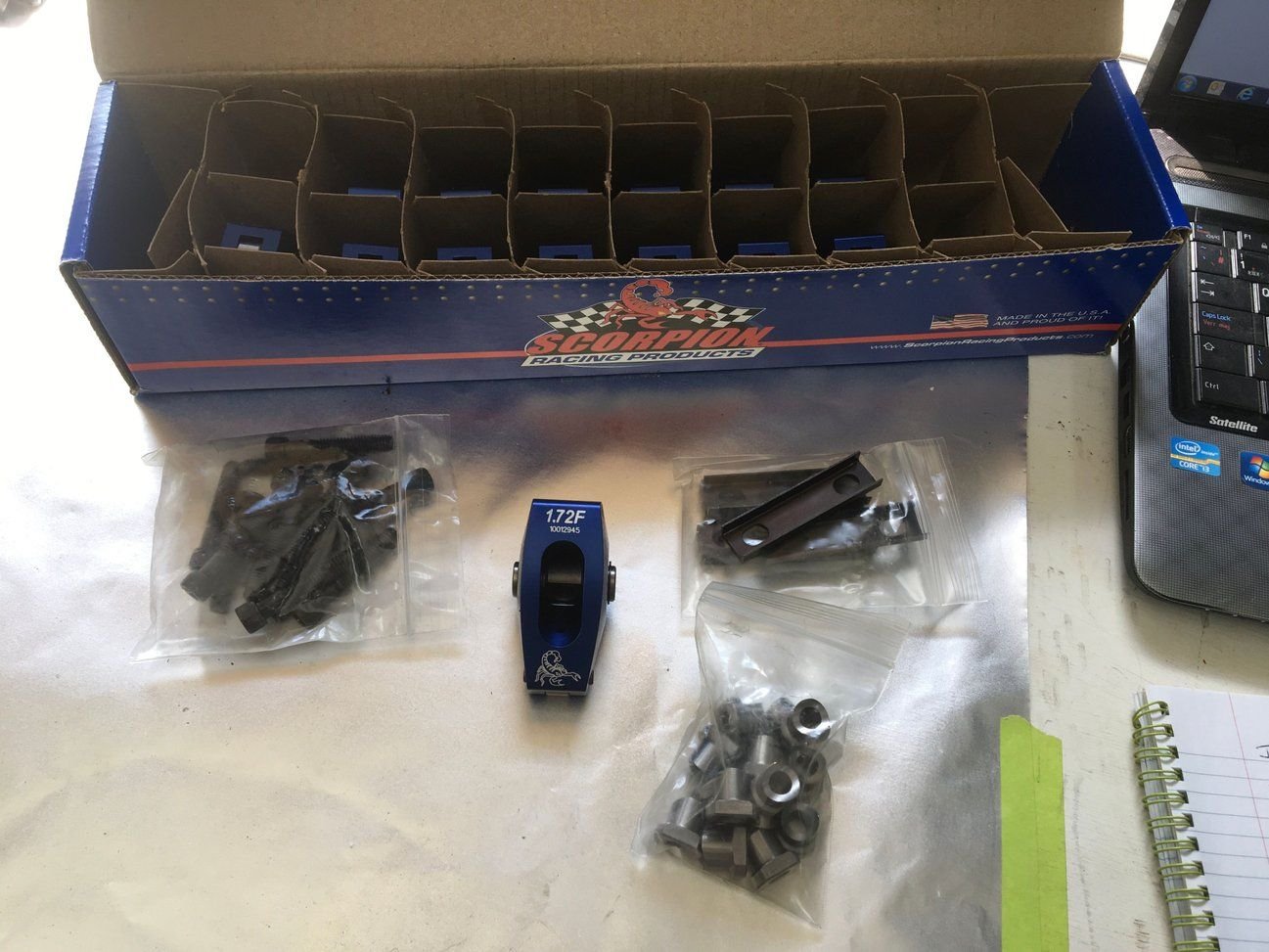

I used those on my ‘96 351w. No complaints. The Scorpion techs were good to deal with and helpful with a phone call question. I’ll use them again. I was happy to stay with the oem billet steel cam. This set up was recommended to me by techs at Ford Performance, and I was able to stay within the limits of a stock PCM.
They fit into the mounting plates well, and had very little play. No issues setting them true.
I had to modify the oil baffle on a set of stock valve covers as well. I’ve read in a few threads it’s hit or miss if they will work or not (no pun intended). Using the steel core rubber gaskets.
I measured pushrods and took my time setting everything up true. I bought shims, but did not need any.
You can wade through my build thread. Starting around pg. 32-34 is where I got into the Scorpion roller rockers and springs. Pg. 53 (Post #789) has the valve cover mod.
https://www.ford-trucks.com/forums/1...roject-32.html
Somewhere in my thread I linked an article of gains made by roller rockers, on a SBC. I could not find anything for ford.
Few random pics for your reference.

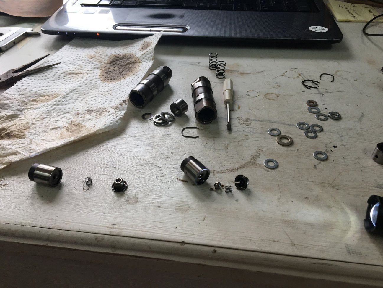

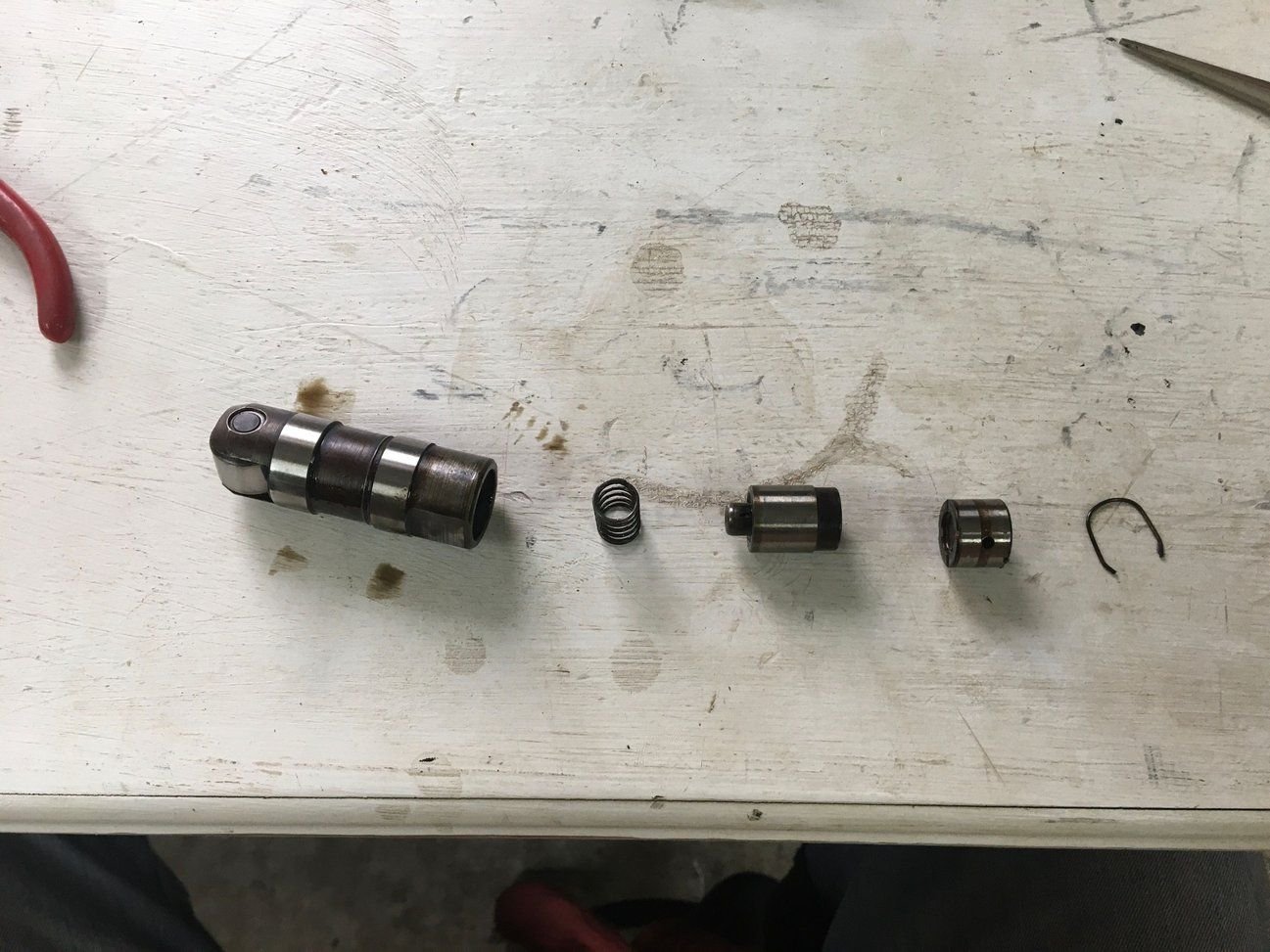

Do you mean for setting the valve lash?
Pg 28 on my thread addresses the lifter. Not sure how you could keep one pumped up with oil while doing this.
I made a solid lifter using washers out of an old one. Just make sure you don’t get it mixed up with the other ones, it’s only used for setting up.
