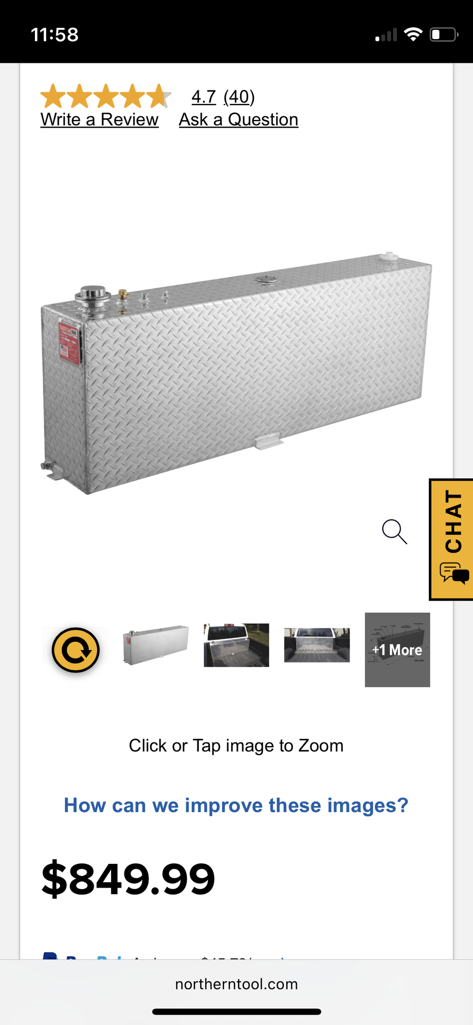

With an 8’ bed you could put one of these up against the front wall and have an extra 45 gallons of driving range. Only if you have a diesel though.
