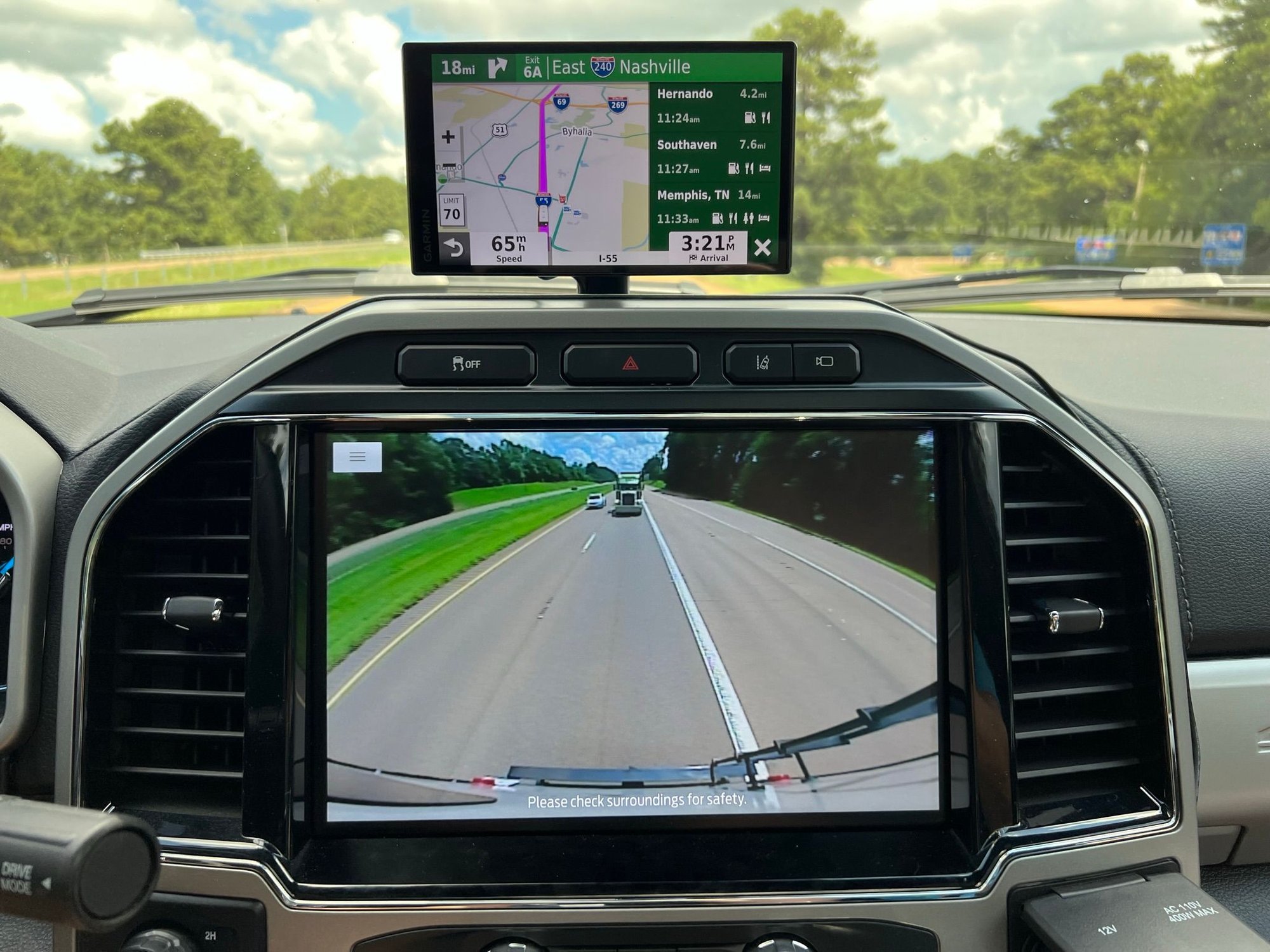

On my 2022 I can see the camera at speed, push the camera button, then the auxiliary button.

I can definitely view the trailer camera while at highway speed. Hopefully that will still be true on a '25.
Yes it all plugs into the 12 pin connector. The harness comes with a socket for the bumper in case you don't already have it. You probably have an in-bed plug already. Some things depend on what options you purchased with the truck, like the Pro trailer stuff or the 5th wheel prep.
Yes I zip tied my 7-pin and the new 12 pin umbilicals together. You don't have to, but I like it that way.
I would recommend you combine the trailer TPMS system with your Camera puchase. It all plugs together and connects to the truck via that 12 pin.
The newer model camera can mount wherever you want. You can put it up next to the Furrion I'm sure, but it does not connect to a rear marker like the Furrion does. I would suggest you leave the Furrion right where it is and find a spot for the new camera. I tested locations and found I liked a lower mount position than the roofline. But the position is entirely up to you. The camera surface mounts, or you can flush mount it if you want to cut some holes in the rear cap.
I like the camera a lot, and of course I like not having another monitor on my dash. But what I don't like about it is that, backing into a campsite for example, every time you shift from R to D or P, the view on your screen will change. If you are jockeying into a campsite for example, and going forward and back repeatedly, you will have to select the trailer camera each time. My wife has taken over the task of managing the camera view while I'm positioning the trailer. I don't ask her to get out and direct me anyway, because I've got mirrors and cameras and I want to stay married to this lady. Anyway, I still consider it an annoyance. I have read that some people have figured out how to make the trailer camera come on each time they shift to reverse, when a trailer is connected, instead of the tail gate camera. I have not figured out a way to do that on my '24.
Regarding the Furrion, like I said, leave it there and you might decide you like both, or at least the option to have both. It won't hurt anything just sitting up there without a monitor synced up. And the new camera is not going to be a direct mount interchange.

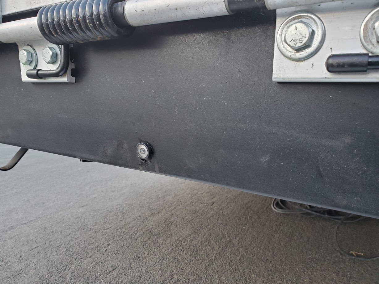

I removed the Ford camera from the enclosure that it was in. I then drilled a hole in the bumper and the camera pokes out that hole. The cable is routed under the trailer. I have a Furrion camera mounted up above the cargo ramp that I still use every once in a while. On my previous trailer I routed the cable on the roof. I never liked that, but it was a travel trailer/toy hauler, so it made sense to route it high.

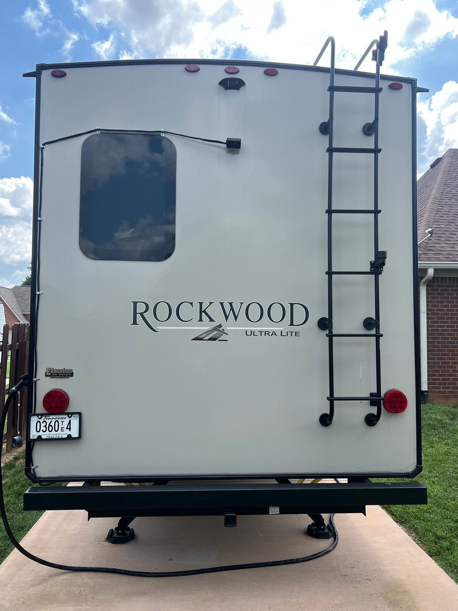

My install isn't for everyone, but it was easy and it's held up for several years with no problem. I ran the cable down the back side, then clipped it to the frame rail on that side. Camera location and angle lets me see traffic while driving, and the rear bumper when backing in.
