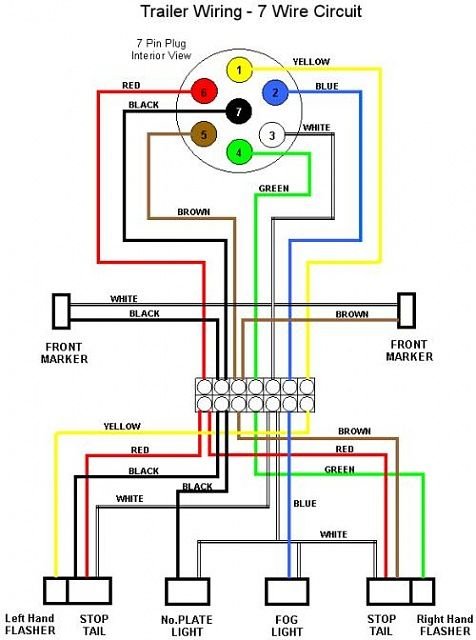

Actually found this online : If it doesn`t help you i`ll bring home the one i have.
