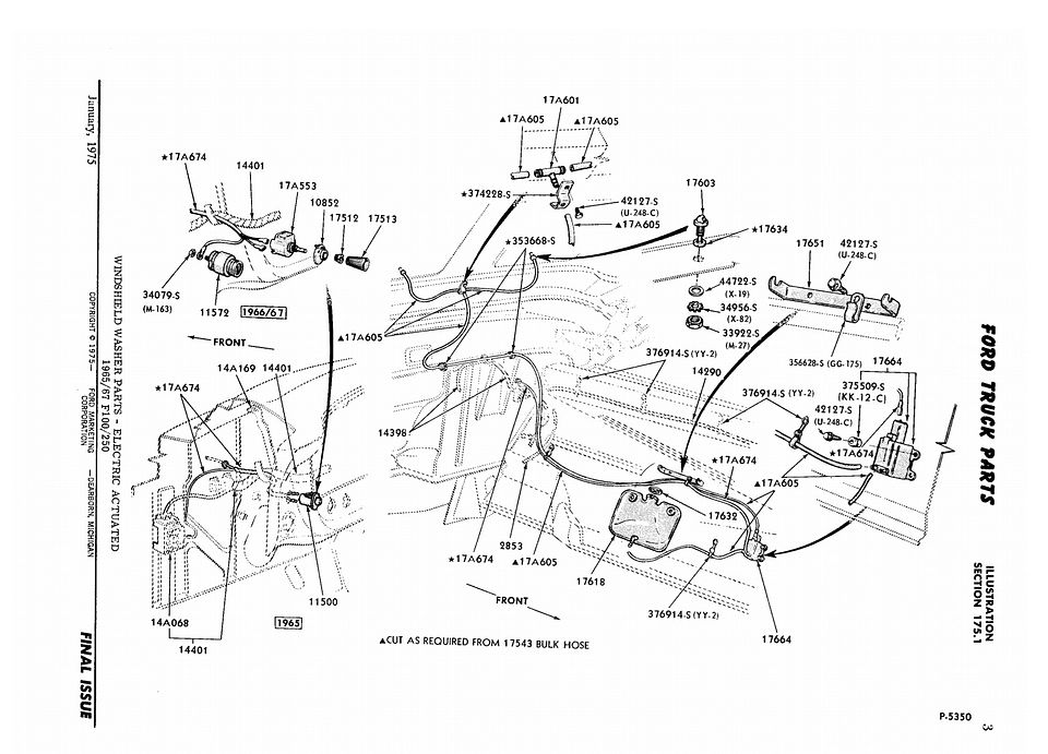

The truck I am working on has a pump, the nozzles in the hood but nothing else. How does power get to the pump? There is no wire coming off the harness anywhere that I can see. The windshield wiper **** seems to pull out. Is that how the pump is activated? I must have a missing wire somewhere. Can’t find any diagrams on this. Any help is appreciated.

*17A674 - Windshield Washer Pump To Wiper Switch Wire
The pump gets its ground from where it is screwed to the inner fender. The black wire is the power wire. Drawing below is close but off just a little.

Do you by any chance have a black push button just above the ignition switch? My 66 has the washer button mounted there. Not entirely sure, but I believe if a truck was ordered from the factory with windshield washers, the switch would be integral with the wiper switch. If mounted on the dash, like mine, customer might have wanted it on a truck on the lot, the dealer would add it, using the push button. Or, perhaps it was used on trucks with the budget single speed wipers? Or maybe I dreamed the whole thing up?

In the lower left of the drawing in my post above it shows the button 11500 mounted above the ignition switch with a 1965 in the small box below it. The upper left shows the integrated switch which was used 1966/67. Actually, the simple button washer switch was used up through September 1965 serial number 760,001 when they changed to the wiper switch with integral washer pump switch.
Of course, some like my 1966 F250 4x4 still used the bellow foot pump that @ibuzzard mentioned. The fancy electrical pump was only the 1966 2WD trucks and F100 4x4 in 1966.
