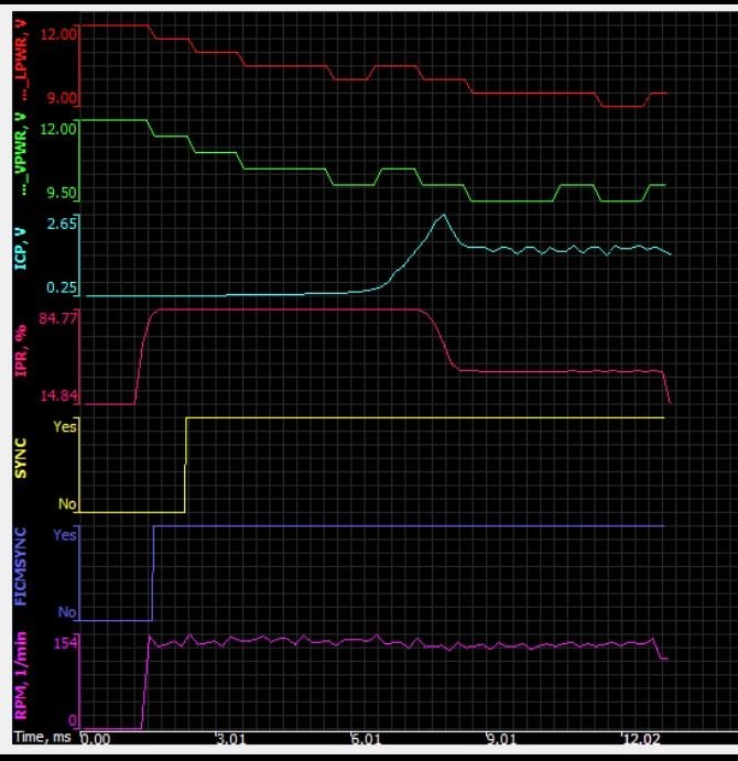

Originally Posted by bismic
ForScan will show the PID for Cam/Crank SYNC. It will also show the actual cranking speed so you do not have to watch a fairly inaccurate dash gauge.
You also need to scan for codes with ForScan.
[img alt="I have added the Cam/Crank Sync which is the yellow graph, the purple one is the ficm sync which looks good and the engine revs are 154 revs but that’s without it trying to fire like it usually does.
Hope this helps as I’m at a loss with her!"]https://cimg0.ibsrv.net/gimg/www.ford-trucks.com-vbulletin/670x691/img_7948_42d9495e50647f7c8cb282b9732ebcfec2549383. jpeg[/img]
I have added the Cam/Crank Sync which is the yellow graph, the purple one is the ficm sync which looks good and the engine revs are 154 revs but that’s without it trying to fire like it usually does. Hope this helps as I’m at a loss with her!

Primary issues are:
  • cranking speed too low (it is dropping below 150)
  • system voltage too low (it is dropping below 9 volts)
Is the elapsed time actually in seconds (not ms)?
From the document you linked above (Oregon Fuel Injection), regarding needing 11.5 V to start:
If FICM M power is significantly below 45 volts and L and V power were above 11.5, suspect a FICM module concern. The voltage would have to be quite low to create no start, 35 volts or lower may create a no start condition. Buy 6.0 Powerstroke FICM and Related Parts

Are the chart parameters with or without the GPCM plugged in?
Primary issues are:
  • cranking speed too low (it is dropping below 9 volts)
  • system voltage too low (it is dropping below 150)
The elapsed time is in seconds not ms apologies
so is this the batteries not being strong enough or something different?
these were with the GPCM unplugged
Thanks

It is very likely that it is simply a battery issue, but you never now when something might be "dragging" the cranking rpms down.
