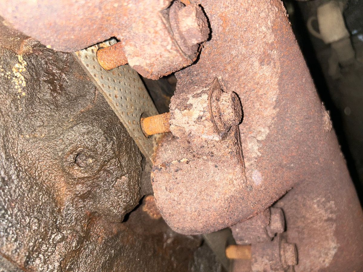

I'm in a little bit of a predicament. My 01 7.3 developed a bad exhaust leak on the passenger side. I took it to a nearby shop, and they said that a hole rusted through the passenger side cylinder head. Apparently, it was most likely caused by the AC condensation dripping onto it.
They want $4500 to put in a remanufactured head and a new exhaust manifold. I'm not entirely positive it's worth it to have it done; the truck has 290k miles and obviously has some rust on it and several other issues (engine shakes bad at 1500rpm, leaking pinion seal, engine leaks oil, hydroboost leak, the list goes on). I thought about fixing it myself but I'm not entirely confident in doing it. Anyone know if this is something that could be DIY'd? Would I be better off swapping in a different motor?

Rust Hole in a head from AC condenser dripping ? You got a picture, Video?

That's what they claimed. I'm not sure what all they did to find the leak, but they seem to be a fairly reputable shop.
This is the picture they gave me. Looks wet due to an oil leak.

It sure does look like a chunk of cast iron is missing. I can't see how it could possibly be from A/C condensate, but it is what it is, I guess. If the condition of the rest of the engine or truck is like that, it may not be worth putting any money into it.

I can't see how the condensate could cause a rust hole. Could you pressurize the coolant system and see if it actually leaks?
I don't normally condone this but would a high grade of JB weld possibly fix the coolant leak?
Depending on the size of the hole diameter leak, could it be tapped for a 1/16" NPT pipe plug or a fine threaded bolt?

Need to take some time and have a go at that head to clean it up. Cant really see what's going on w/ the head, and how bad it really is. Could just be threaded and plugged or possibly welded in, or it may be trash, all depends on how bad it's gone. Kinda surprised if it's that rusted that the manifold bolts look like they're in relatively decent shape.
Also not sure how the condenser could leak on them.

Mind blown on the rust level. Looks like head cannot seal to the manifold due to chunk blown off.
Time to take stock of the entire rig with rust the main lens.
Imo $4500 for new head and manifold is entirely reasonable.

That is a lot of rust! I work on boat engines in salt water environment and I don't think I have ever seen that much scale rust on a cylinder head. Is it that round depression above the exhaust bolt, center of picture? Do you have good access to it? can you tap around it lightly with a slag hammer and try to determine by the sound if there is enough metal around it to hold threads? I'm thinking perhaps a 1" pipe plug with red loctite and don't over tighten it? This will not be a permanent repair but you might get up to a year out of it while you shop around for another engine or another truck.

I would say that the level of rust deterioration is due to a couple of decades worth of road salt and not AC dripping. The AC outlet is positioned well below the level of the exhaust manifold and whatever drips gets blown back. Some hard decisions await your consideration on this one.

I hate to say it, Because I will tackle any job, But without seeing the rest of the truck I would consider scrapping it and picking up another older truck that hasn't see any salt. I live in high salt area, I won't buy anything used from up here, I will grab one from down south. Maybe its time for something a little newer and cleaner. That would be money more wisely spent in my opinion.
