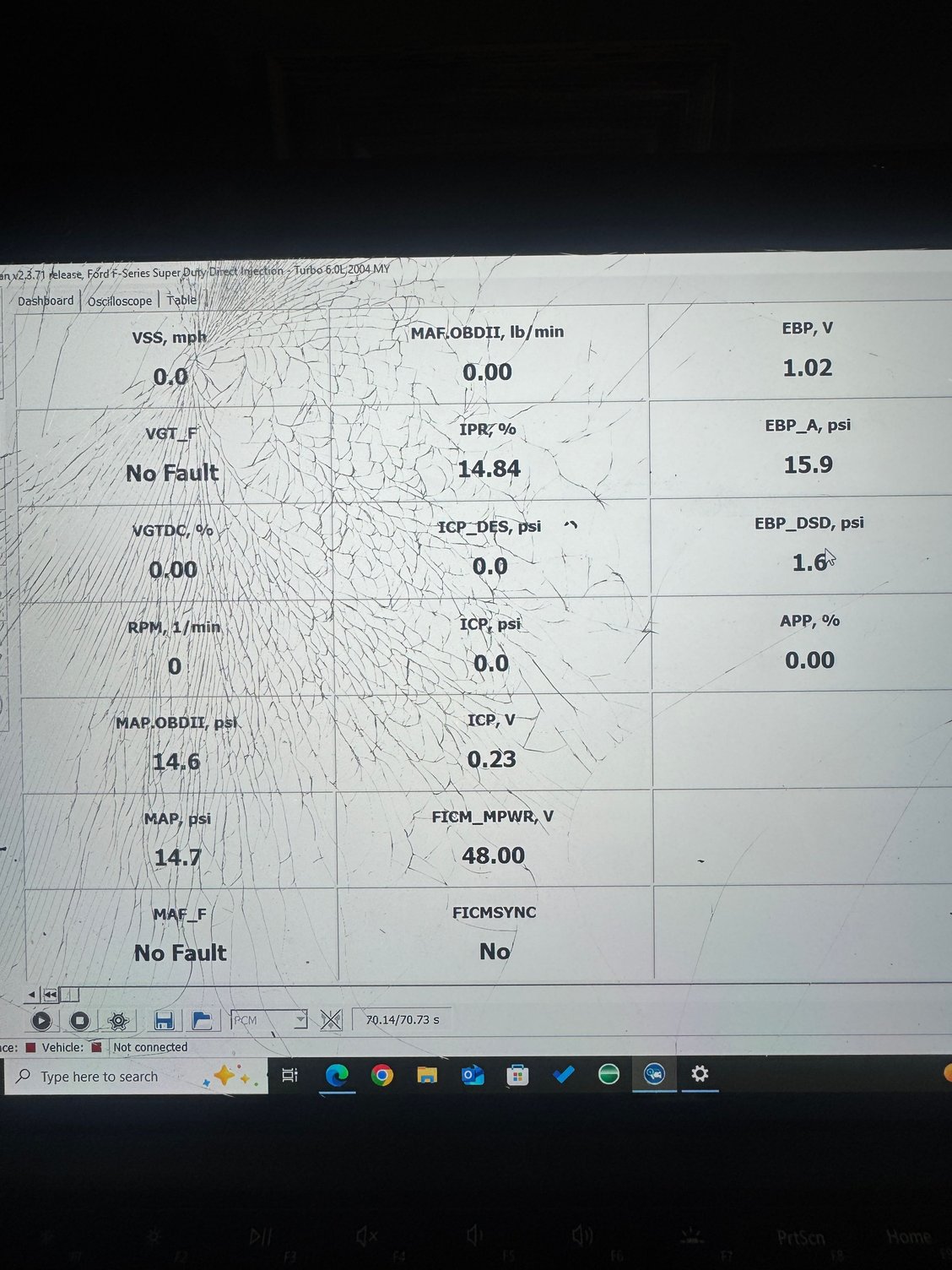

These are the graphs I had , the top red line is APP (pedal percentage) when it starts to peak is when I’m flooring it to mark time frame that it started to drop out on power

Ok sorry for the delay,Iv just been busy with work and family and my new job Iv been averaging 60 hours a week so I haven’t had time to look at the truck up until now . So I started data logging and saw something interesting . It’s been a compound of sensor failures and pigtails that had broke in half ,my map sensor would blip and drop to 8 psi which is not possible. It would be me driving at the top of mt Everest or a serious vacuum .
You can see that map drops and holds at 8.2 psi for several seconds causing massive defueling to occur hence why my truck wouldn’t move and get very quite , this was the only time I had my scanner on it and was able to catch it doing it this bad . This is what made it extremely difficult is that it would do this a lot but it would only do it for a fraction of second and this time it held the malfunction for about 5 seconds and again this was intermittent

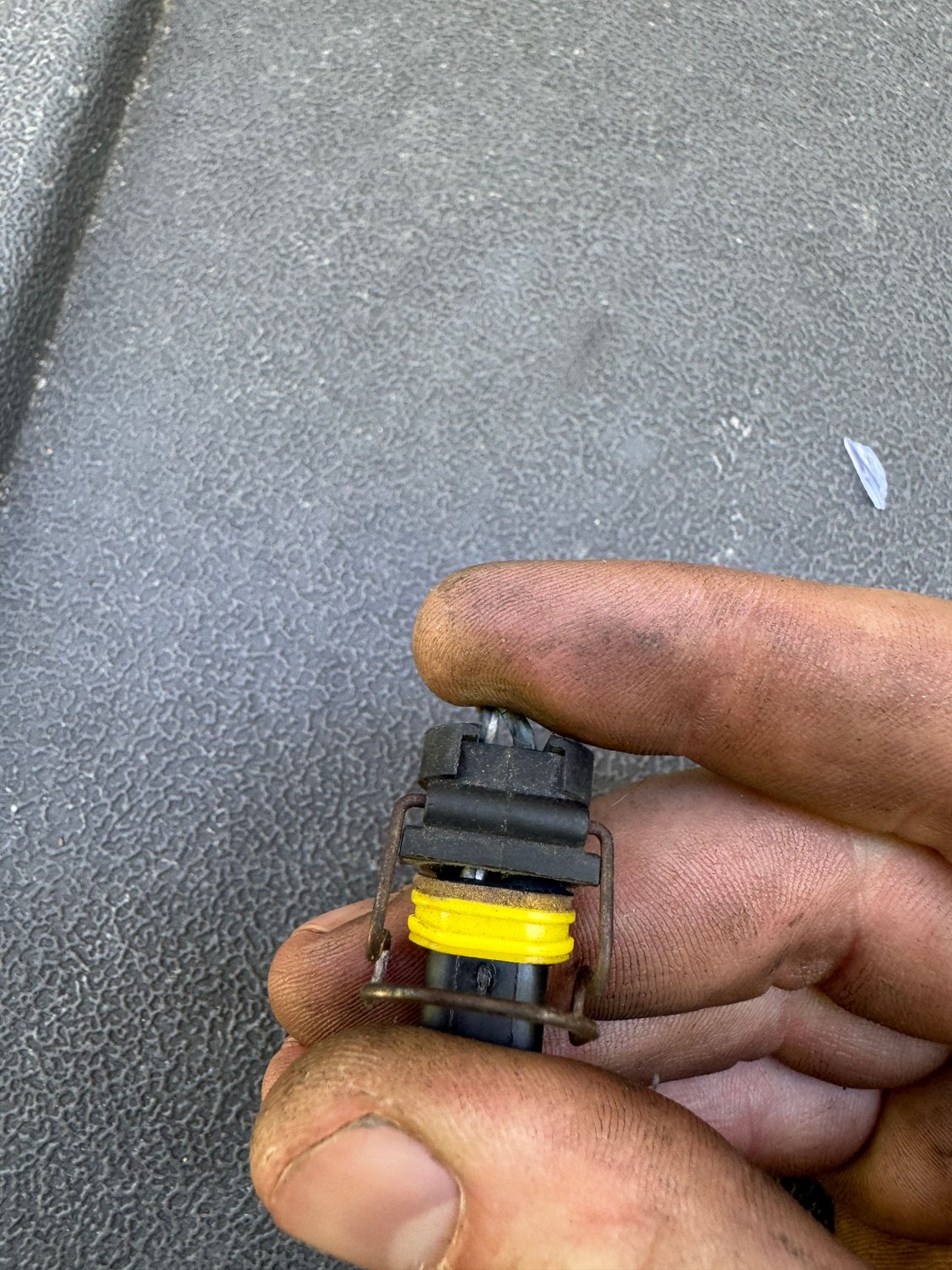

After driving it on highway shortly after map and icp sensor the truck was still surging on the highway generally around 65-75 mph but this was turbo surging you could hear the turbo duty cycle  hunting very briefly as soon as it came it would go away . This is the pigtail that broke in half the vane solenoid, replaced as well
