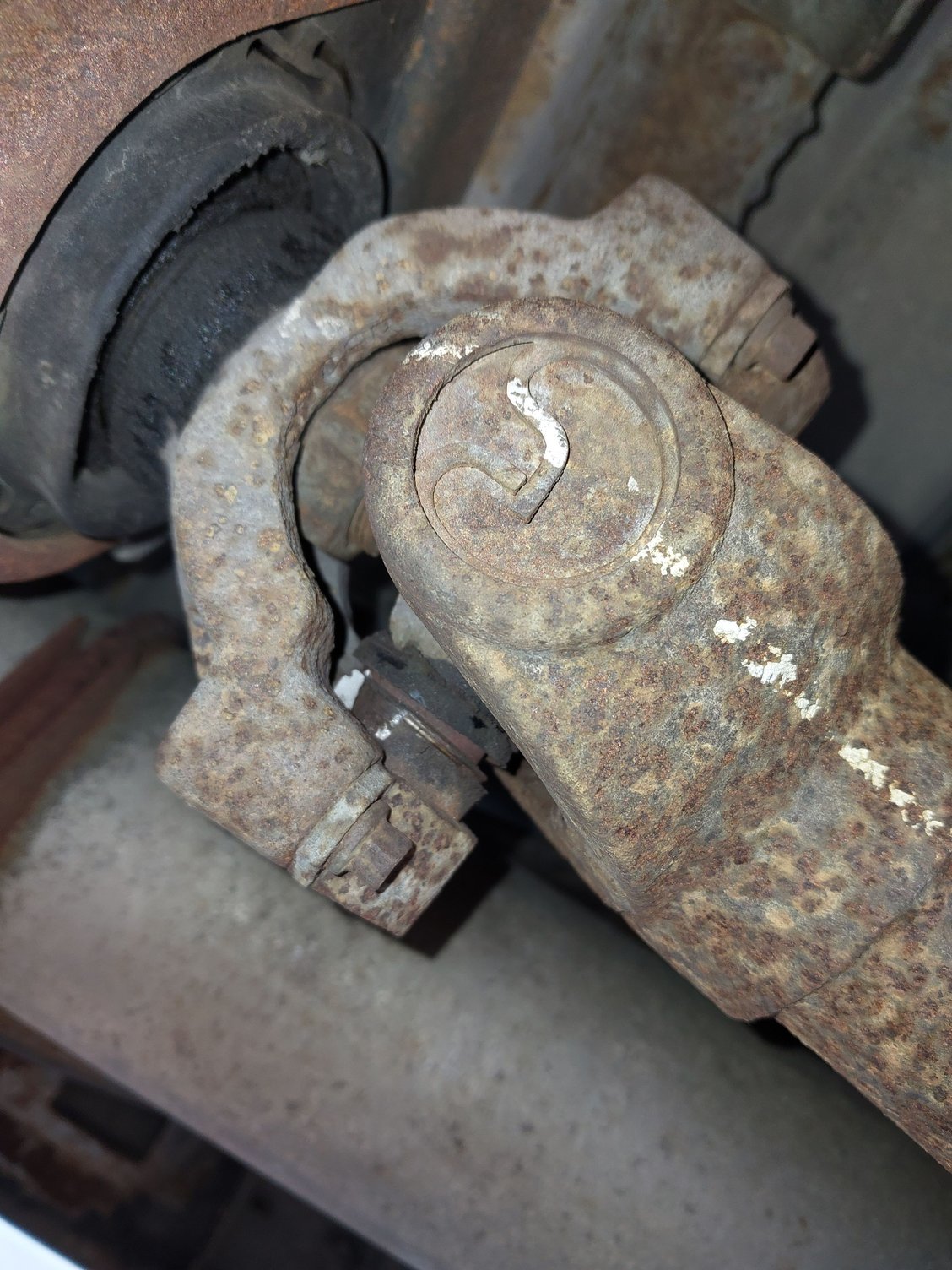

I'm posting this because I have searched the net trying to get a resolved thread on the subject. This issue had me thinking I could have an injector problems.
Hopefully I've found my issue. The problem was a vibration throughout the truck at speeds above 30ish. Mostly in the steering. The vibration would ALMOST disappear when I let off the throttle. It seemed to start at around 30mph and was worse at a cruising speed. Vibration would speed up with the rpms.

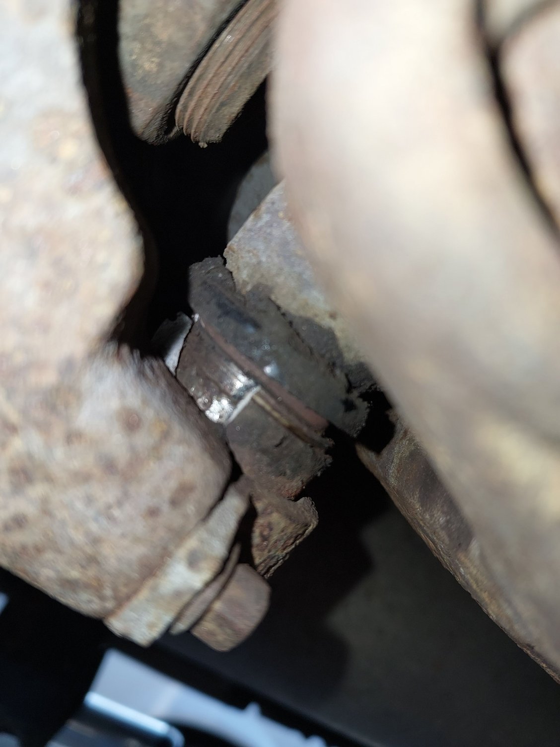

Today I got under the truck to remove the drive shaft so I could mark it of the list and found that a cup was busted on a unjoint. Still hoping this is the root of the problem. Definitely a good candidate.

I'd bet the farm on that being the culprit.

Yep! I would replace them all, as well as really check your carrier bearing.
Do yourself a favor and install serviceable u-joints.
Some say sealed are stronger but I have read different and the ability to lube the u-joint (and based on your rust) is longevity for your driveline. IMO

On the rear section of the drive shaft I had the local machine shop balance and install new joints. Wow! I should have taken care of this along time ago.
I've always had this "stutter" on take off. Just a short vibration. It's gone. The u joints must have been bad for years. The ol' truck now rides like papaws 79 Lincoln.
Sum of the thread, first sign was a short stutter on take off with come and go vibrations at interstate speeds. Took a near complete failure of a drive shaft u joint to cause a rumble strip feel from 30ish mph on up. The vibration would speed up with rmps and would go away when I let off the throttle.
New u joints and a balance of the rear section of the drive shaft fixed this problem. Hope this helps someone.

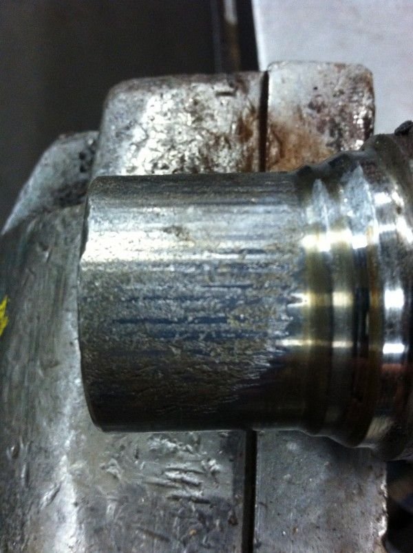

Wear troughs can develop on the trunnions, which don't necessarily show up when you wiggle a driveshaft by hand to look for excessive wear. That can be more noticeable at lower rpms. I still have my OE u-joints on my truck of over 200k, but I'm sure those are worn like this picture.
