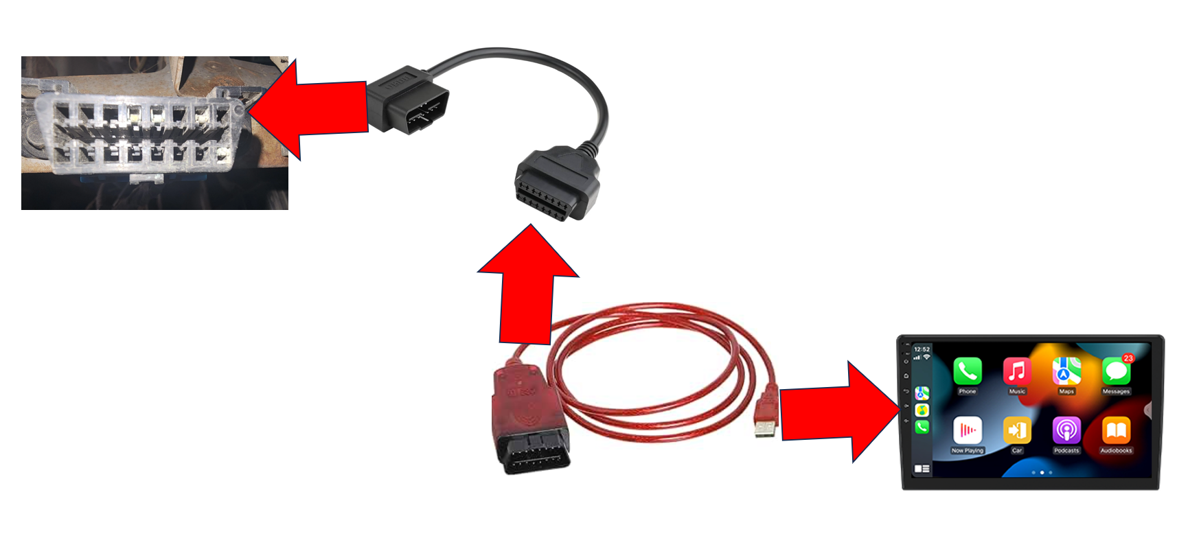

Sous , does the OBD adapter plug directly into the back of the head unit from the dongle? Sorry I'm a little confused, I called crutchfield to see what kind of head units they recommended and they told me that none of their head units are capable of reading anything from the OBD2 port which I was pretty surprised by
Originally Posted by jstihl
Thank you for the explanation, that makes sense. So with a Android head unit I can run a USB cable from the dongle to the back of the head unit correct? But I may need a special USB adapter in order to actually connect to the head unit? As far as forscan goes, would I need to download forscan lite on the head unit itself or would it be mirrored off of my phone? Sorry for all of the questions, I am electronically challenged
I'll piggyback off what Mark wrote and maybe having two different points of view will help a bit.
The 90° adapter is simply a QoL thing that allows the OBDLink EX or SX to connect to the OBDII port and not stick out toward the seat a few inches. I think it was SSJ who had a problem with the OBDLink getting too hot since the lower heater duct is right there next to the OBDII port.
I have created an illustration that may help you visualize what we are talking about.
So, the order of flow goes OBDII port on truck > OBDII 90° adapter > OBDLink EX/SX > USB to back of Android head unit.
The advice Crutchfield gave you may or may not be accurate, but it was certainly the easy way out of talking to you on the phone. Not saying they don't want to go the extra mile to win your business, but my experience with Crutchfield has not been great since the 90's or early 00's. Simply put, your Android head unit will work just like a tablet or phone running Android. You download Android Lite onto the Android head unit via a WiFi connection from your phone or house. The OBDLink EX/SX is plugged into the back in a USB data port, not a "charging only" port and you adjust the settings in FORScan Lite as needed. I had to make a couple of small changes, but nothing major and I was up and running. I can refer back to my Android head unit thread to find those changes to the settings in FORScan Lite if you need them.
We would rather you ask questions now and know what you are purchasing instead of having to deal with returning something or having hardware that does not satisfy your requirements.

/\ This. Without the 90* cable, I'd be kicking the OBDLink all the time. They are kinda big.
Thank you sous, I appreciate the explanation. I will have to find a head unit first and then I can see if I need any special USB connections. Thank you guys for all of the links, makes things much easier.
