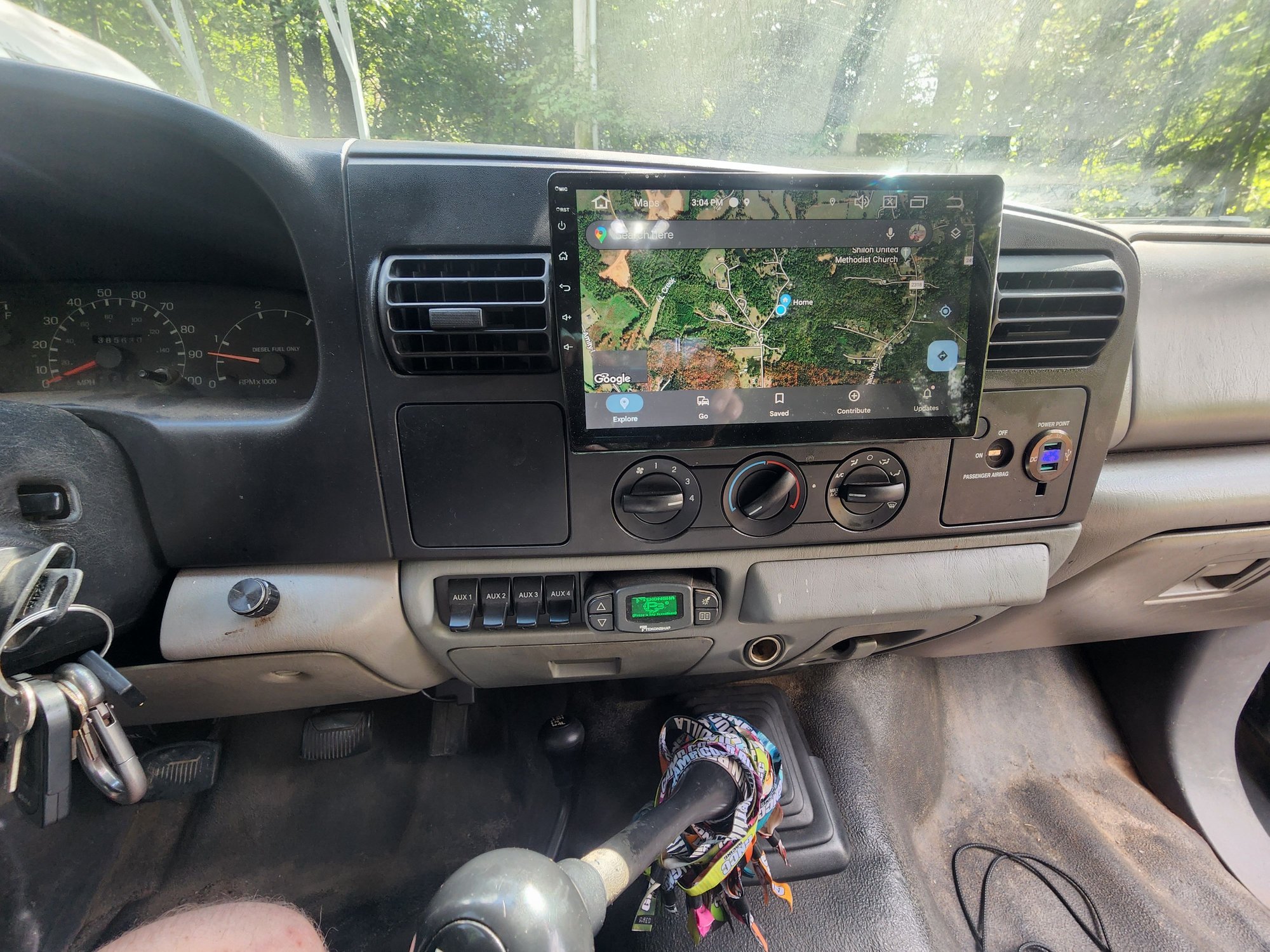

It's not to bulky IMO. I like it. Makes using Google maps very nice. Also has Netflix YouTube apps and everything on it. So can even watching movies on it. You do have the get custom mounting it but it's nothing hard. I've had it mounted in a couple different dash panels now over the years. Here is a Pic in stock dash. (I have a 08 dash in mine now). Any other questions just ask away.
Installed in 99-04 dash bezel
Installed in 05-07 dash bezel

Thank you, that is definitely nice but a little too big for my liking. I'll have to see if they have a 7-in version that has all the power that the 10-in version has. I briefly went to their website and looks like they have quite a few different models so I'll have to sort through them.

On the original dash it looks like its just clearing the vents, but is it blocking the a/c controls?

It blocked view of them slightly at the top. But doesn't block use. They stil turn to all positions just fine.

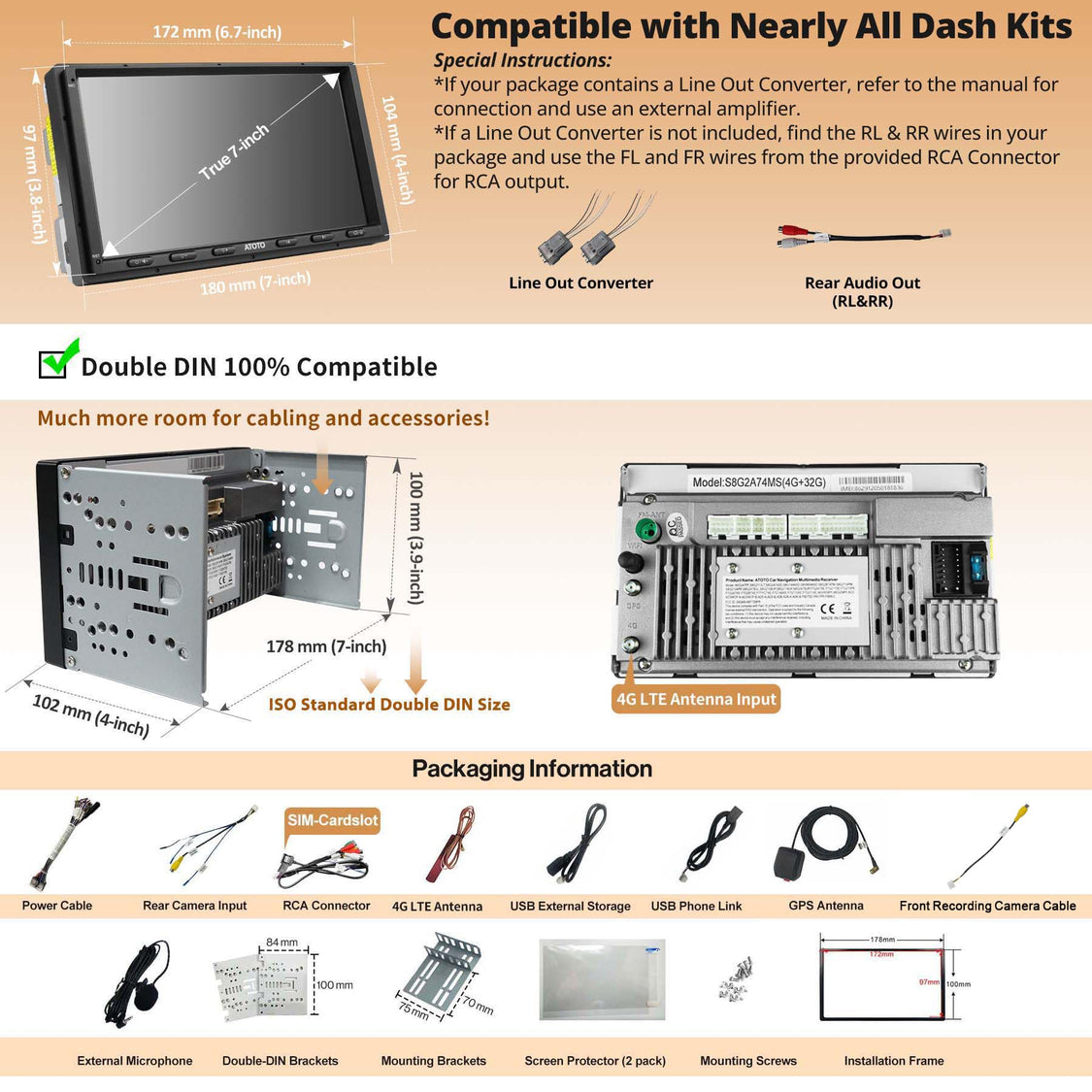

To the truck's OBD port, you connect a 90* OBD cable, like this:
Amazon.com: iKKEGOL 3ft 100cm OBD-II OBD2 Right Angle 16 Pin Auto Car Male to Female Extension Cable Diagnostic Extender Cord Adapter : Automotive Amazon.com: iKKEGOL 3ft 100cm OBD-II OBD2 Right Angle 16 Pin Auto Car Male to Female Extension Cable Diagnostic Extender Cord Adapter : Automotive
It plugs into the OBD interface on an OBD/USB adapter, like this: OBDLink® EX - OBD2 Adapter For ELM327 & FORScan
The USB end of that adapter plugs into the radio's USB cable, or to the radio, itself, depending on which radio you have. Here's an example from ATOTO. You can see the two USB female interfaces on their cables at the top of the image. On my older model it's a Y-cable, but it looks like the newer ones use separate cables for each USB interface. That's a better idea, IMHO.
https://www.atotodirect.com/cdn/shop...308&width=1125
The only way I've run Forscan is natively on the radio. I doubt it works under Android Auto, but someone else may know more.
