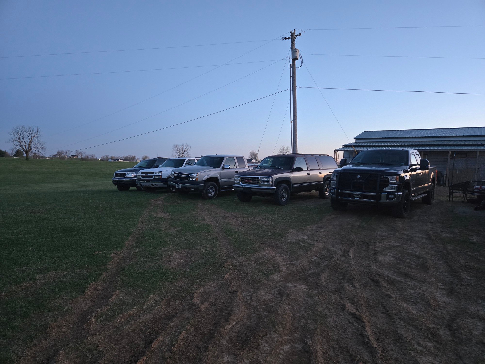

New Motorcraft AGM batteries went dead twice
I was sick of the corrosion coming from the tops of my '22 F-350 6.7L batteries, so I gave them to a coworker with bad '19 SD batteries. The new AGM were installed by FORD hastily with all corrosion left intact. When I complained to the service writer, he agreed to take the installation charge off my bill. I would have to set an appointment two to three weeks later and pay for the cleanup. I'll do it myself thank you.
Six months later, it's winter '24-''25 and 13°F with the engine block heater unplugged - oops. Truck didn't remote start and would not unlock with fob. I used the key and got in and could hear relays clicking. The dash was flickering. I put the key in the ignition and turned to start, there was a click and then all silence and dark. Batteries were dead. I drove it 52 miles home the previous day without issues.
I started my '97 Suburban and turned it around so that I could use it to start the FORD. It refused to start and was still acting weird. I let it charge for ten minutes and when I opened the door the alarm went off with only one weak horn tone. I turned the key on and then off to silence the alarm.
After another five minutes, I was having to shut down the Suburban due to it had a blown intake gasket, but I gave the FORD one last ditch effort. It started reluctantly and after removing jumper cables and shutting off the Suburban I put the FORD in reverse. It rolled a foot and then a big amber wrench 🔧 appeared. It would not rev up nor would it move.
I read all the codes with my code reader while the truck warmed up. There must have been thirty codes. I had a hunch this was all battery related and cleared the codes. Since then it happened again two days later when it was 17 degrees and since the first episode the trans shifts like absolute crap, so I need to preform a trans relearn.
Well, since we're in a proxy war with Russia, I can't get my Forscan lifetime license to work, zero support and can't pay for another, so I'm stuck and could not even program my TPMS much less anything else. Truck still shifts like crap even putting it into D is like getting hit by a bucket loader. At least the batteries have decided not to leave me stranded.
These FORD trucks are an electronic nightmare compared to old trucks. Hands down! It's now monsoon season in KY which will change back to summer then winter freeze all in the same week. I blame climate change on Mother Nature being addicted to crack! I'm driving my older trucks more and more with an appreciation. I guess I'll start with the battery terminals and then by the spare tire connector. What a witch hunt for corrosion!

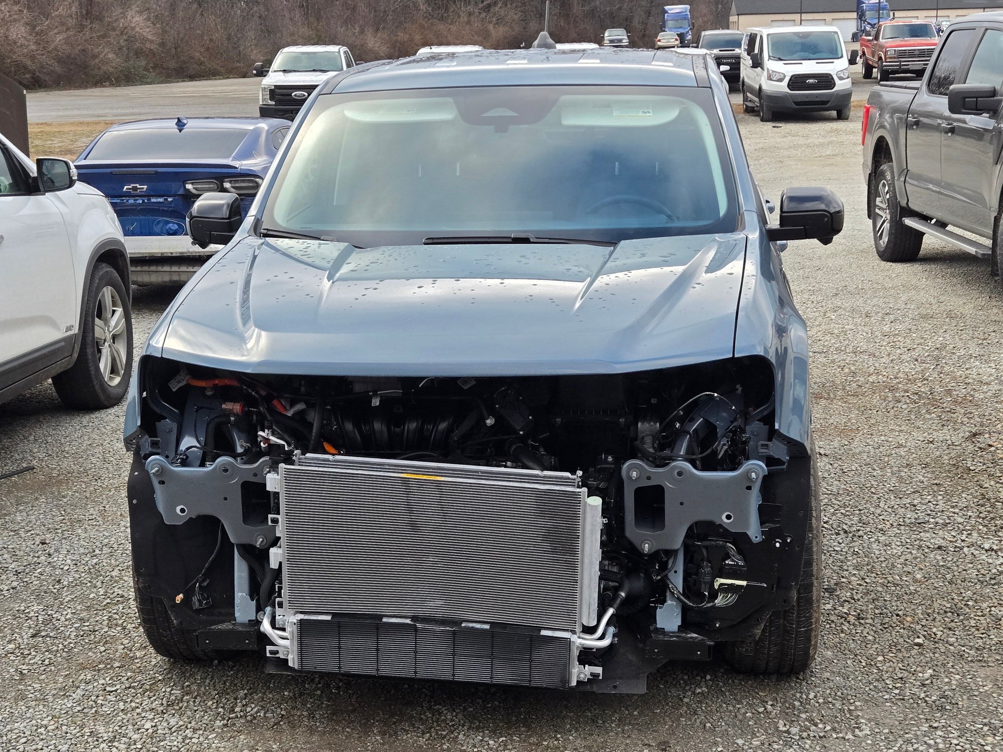

I already lost a battle with the '25 Maverick's nearly self driving AI when my oily work boot slipped. I got to drive it for only three days and have to wait for three months plus for parts.
I'm told they can't repair one parking sensor connector and I am waiting on the entire front electrical harness assembly. I guess techs nowadays can only unlpug connectors and don't know how to repair a broken wire and re-pin a connector for a parking sensor. Pitiful.
