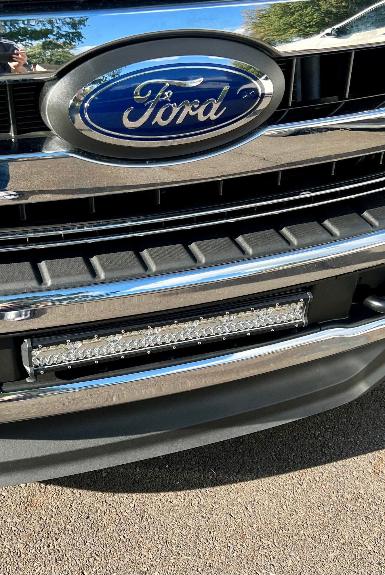

My truck is a 2022 F250 STX 7.3, with none of the adaptive cruise control sensors or cameras. I’m a cheapskate so I went with this 20” light bar from Amazon wired to 2 separate upfitters through a diode, with 1 of the upfitters also triggered by a relay from the high beam switch.
The light bar mounted in the front license plate/winch mounting area with no drilling as long as you hang the light from the top as opposed to putting the mounting brackets on the bottom of the light bar. Pop out 2 trim plugs from the top of that area to run the mounting bolts through. No grille or trim removal needed but I had to squeeze my hands in from underneath the truck to mount it and a flex head ratchet helped.
It’s worked perfectly and I’ve had no issues in about 6 months since I installed it. My state also doesn’t require a front license plate so not an issue for me but I believe I’ve seen license plate relocation brackets.

I’m definitely no electrician but I have the light bar wired to upfitters 3 and 5, with 5 set to always hot so I can use it as a work light with the truck off.
Upfitter 5 wire goes to 1 of the diode inputs. Upfitter 3 wire goes to the power in on a relay. Trigger wire for the relay is tapped from the high beam wire going into the headlight bulb housing (I have halogen headlights, not sure if this works with LEDs.) Power out from the relay goes out to the other diode input. Diode output then goes to the hot wire for the light bar. Light bar and relay are then grounded to a chassis ground.
Doing this gives me the light bar as an aux high beam light (but only if upfitter 3 is switched on), or as a front work light that I can use with upfitter 5 regardless of whether the ignition is on.
If you do a similar setup make sure your diode is rated for enough current. I think I used Hy-Power brand diodes that were around $10-12 each but could handle a lot more amps than the light bar was pulling measured with a clamp meter.
I also have basically the same setup wired to 2x 6” LED bars in the back that I can use as additional reverse lights relayed to the reverse lights on upfitter 4, or as always-hot rear work lights on upfitter 6.

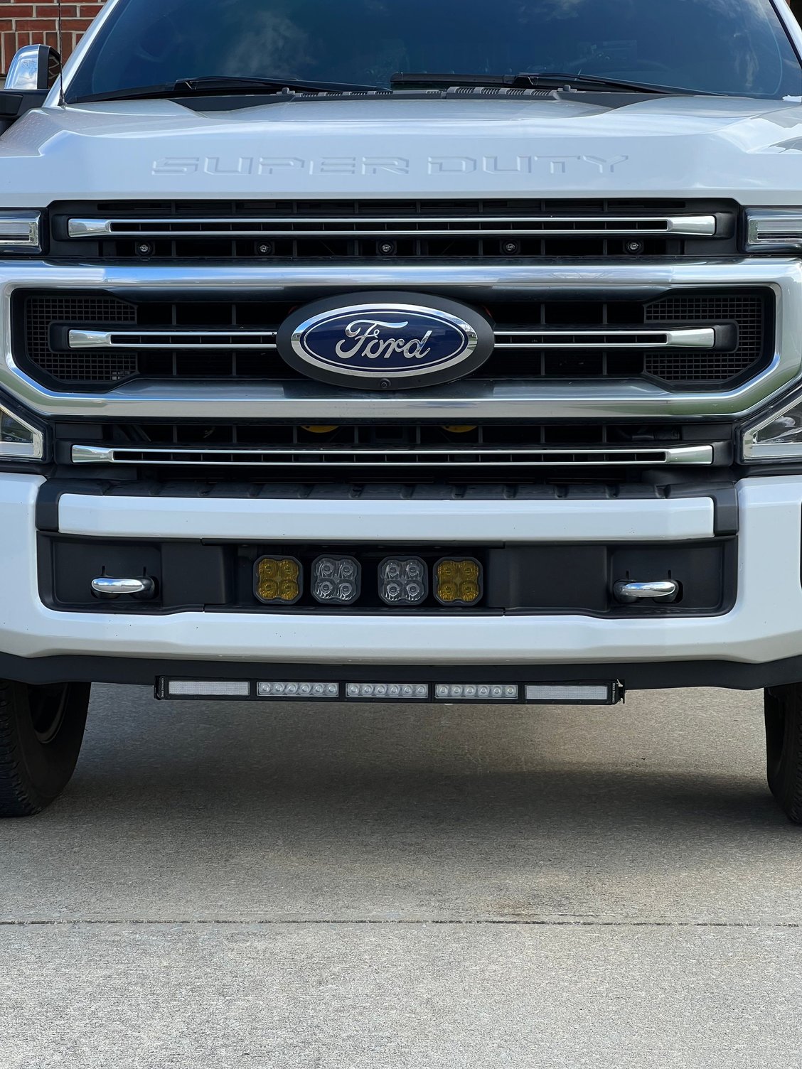

Baja designs has several options for bumper mounted lights. Fogs, a 7 light set up, a license plate bracket you can mount to. I'm sure other stuff. Best lights I've found.
