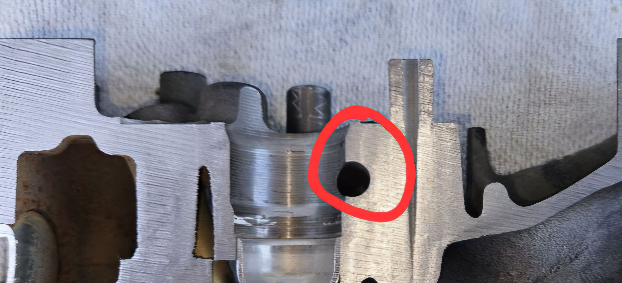

Interesting for me to see are the known weak points of the heads, especially the thin deck surface and partial constrictions in the intake ports.

Old Apr 13, 2025 | 07:56 PM
joe blow's Avatar
joe blow
Joined: May 2004
Posts: 3,610
Likes: 874
Awesome.
Hartwig on one of your pics can you highlight where the fuel travels through the head to feed the injector?
I have an idea but not too certain
Thank you
Old Apr 13, 2025 | 08:18 PM
Motohead911's Avatar
Motohead911
Joined: Aug 2018
Posts: 934
Likes: 248
From: CA
That is the fuel channel that runs from the front to the back of the head.
Old Apr 13, 2025 | 08:32 PM
joe blow's Avatar
joe blow
Joined: May 2004
Posts: 3,610
Likes: 874
Thank you
Old Apr 13, 2025 | 11:55 PM
Hartwig's Avatar
Hartwig
Joined: Oct 2018
Posts: 2,811
Likes: 1,908
From: unfortunately Germany
Exactly. A small side note: The bore is drilled from 2 sides. This results in an offset in some heads, which reduces the cross-section by almost half.
