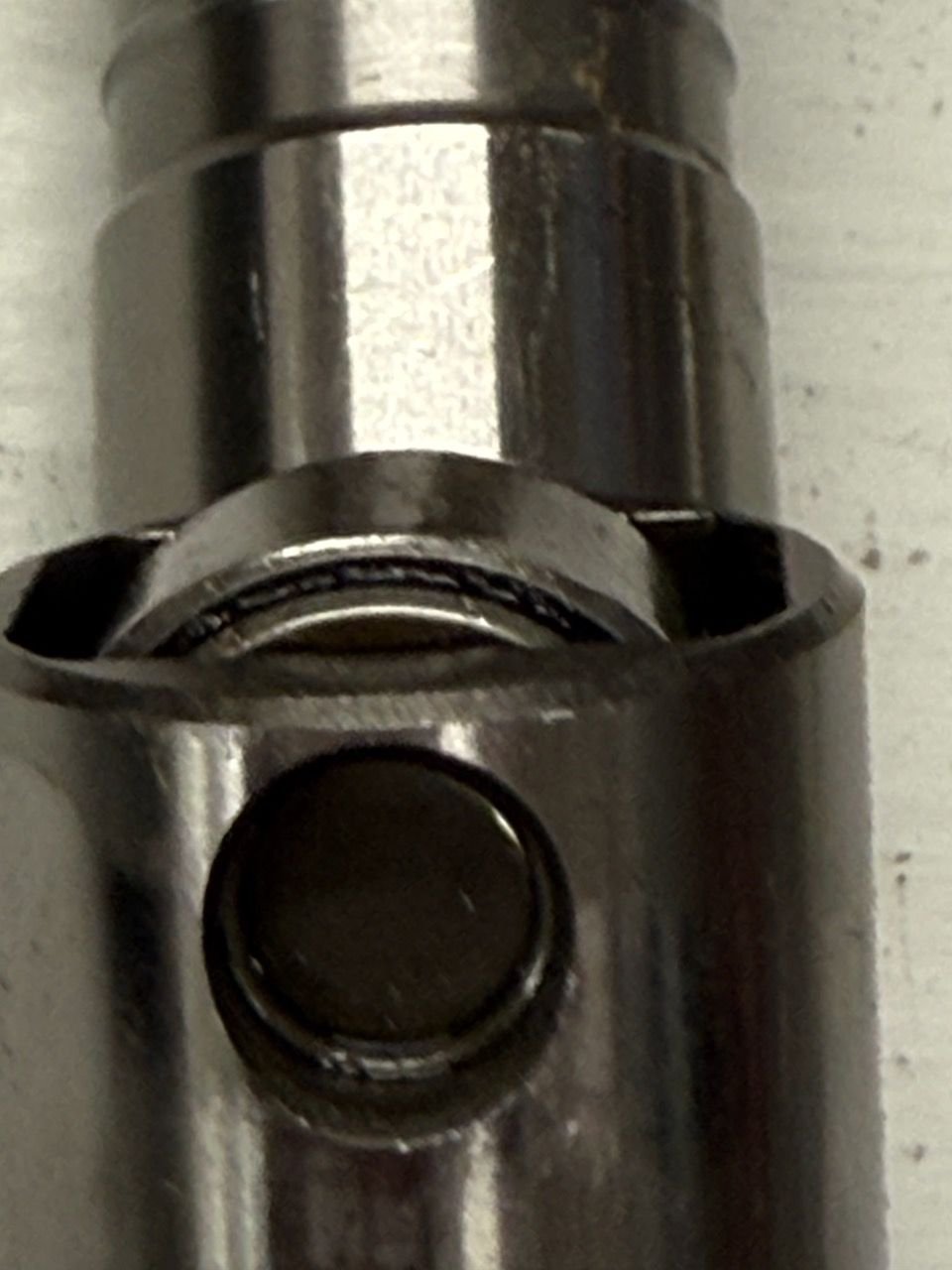

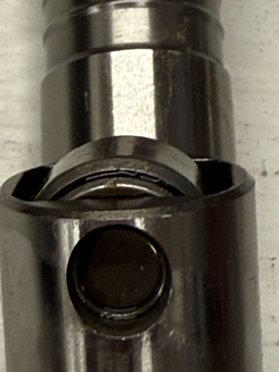

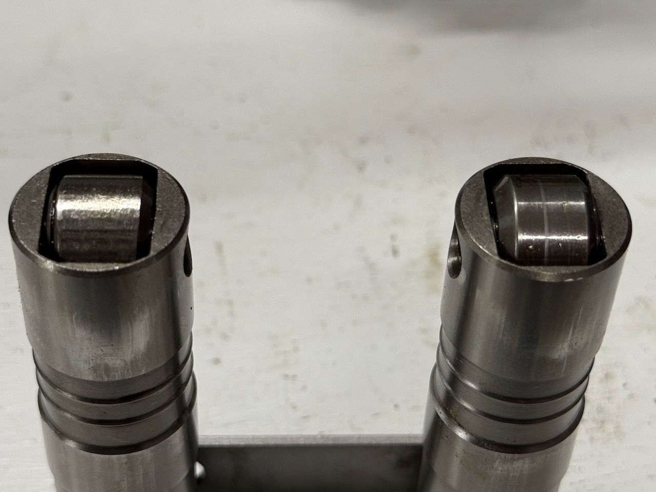

Thanks Dave. That is great to know. I will certainly keep the cam and one day get it repaired. Also, the lifters supplied with my new Howards cam are identical in appearance to the ones that came in my Lunati kit.
For fun, here are some images of the lifter.

A cam core like that one costs more than $350 now. Keep it for a regrind core for a future build or if you decide to try something different in your engine this will save you money and it will be every bit as good as starting with a new core.
As far as I know Howard sells Morel hydraulic roller lifters which are generally nice quality. I've used quite a few of them with no bearing failures but I have had a couple where the hydraulic mechanism messed up and collapsed. I don't understand what's going on right now with lifter failures but it sure seems like it is a bigger problem than it used to be with the roller bearings which should be trouble free for a long time in a typical hydraulic roller application.
