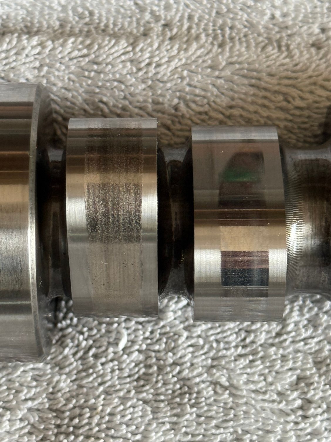

Got her tore down and cam is out. I was in error. It is the #5 intake. Roller on the lifter is toast. Lobe on the cam shows clear signs of the roller skipping over the surface.
Local machine shop says though they could clean up the lobe, they do not recommend it as it will remove the surface hardening and will fail sooner. Their recommendation is to replace the cam.
I ordered this... Howards Cams CL250705-10 - Howards Cams Retro-Fit Hydraulic Roller Camshaft and Lifter Kits. Should be delivered today.

Post a picture of the damaged lobe.

can catch the edge when dragging my finger nail across it.
I’ll post pictures of the roller when I get home.

Don't scrap that cam. That lobe can be fixed easily with absolutely no loss of durability. Cams are hardened before they are ground and an induction hardened core like that one is hardened almost to the barrel.
