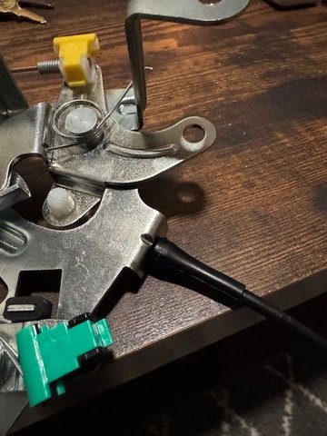

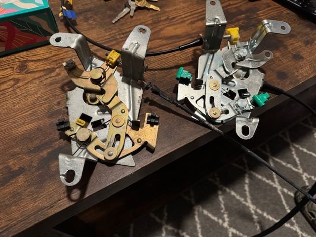

I snaked the new upper and lower cables/latches into position. Bolted the main latch assembly in place using the rivet holes. And began connecting the cables and rods. On the original main latch assembly I counted 3 rods all set in plastic cradles, the new unit has only 2. The "rod without a cradle" rides at the top of the same arm to which the lower cable is attached.
rod in the white clamp on top right
original assembly vs new. original is from left door. new assembly goes to right door (or likely returned)

Hoping pictures are indeed worth a 1000 words. FWIW I did try to salvage the original clip...just too much age and disintegration.
Any thoughts or experiences on this clip? Alternatives or ways to jerry-rig it? Did I buy the wrong part or seriously miss something?
