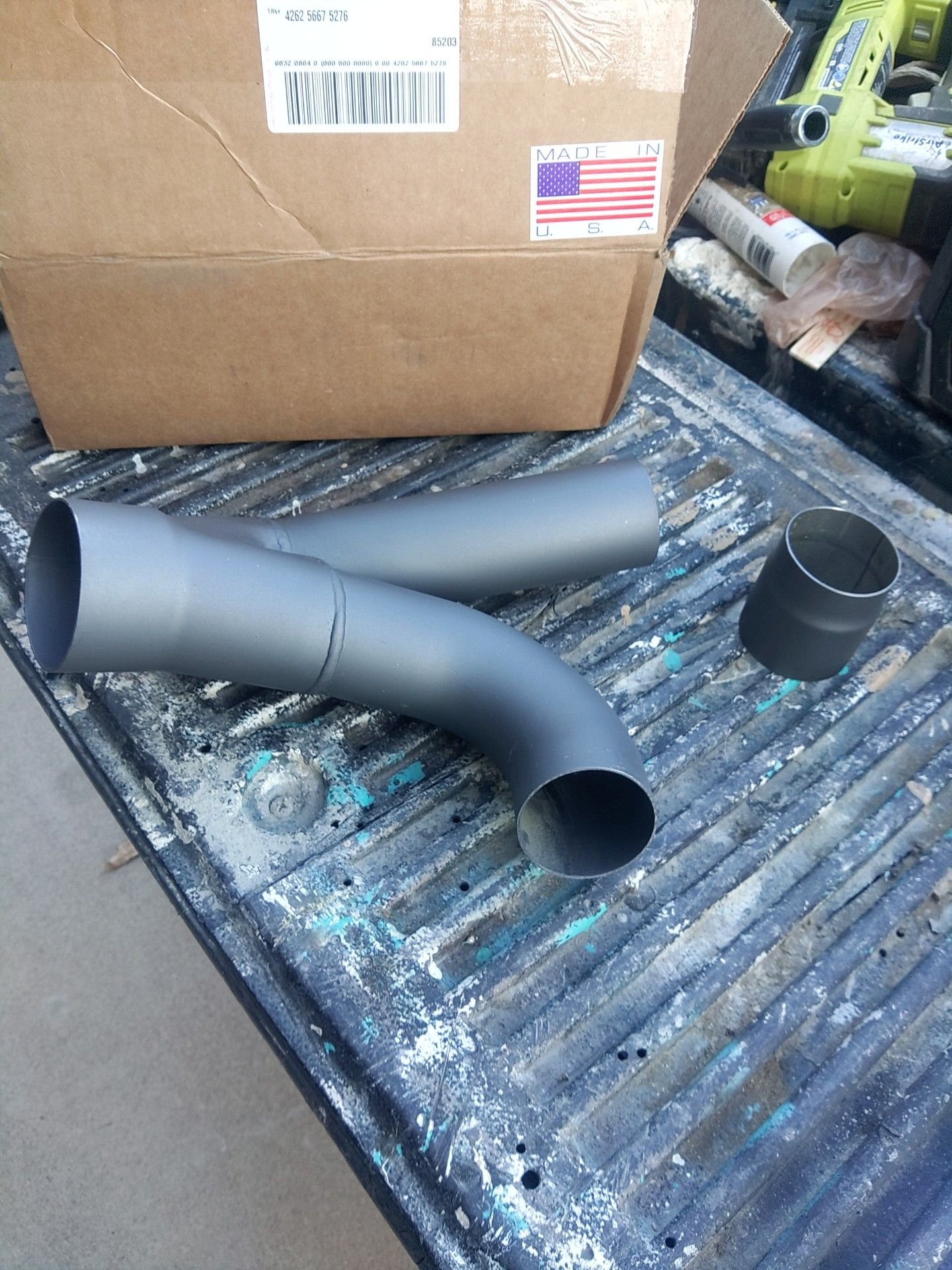

After a miserable experience trying to order Hedman headers I gave up and ordered a set of JBA and a SPD Y pipe. Both were in stock and at my house in 4 days! I started the disassembly Saturday morning and worked till around 4. I soaked every bolt the day before with PB blaster, I was able to impact the collector and Cat flange bolts with no problem. With the air cleaner assembly out of the way I worked on the driver's side. Every nut or stud came off easily. YAY The passenger side had to be more difficult. Remove the tire and fender well liner to get access, First nut I tried came off way to easy and sure enough the stud broke just below the head, Two other studs broke as well, one has about an inch showing. Fortunately they are accessible thru the fender so I can weld nuts on them. I had to do this before on my 02 so I'm feeling comfortable. Once I have the JBA's on I am going to retrofit the crappy Ford Y with the SPD Y.

It is on there and it's dramatic, it's just called 3V (for 3 Valve) The stock manifolds on the 3V are very header like and has no Y- (T) Pipe restriction the '00-'04 have.
