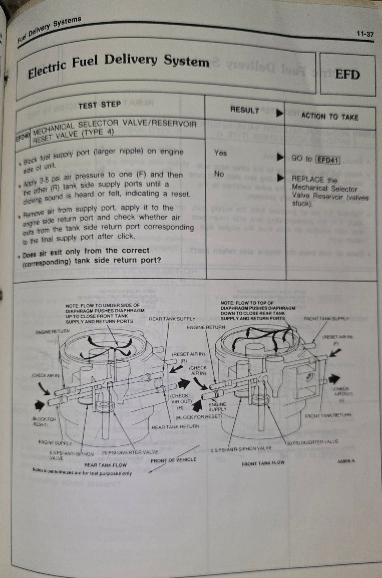

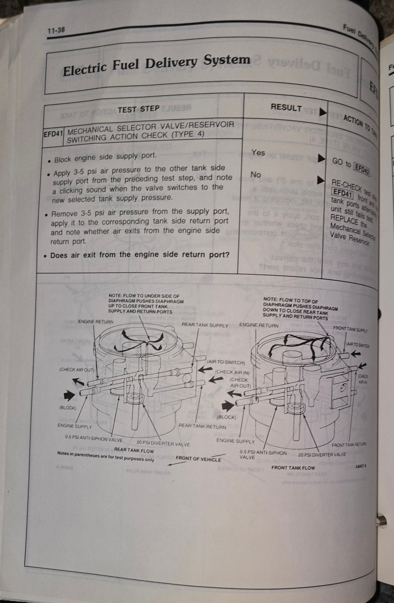

Better plan on some fuel system diagnostics too
That 3 pump system has trouble at times, starting with the crossover valve
These is for your reference later, and i also have a 1988 EVTM
