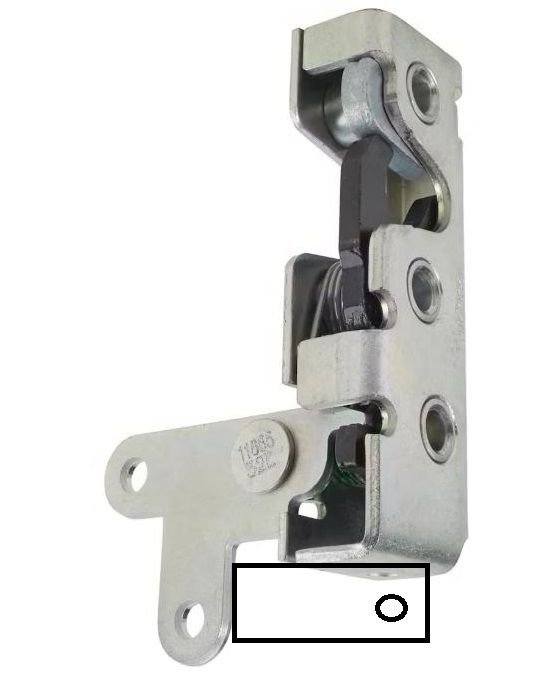

I did install solenoids on mine. I do not think I have any pictures but there was a issue with the only place to attach the solenoid rod or cable to the altman was on the wrong side of the latch to have the cable or rod to the solenoid pull from the bottom, I welded a small tab on the latch to correct that.
Even with a solenoid there is no way to lock the door from the inside.

I did not find pictures but I grabbed a picture of one online and drew in the part that I added to attach the solenoid rod or cable to to make it unlatch on a down pull. Altman puts what looks like a dandy place to attach a solenoid but it requires a up pull to unlock

So I bought the ones without the door lock attachment, that is evidently why I had no place to attach the solenoid
