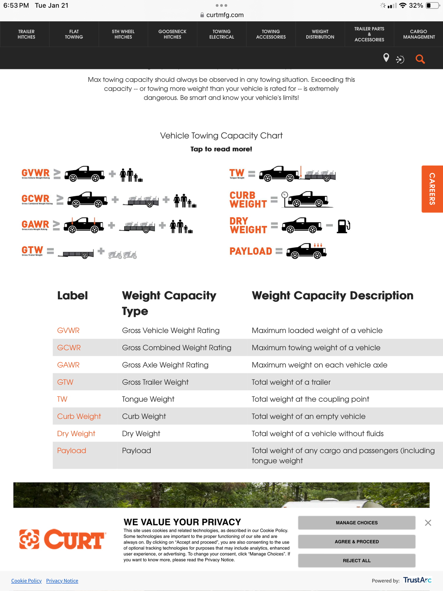

This doesn’t answer your question but it seems to address confusion many people have with the acronyms. I actually do not have any Curt products but like their explanation!
