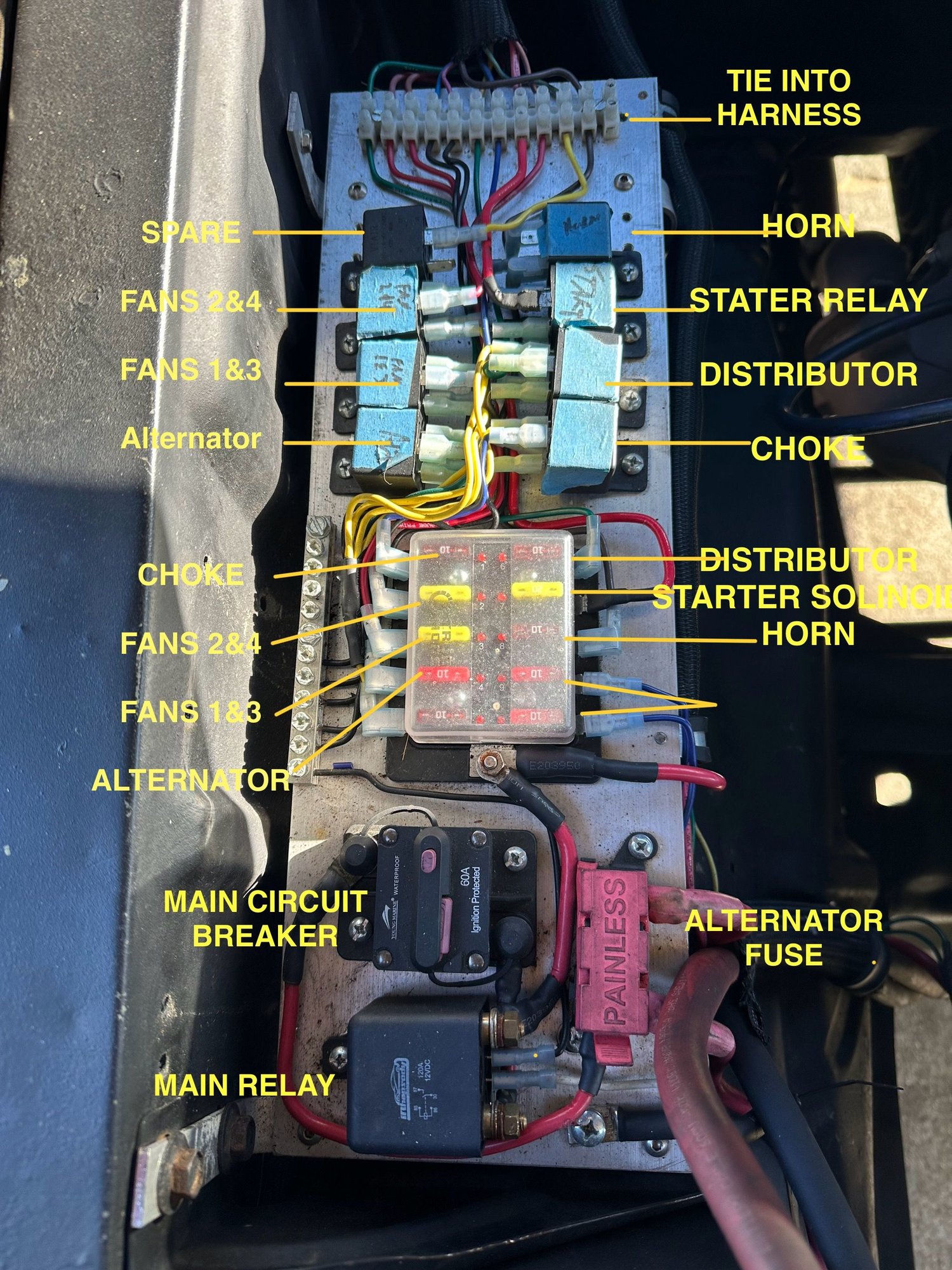

Originally Posted by 1TonBasecamp
Glad you found a problem. But where exactly is this fuse? In a '73, there should be no fuse on a starter circuit that I'm aware of.
Doesn't mean that they don't exist of course. Just that I've never seen or heard of one. Especially when our factory fuse boxes have only five or six fuses to begin with.
Or has the truck been re-wired at some point?
If you can, post up a picture of the fuse so we can check it out.
Thanks!
Paul
When I rebuilt my motor recently I cleaned up the old harnesses and redid some wiring. I’m an electrician by trade and all the wires that I had added and was adding looked horrible so I cleaned it up. Also with that said I put a lot of things on relays. And put the whole truck on a single relay and circuit breaker (which is nice if I ever drive into San Francisco I can trip the breaker and lock the hood and it’s somewhat secure). I added a pic and labeled it all for you. This is on the passenger side inner fender right behind the battery.

Ha ha! Yes, good to know. But great job on the rewire.
Looks good. I’m a big fan of relays and I’m glad modern cars use so many. But I’m even more glad that they’re as reliable in general as they are. With so many parts being a crapshoot these days, it’s nice to have ones that work.
Would love to see some more pics under the hood.
