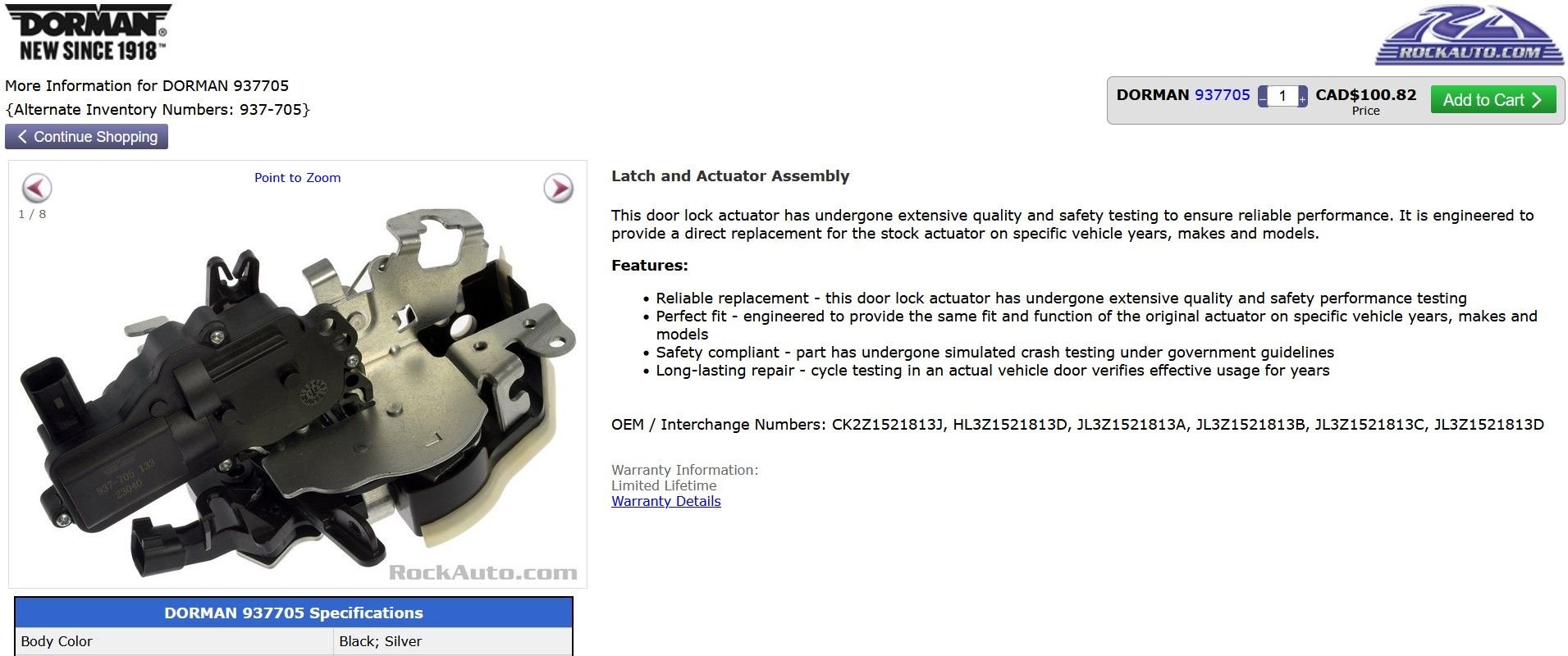

OK, it has gotten to the point I have to replace my driver door unit... can someone confirm if I need just the actuator:
or the whole actuator and assembly:
Thanks

Just the actuator most likely. When you replace it open it up and see if it is full of water and corrosion.
