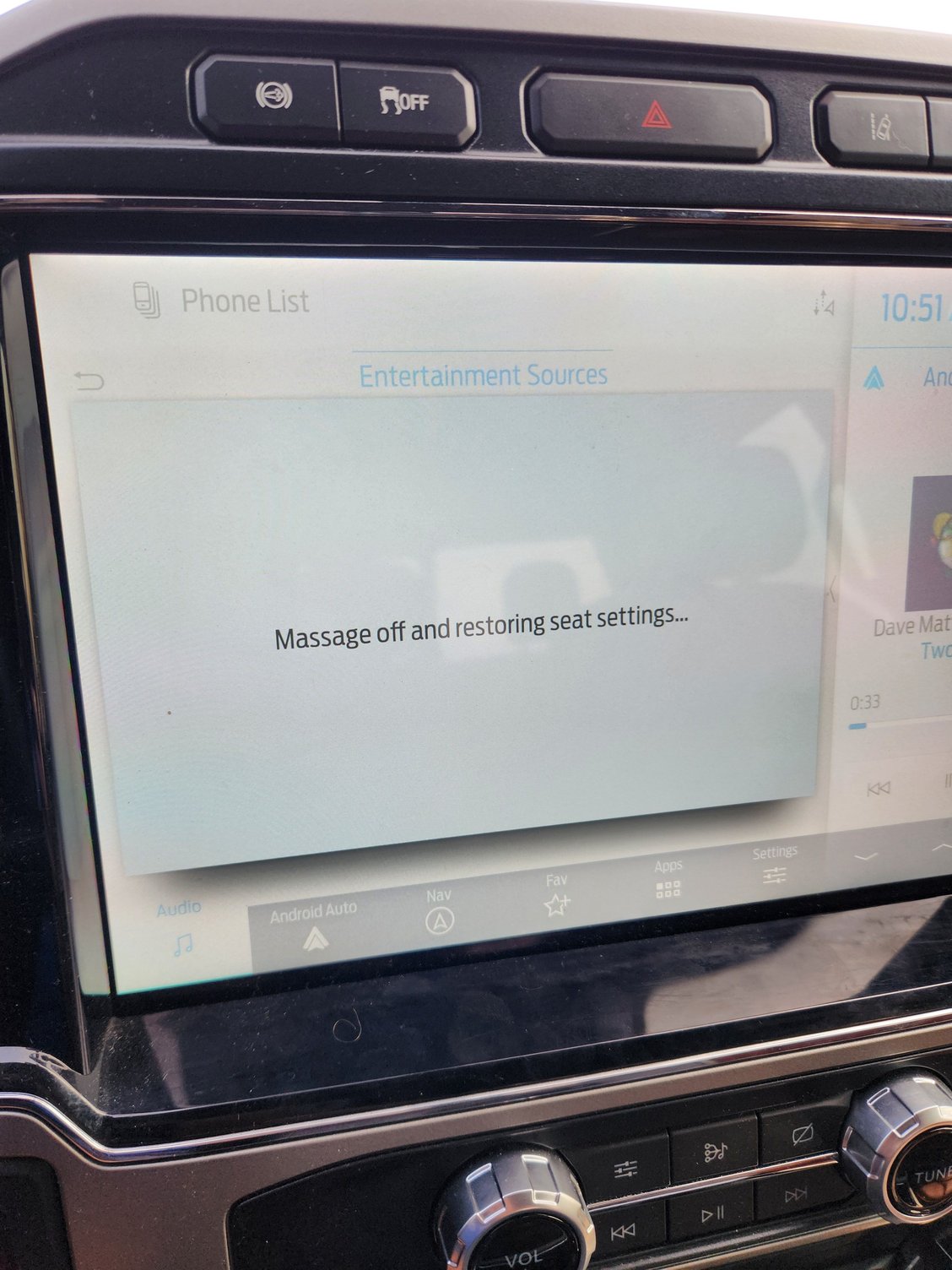

22 450 crew cab KR bone stock and the front passenger door won't lock. I noticed the kids trying to get in before I was there with the key was setting off the alarm. The door opens but the alarm would go off. I realized that it's because the door isn't locking. Door doesn't lock with fob, doesn't lock with lock/unlock button in truck and doesn't even lock when you try to physically push the post down. Has anyone ever experienced this and what could it be?
The only other oddity I observed lately is the return settings for the massage off and restoring seat settings screen keeps randomly popping up, no idea why...frustrating. I can't imagine these two things are related, just sharing what I'm experiencing.
