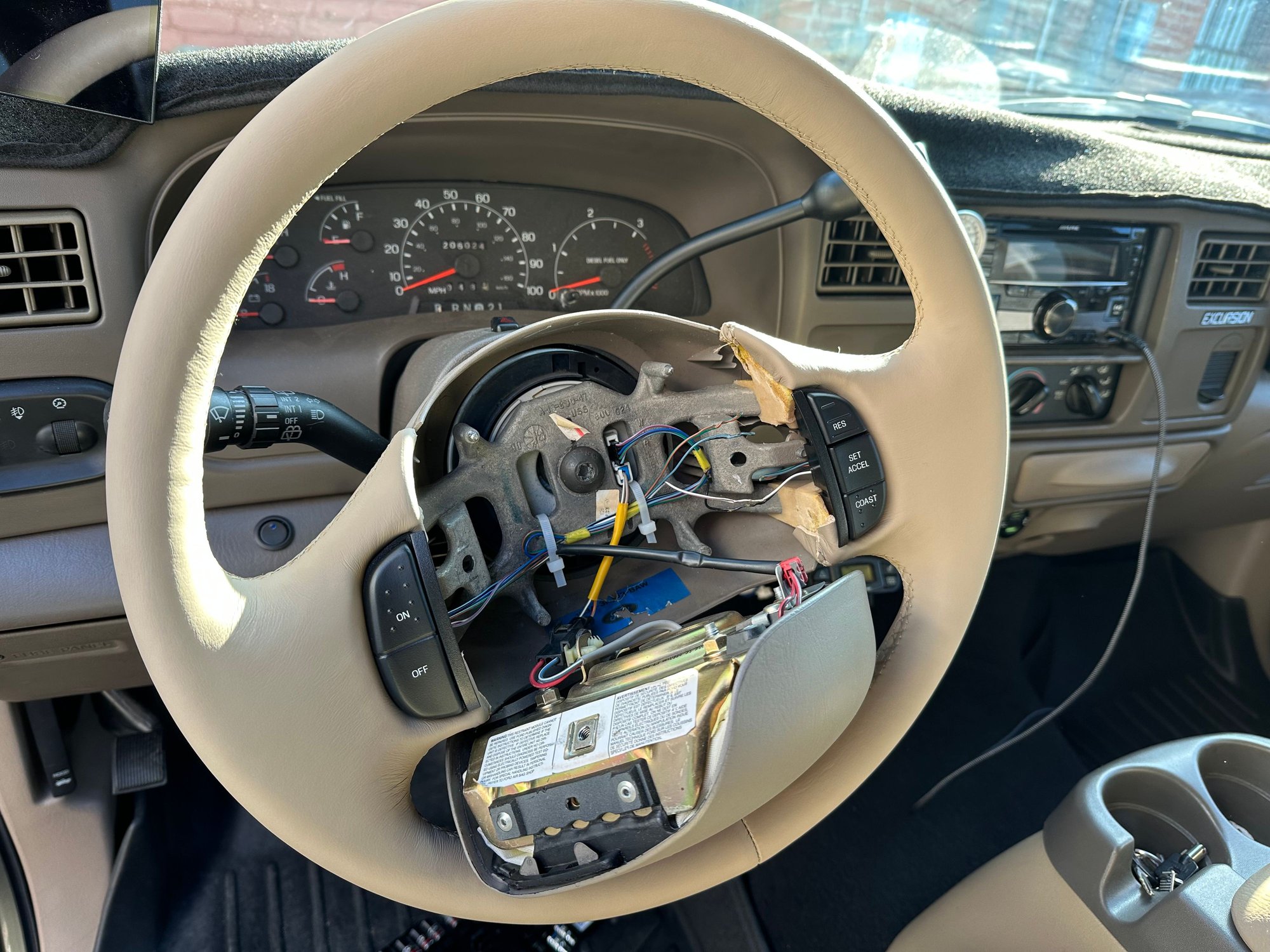

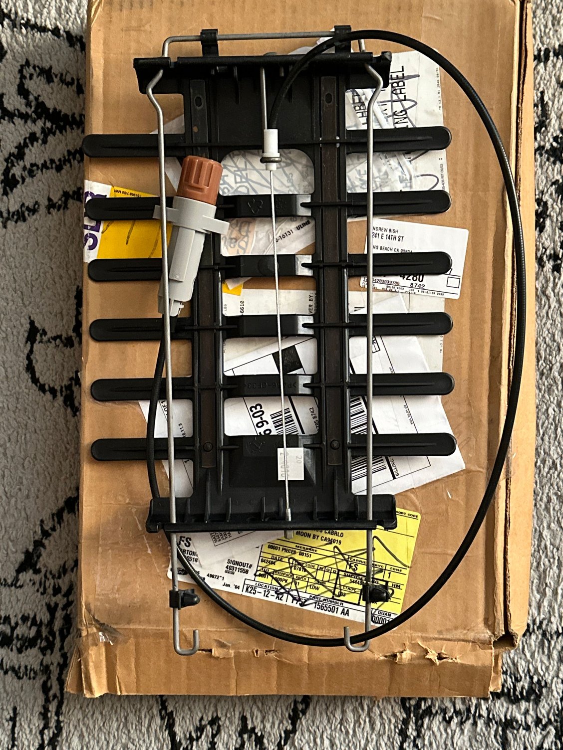

Picked the Ex up today from the upholstery shop. He added about an inch of foam to the seat bottom outer bolster area and about 1/2" to the seat back bolster. I trust the opinion of this guy and only wish his shop was closer. He explained a few things, first, my lumbar adjuster was broken and needed to be replaced. He tried fixing it but was only able to freeze it in one location. Second, the factory foam is SH&T! After only a year, it's broken down and lost its firmness. Added to the fact that it sits on the seat frame rail, it gets crushed from the narrow rail underneath. Additionally he said the leather seat cover bolster panels were too narrow causing the stitched seams to be too high so the cover doesn't fit the foam correctly on both the bottom and seat back. He did the best he could and it looks good but not correct.
Now my plan, to obtain a new lumbar adjuster, a new seat bottom cushion, probably the Durafoam from The Seat Shop, and instead of buying new seat covers, have the upholstery shop make new ones with premium leather. He said the leather he can get will be thicker and more durable. New seat covers from the source where my existing came from are about $500. Add installation and they come up to ~$900 per seat. He quoted me $950 per seat with him cutting and stitching the leather. Maybe he can use leather throughout instead of using vinyl around the sides of the bottom and the back of the seat back. Recovering both seats so they match will be necessary and installing the lumbar adjuster will require the same amount of work on the drivers side. Do you like how I've just justified spending another $2K on new front seats? lol
His work on my steering wheel is exquisite!
This evening I ordered a new lumbar adjuster. Although discontinued, there are a number of them still available around the country. Part number - 8C3Z-1565501-A
Now to see if the Durafoam is the way to go. Any opinions on this, is there anything better on the market? If I'm going to spend this much dough, I want it done right with the best materials so I don't have to do it again for a number of years....
Only one small detail that didn't go right as if the above isn't enough. I had new cruise control buttons to install. The left "On" button activates the horn and with head headlights on, only the On & Off buttons illuminate excessively bright. The right side "resume, coast, etc" are inactive. I called the shop and have to drive another 20 miles to have him look at it. The old switches worked before. It's impossible to wire them up wrong so something is going on. If we must, I'll have him put the old switches back in.

Went back to the upholstery shop and he got right on my cruise control switches. Apparently when he installed the airbag he crushed a couple wires by accident. He soldered them together, taped them for insulation and protection. Now it all works great. I drove after dark and the lettering glows nicely and my cruise control works as expected.

That steering wheel looks awesome!

I will have to just use the Ford seat foam that I purchased a year ago when I have my front seats done again. I just got a new lumbar adjuster to replace the broken one.
