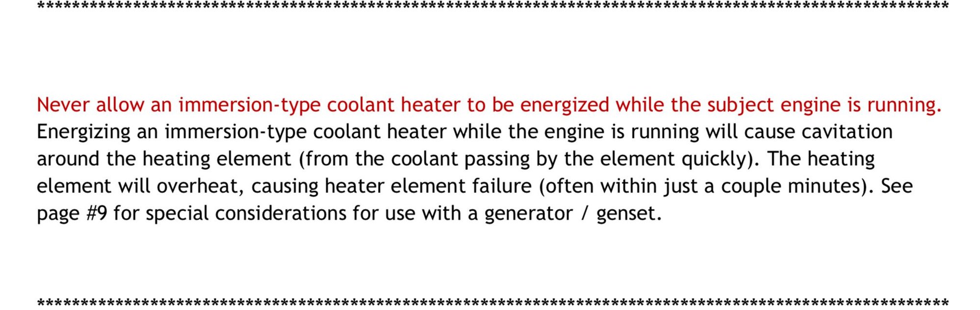

Ford manual says to unplug the block heater before starting the engine. Doesn’t say why.
A quick search results in multiple lay people saying it’s not required.
The manual for my block heater controller says to never run the engine with block heater on as it can ruin the heater.
Perhaps block heater failures are due to people not unplugging them before starting.
Definitely a bummer for those that want to start the truck remotely while plugged in.

It can cause cavitation which can burn out your heating element. Same warning comes on other trucks, tractors, etc.
