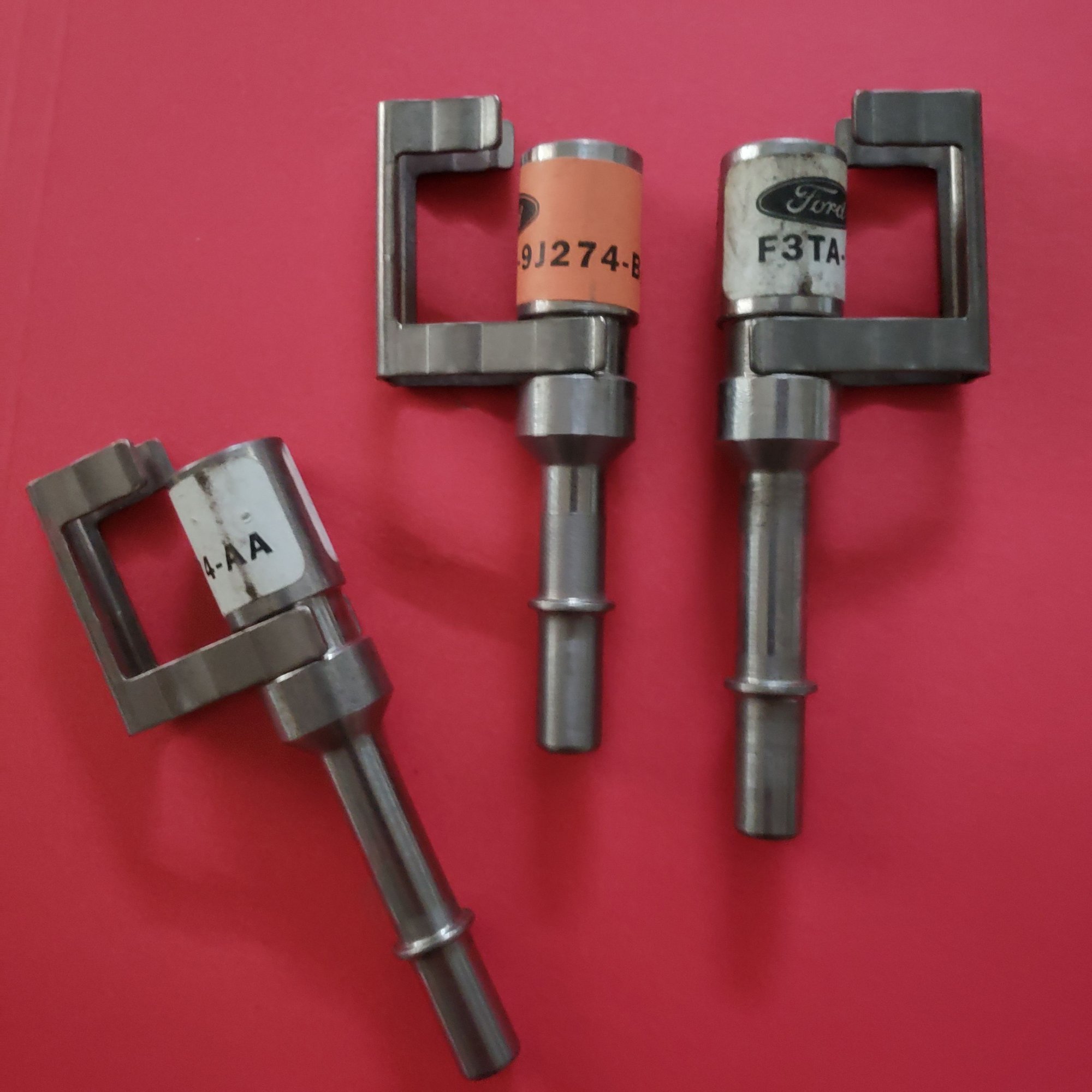

I still have a few of these
They are expensive but solve the issue of cheap pumps with no good one way valves
Find a 300 dollar Ford pump NOS online somewhere, is what I do on my personal vehicles
