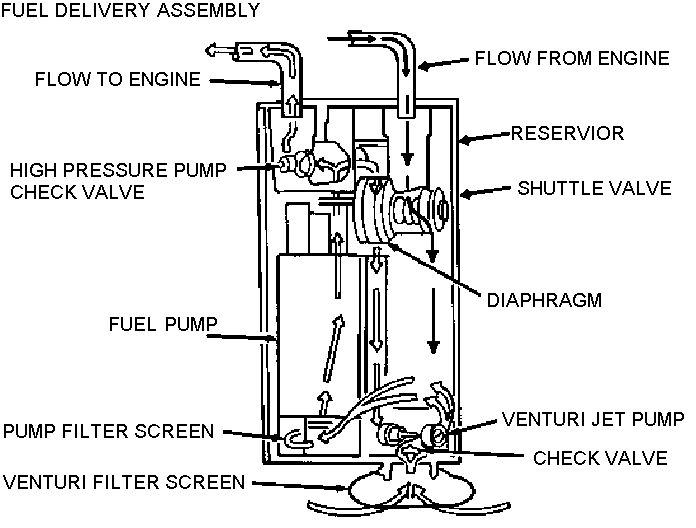

You have a bad valve in the rear module.
Never replace just the pump.
Always by at least the module if not the whole assemble (hanger, sender & module).
The Module.
Attachment 278661

[QUOTE=subford;20286565]You have a bad valve in the rear module.
The Module.
/[/QUOTE. So should I disconnect the wires from the rear pump since it is supposedly bad or should I Replace the auxiliary tank valve
