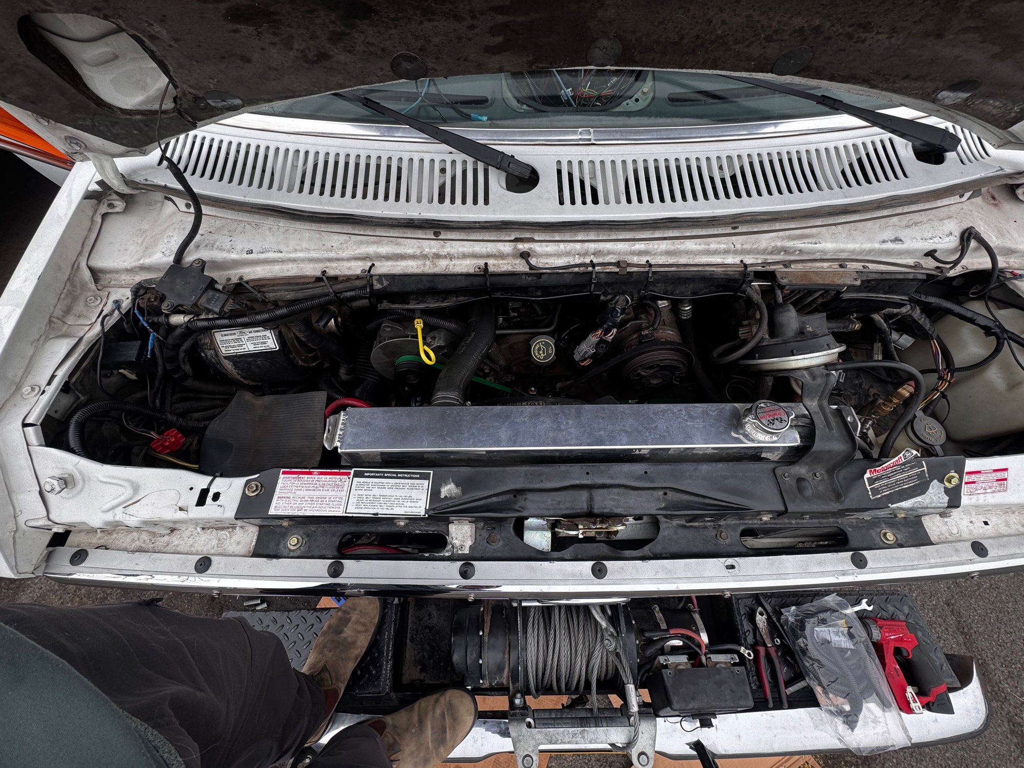

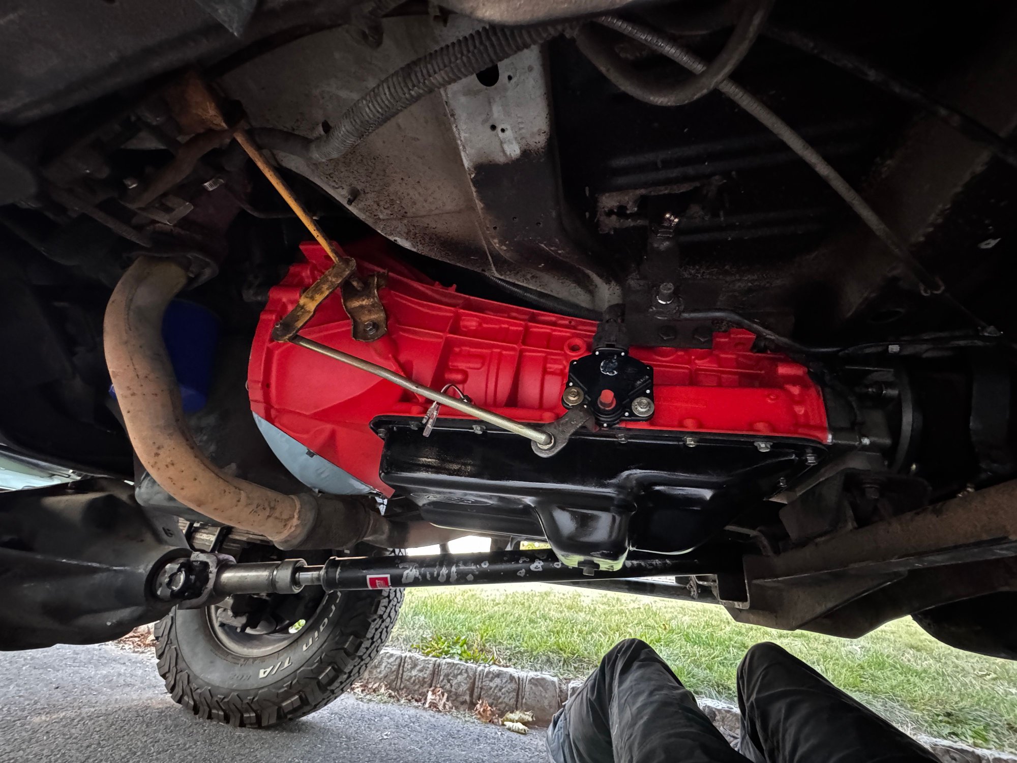

I don’t recall if it was said, but It was shifting beautifully for about a week after the trans was put in the vehicle.
@FORDF250HDXLT
Some photos of the trans as it’s in the van and the engine bay because you asked for that one

I don't recall that. That also points to bad wiring between TECA and solenoid pack connector. So it can also be said, verify or correct this statement:
"The transmission was shifting poorly. It got rebuild. Worked great for one week, then worked exactly the same way the trans originally worked before being rebuilt".
Be sure to answer questions in posts #57 and #58 above too.
