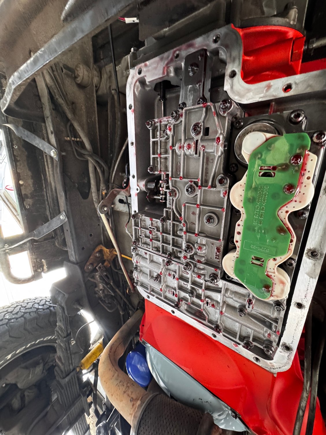

Frustrating day, took van back to the builder and we pulled the pan with the intent to swap the solenoid pack, he saw one of the nuts on the threaded studs was almost completely backed off and was so fixated that’s what was causing the line pressure to leak at temp he said no need to swap the pack. Torqued everything back down, new filter, filled with fresh fluid, warmed it up and took it for a test drive………….same problem continued. I even told the guy we should swap it since we’re there and already did all the work to expose it.

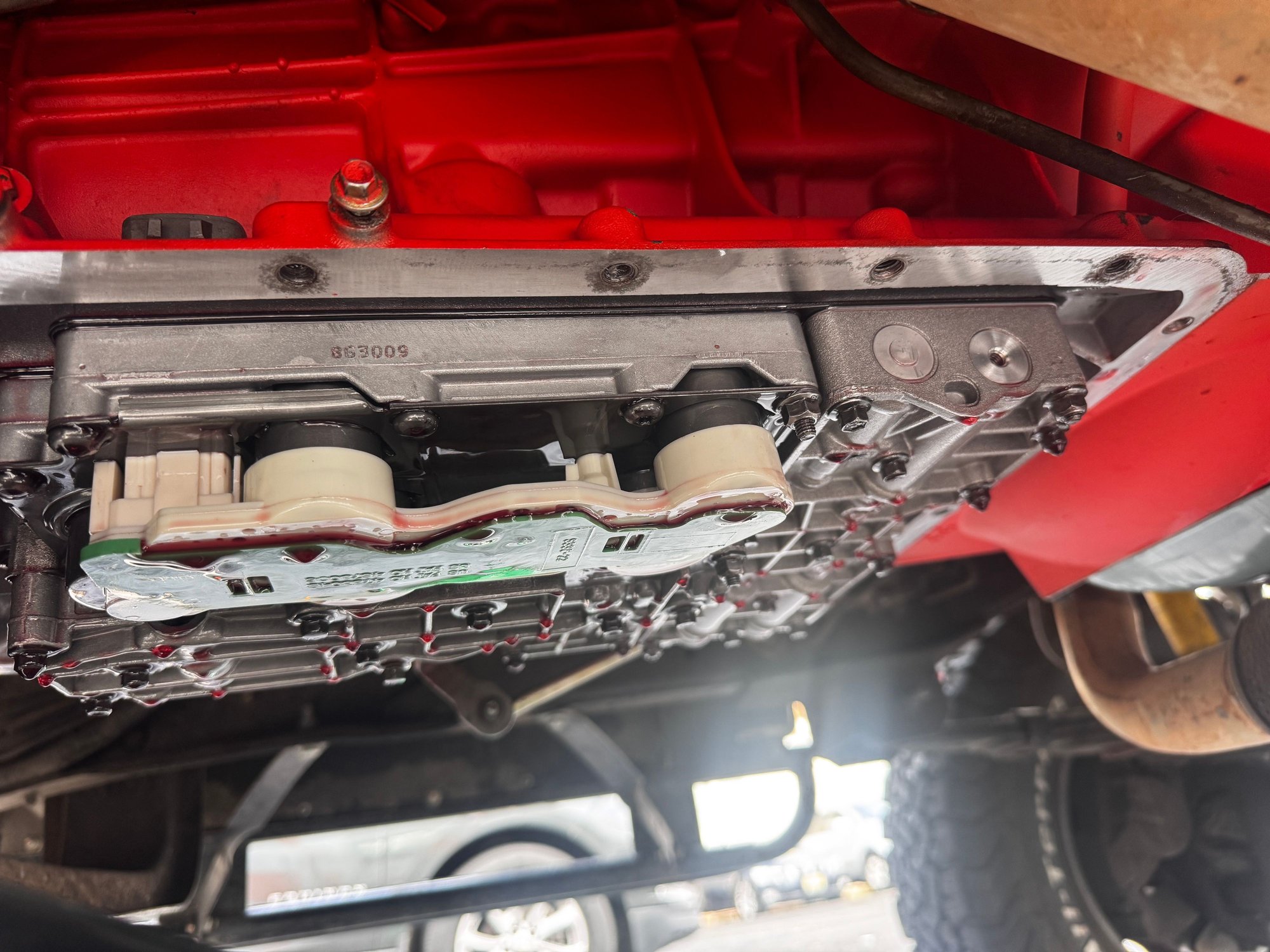

Originally Posted by FORDF250HDXLT
What did he say when snugging up the nut didn't fix it? Did he say he'll check the pack again? Why didn't he right then, once he saw it didn't fix it? Is he even pulling the codes himself to see code 99? It's a shame you're here, because he should have addressed this issue before a reman. The old trans was probably just fine. Probably only needed a solenoid pack, given you're right back where you started. You probably hate to hear this, but I suspect it and you probably do too. How much trust do you have that he truly tested the pack in the first place?
He actually seems like a pretty well intended guy, though what I think his fault is he gets tunnel vision in on the first thing he sees and doesn’t consider other variables. He said he will open it back up and take it all the way back down if he needs to. I’m going to source a new solenoid pack for him anyway. The one he was intending to put in mine looked like it was pulled from another trans and not reman/new anyway. And a transmission controller (TECA) just in case.
Snapped these while we had it open.
All that said, I want to not assume myself. Until it’s fixed I still don’t know what’s at fault here.
Code 99 - Transmission EPC circuit/solenoid failure isn't an assumption though. It's a known. You always want to start with codes. Never ignore them, unless you know you have a reason to.
There's no good, known reason to ignore this failure. Especially not twice. He can reman the trans 100 more times,but all those steels and clutches are not going to remove this failed solenoid (or wiring or possibly TECA, though unlikely) if he keeps putting it back in there.
That's good though, in that it seems like he's going to make it right in the end. He's just having a hard time getting there. Sounds like you're on your way to helping him get there.
