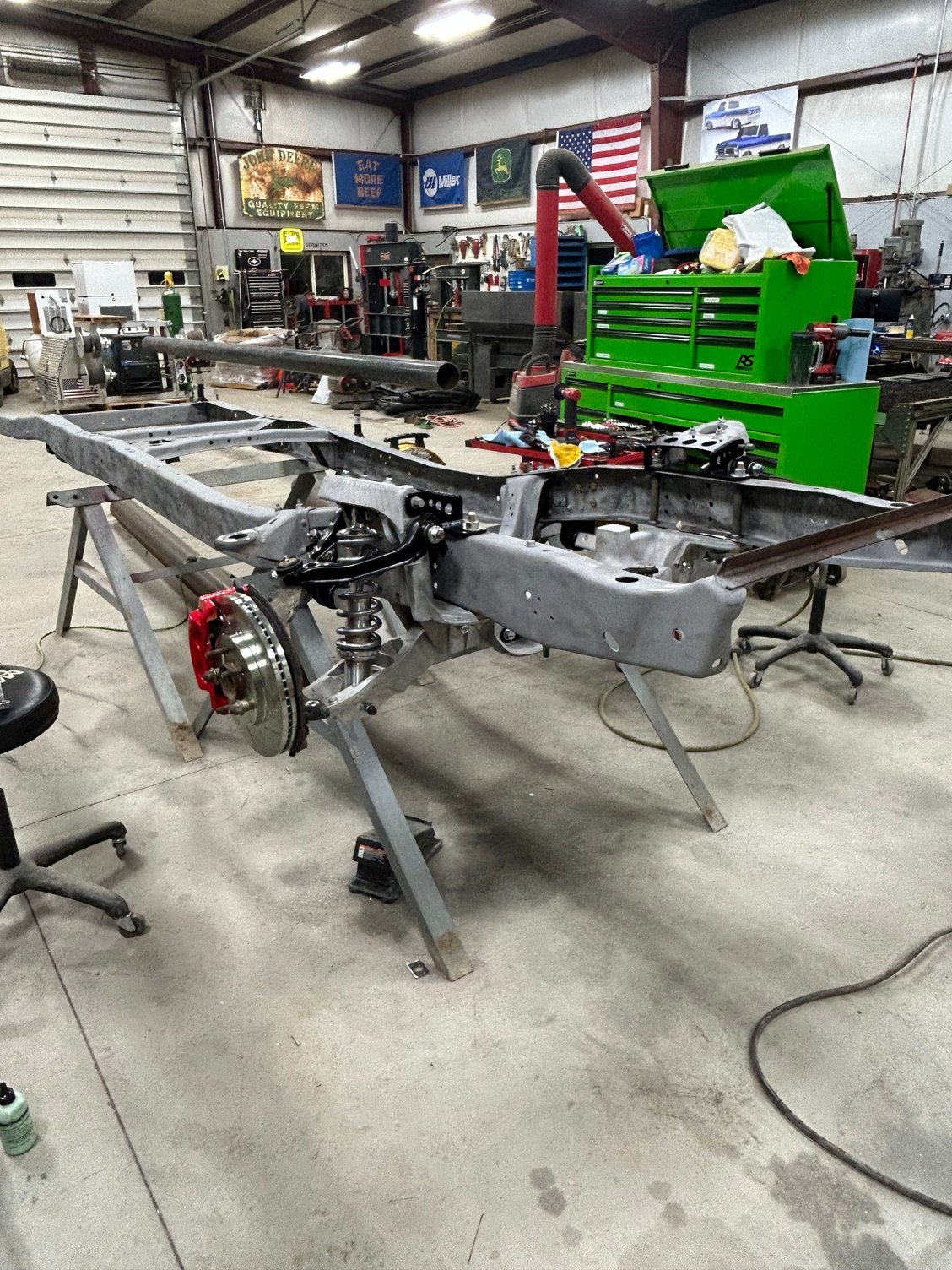

I’m in the process of a fully restoring my 71 and have gone the cv route. I have completely rebuilt the cv except for the wheel bearings. New discs, calipers, Viking coilovers, upper and lower control arms, and sway bar endlinks. There is getting to be quite a bit of good aftermarket support for our vehicles so getting parts isn’t bad. I bought a lot of the upgrades from F100 performance as well as outcast autoworks. As for the cv, summit has all the parts I’ve needed to rebuild the front end and not spend a fortune doing so. I’m not done yet so I can’t personally speak to how it performs, but it’s a well known highly used modification that drastically improves the handling of the pickup
