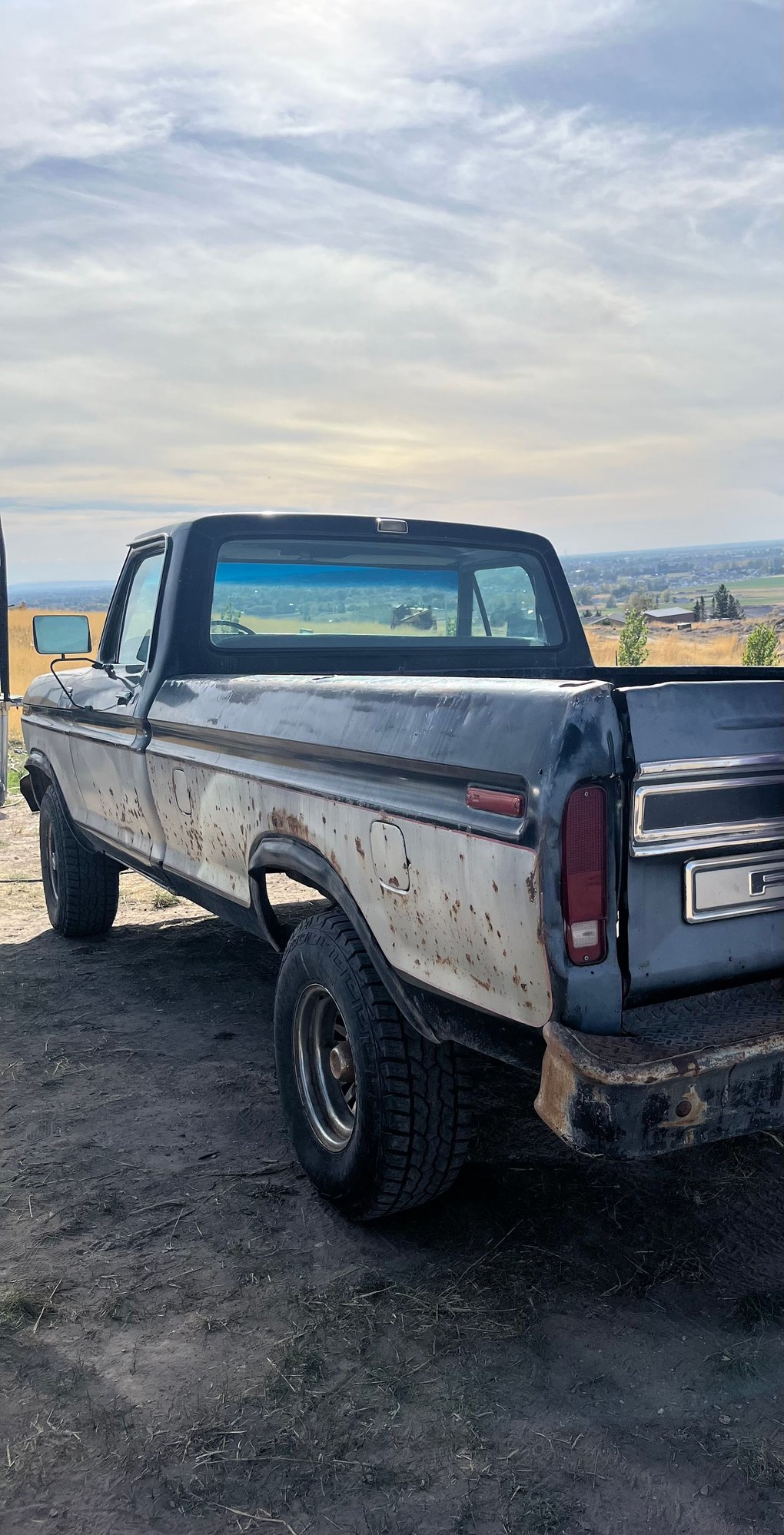

Hey everyone just looking to get some help with my side marker and tail light on the driver side. The passenger side works.
When I turn on my lights only the passenger side works. I bought the truck about two months ago so I’m not familiar with the history. It seems like it was in an accident. The drivers said tail light is broken in half but it has a new bulb for the brake light.
I don’t think I have reverse lights on either side and my blinker lights don’t turn on, on the dash.

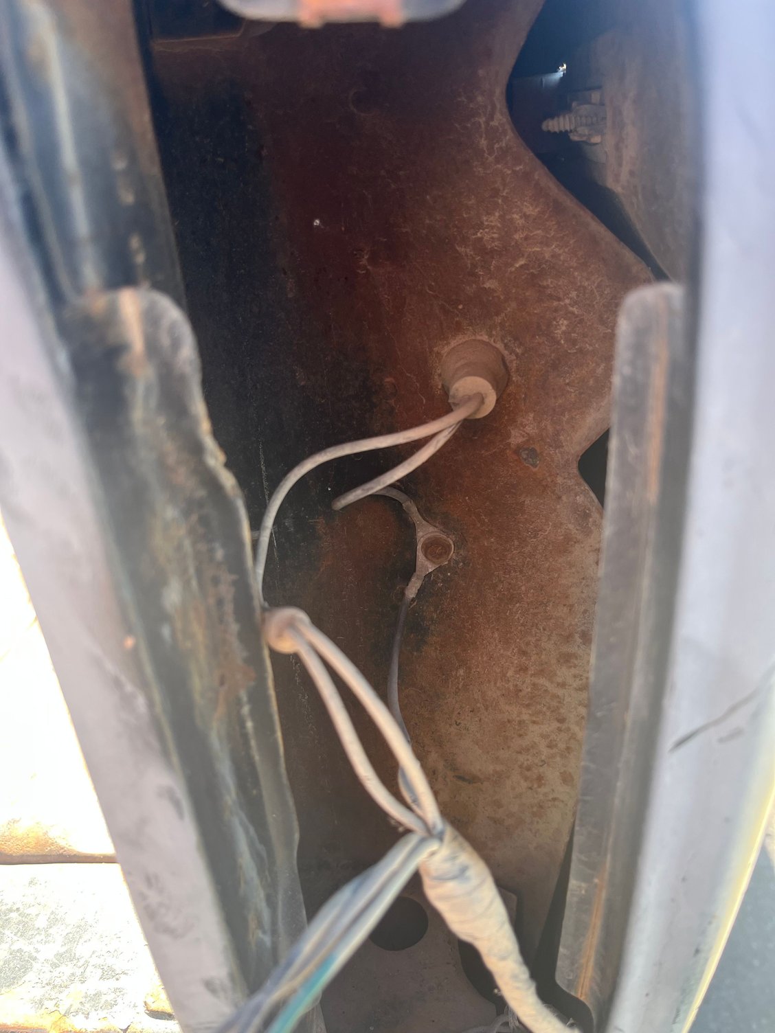

If it were my truck, since some lights are working and others aren't, I would start with cleaning all the grounds. Battery negative to engine block, engine block to frame if it has one, you can add one if it doesn't. Engine to firewall ground, and near each light socket there will be a body ground. If there is no bed to frame ground it wouldn't hurt to add one of those too.
Clean the contact area and the terminal with a wire brush, sand paper or emery cloth. Next I would inspect and replace or clean the light sockets. If they are beyond repair, or heavily corroded you're often better off replacing the entire socket. Replace any bulbs that appear to be burnt out and have any kind of discoloration inside or they have broken filaments. For front turn signal and rear brake it will take an 1157 bulb. Backup lights are an 1156 bulb. For side markers you can use a 194 bulb.

X2 clean and ensure the grounds back there are 100%. Then ck to make sure power is getting back there. Multimeter time. Then check the condition of the socket for the bulbs and of course the bulbs themselves.

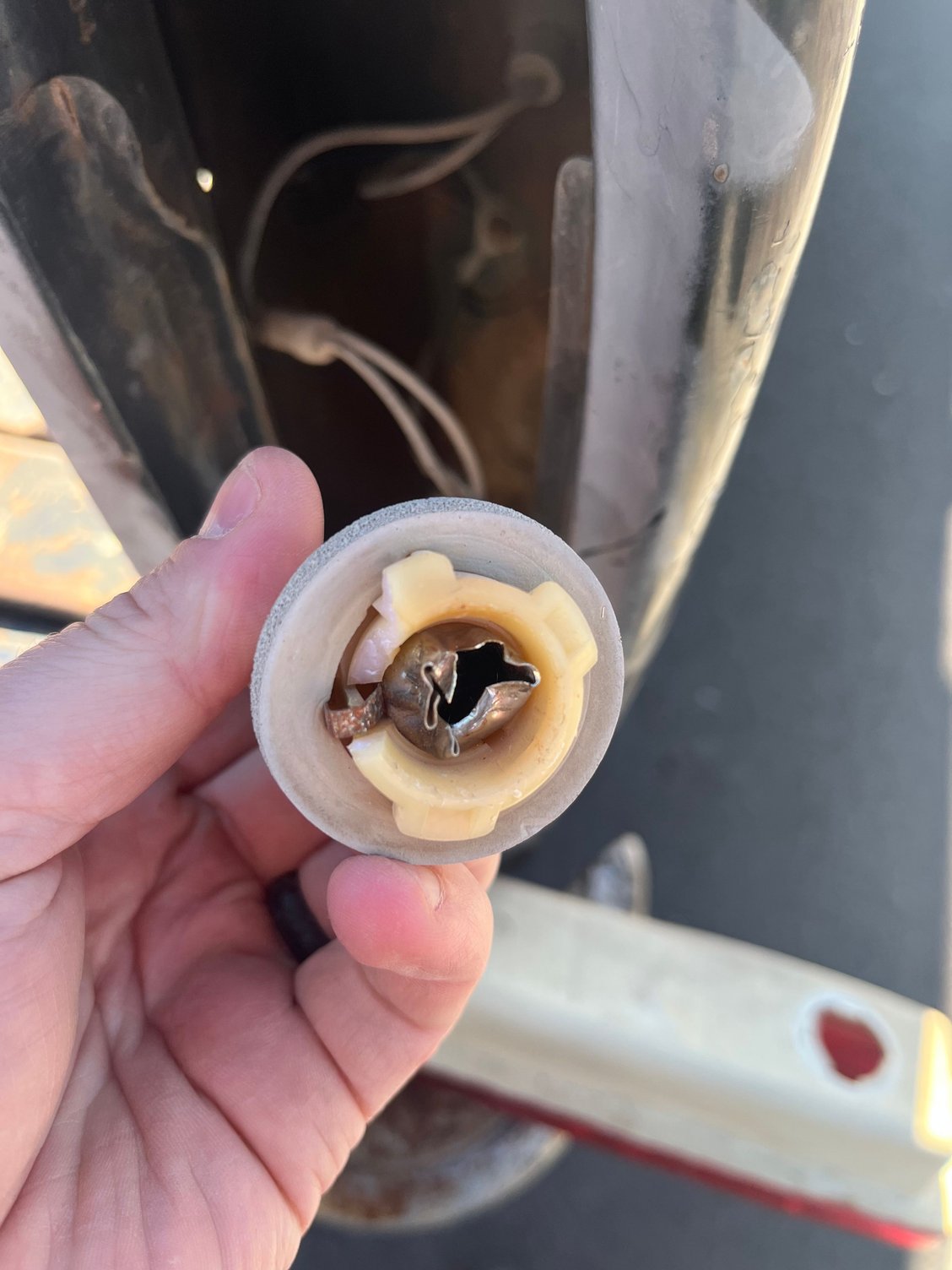

In cleaned the socket metal connections and it seems with testing 1 bulb on each side that they are working correctly other than when I have the lights turned on meaning the **** pulled back either in the first position or fully extended out. They only work when the light **** is pushed all the way in.

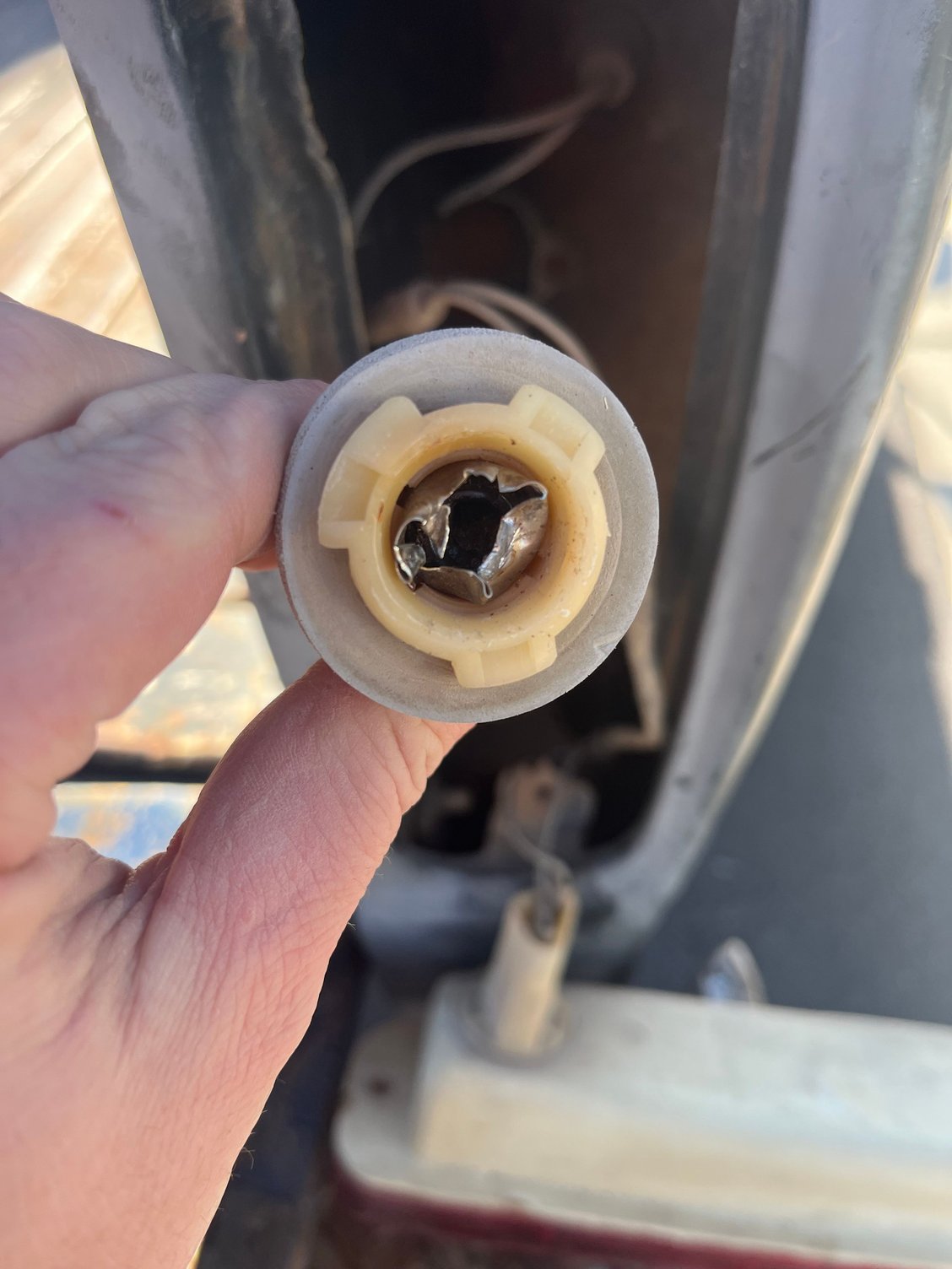

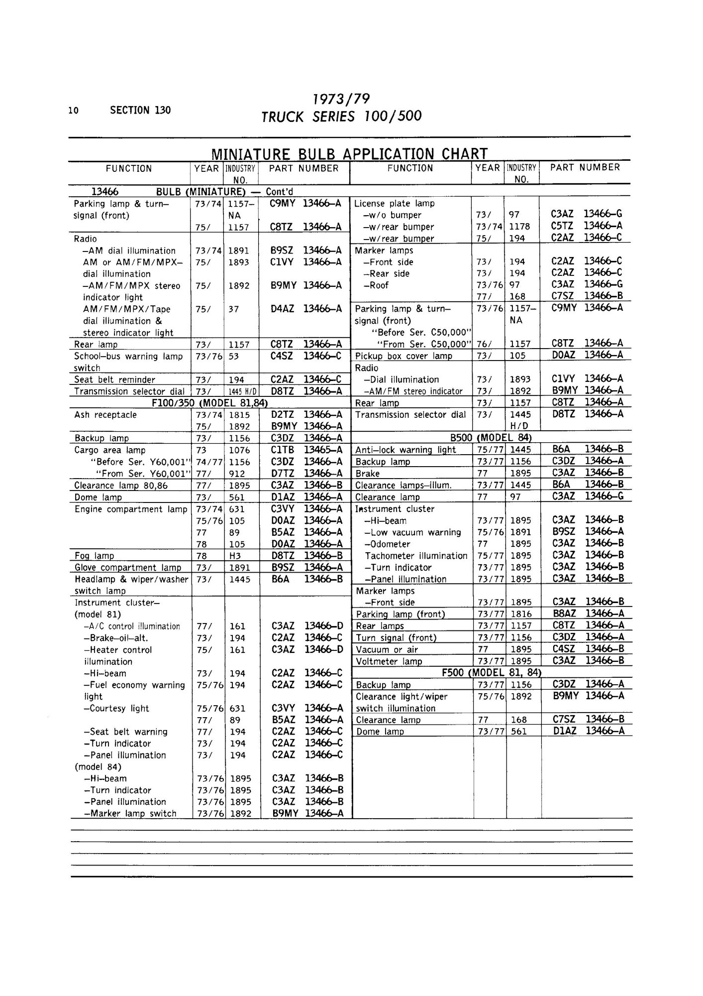

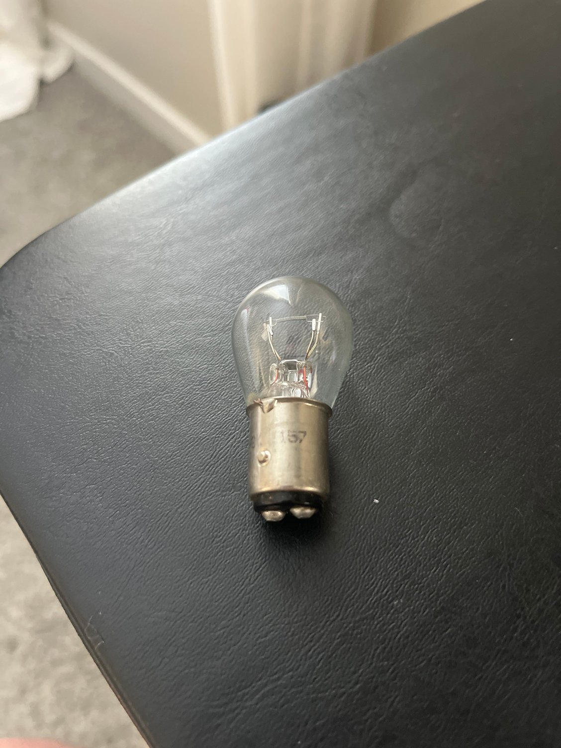

Also what are the correct bulbs for the tail lights? I’m also thinking I will do the reverse lights as well.

If I have my numbering system correctly recollected, the back up lamps are 1156 models, and the stop/tail/turn bulbs are 1157s.
While you’re getting bulbs, get a small tube of dielectric grease also. As long as the bulbs have good contact the non-electrical properties of the dielectric grease will serve to keep things from rusting in the future.
And keep bulbs from needing special tools to remove! :-)
if that socket with the stuck bulb looks even remotely compromised, it might be a good time to buy a new one and splice it in.
If that dark area around, it is from burning/overheating, it might’ve compromise the connections.

Good idea! I just finished replacing the backup lights, tail lights and cleaning the grounds. And now everything is working as it should except for the backup lights up lights. Must be the connection at the transmission.
I think the biggest issue was the corroded sockets. We’ll see how long they last the way they are. I think once they go out again I will replace the sockets.

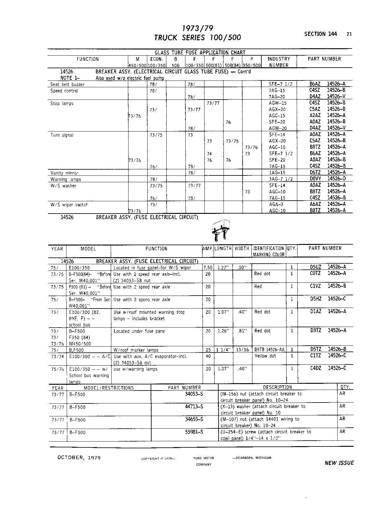

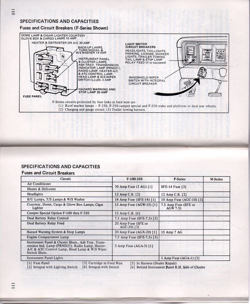

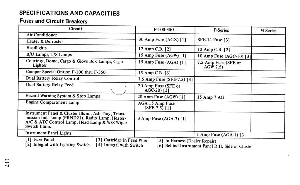

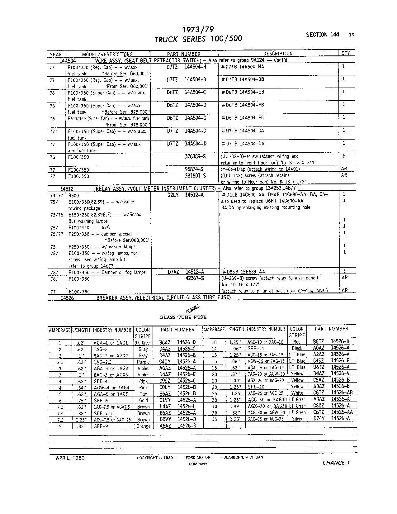

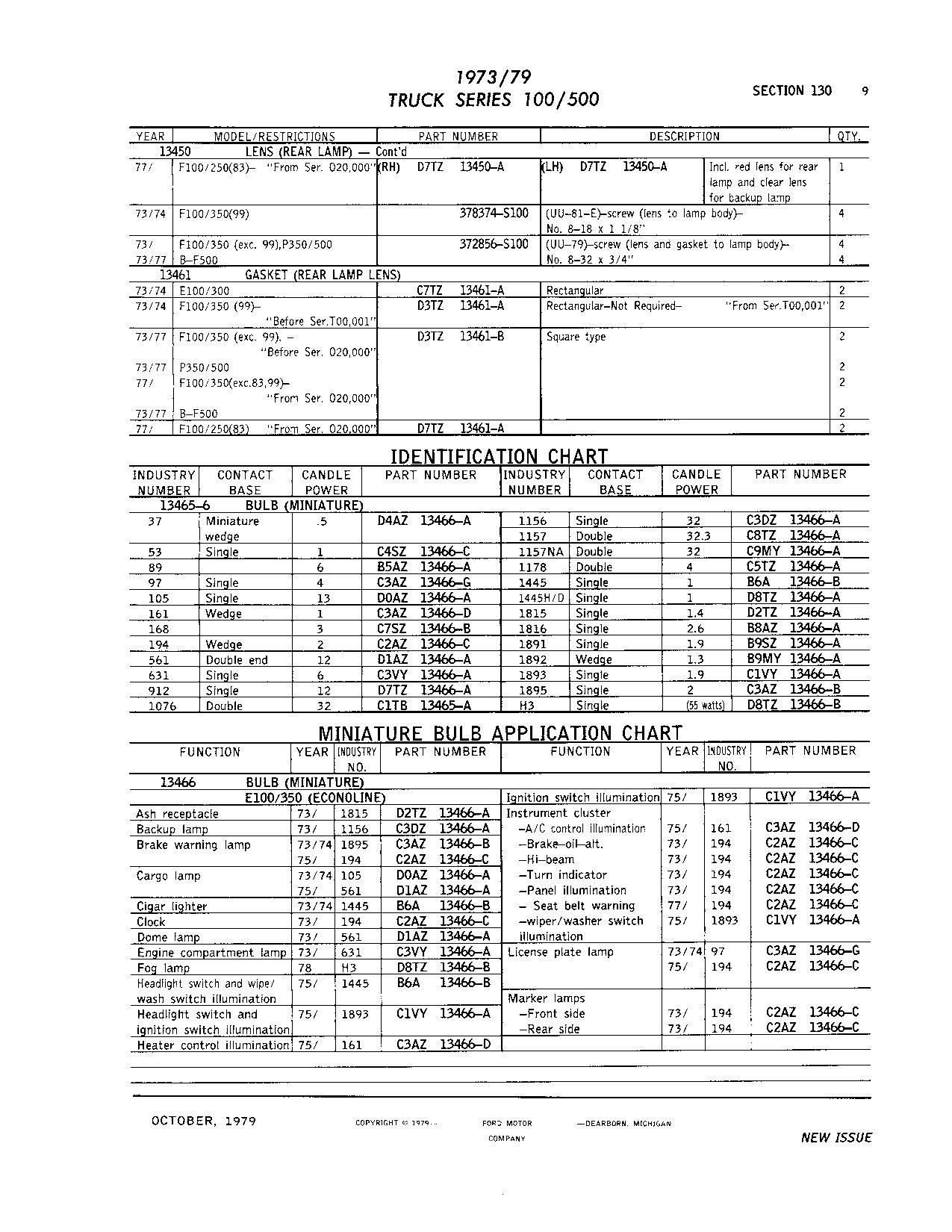

For your viewing pleasure.

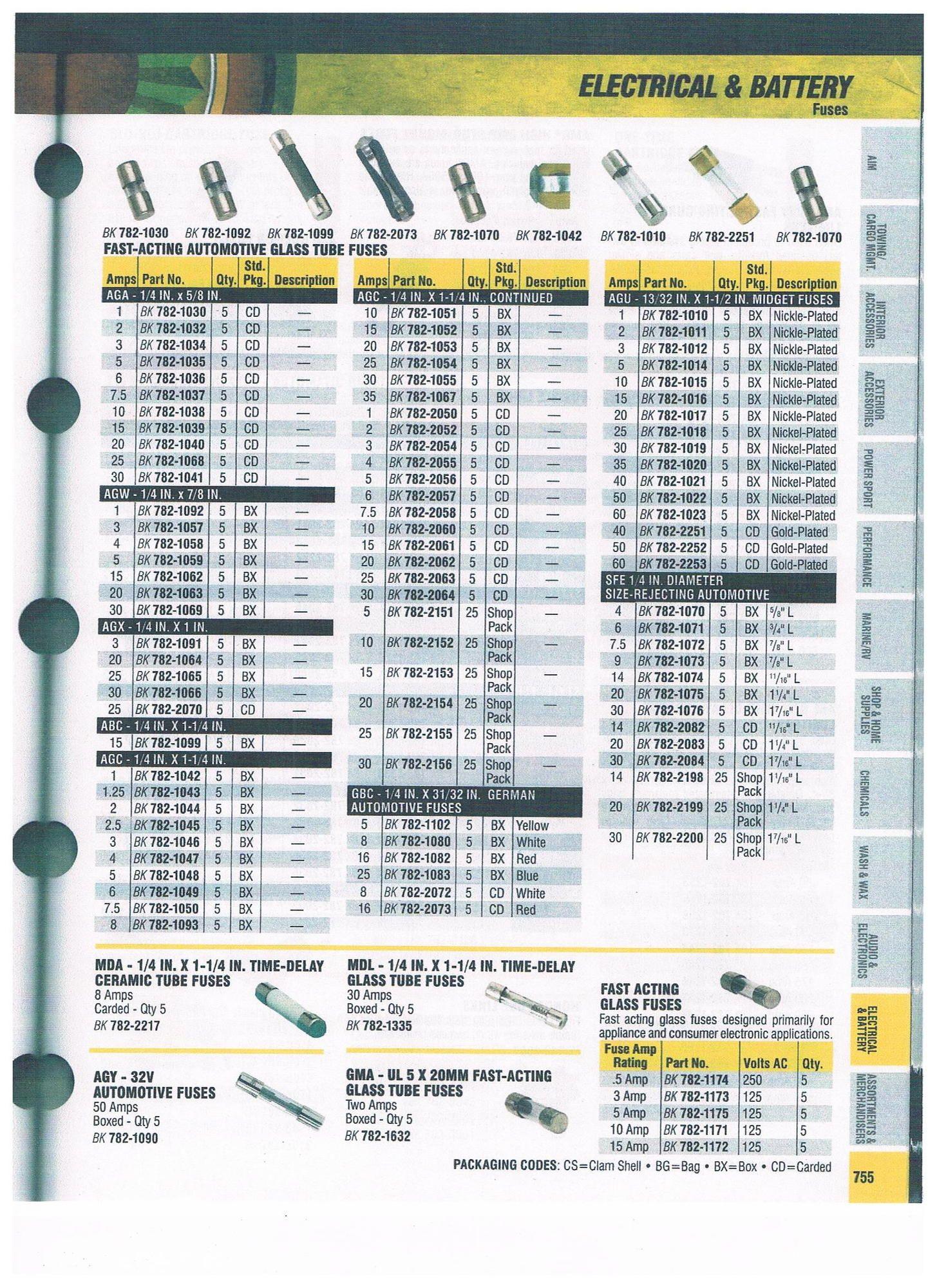

And now fuses.
