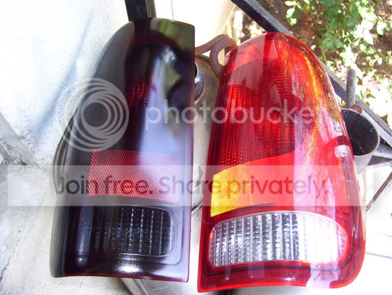

My first time (8 coats?):
Severely cut down the light output.....

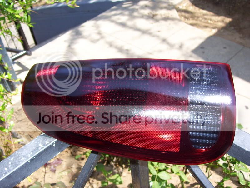

Now (3 coats or so):
Much easier to see the lights and in the sunlight you can still see the red of the lens.

The Original poster used VHT Niteshades, I used model tint from Hobby Lobby. The key is a good clear over the tint, IMO.
I've had my tails tinted for close to 2yrs now, still look exactly the same as when they were done.

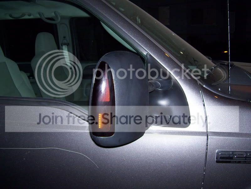

Here is how mine turned out .. I also tinted the turn signals on the TT mirrors
DCSpecial: your truck looks bad ***!!
-Junior

I did have a county sheriff mention my tail lights to me when they were as dark as the first picture (with the chrome bumper and black exhaust). He was at a gas station when I stopped in to fill up. He waited for me to come out to go over a few things he noticed about my truck.
That's why they aren't nearly that dark now. They don't really cut down on light output any more. They are basically just a darker red:
Parking lights, turns, brakes, are just as easily visible in the daylight as they were stock.
