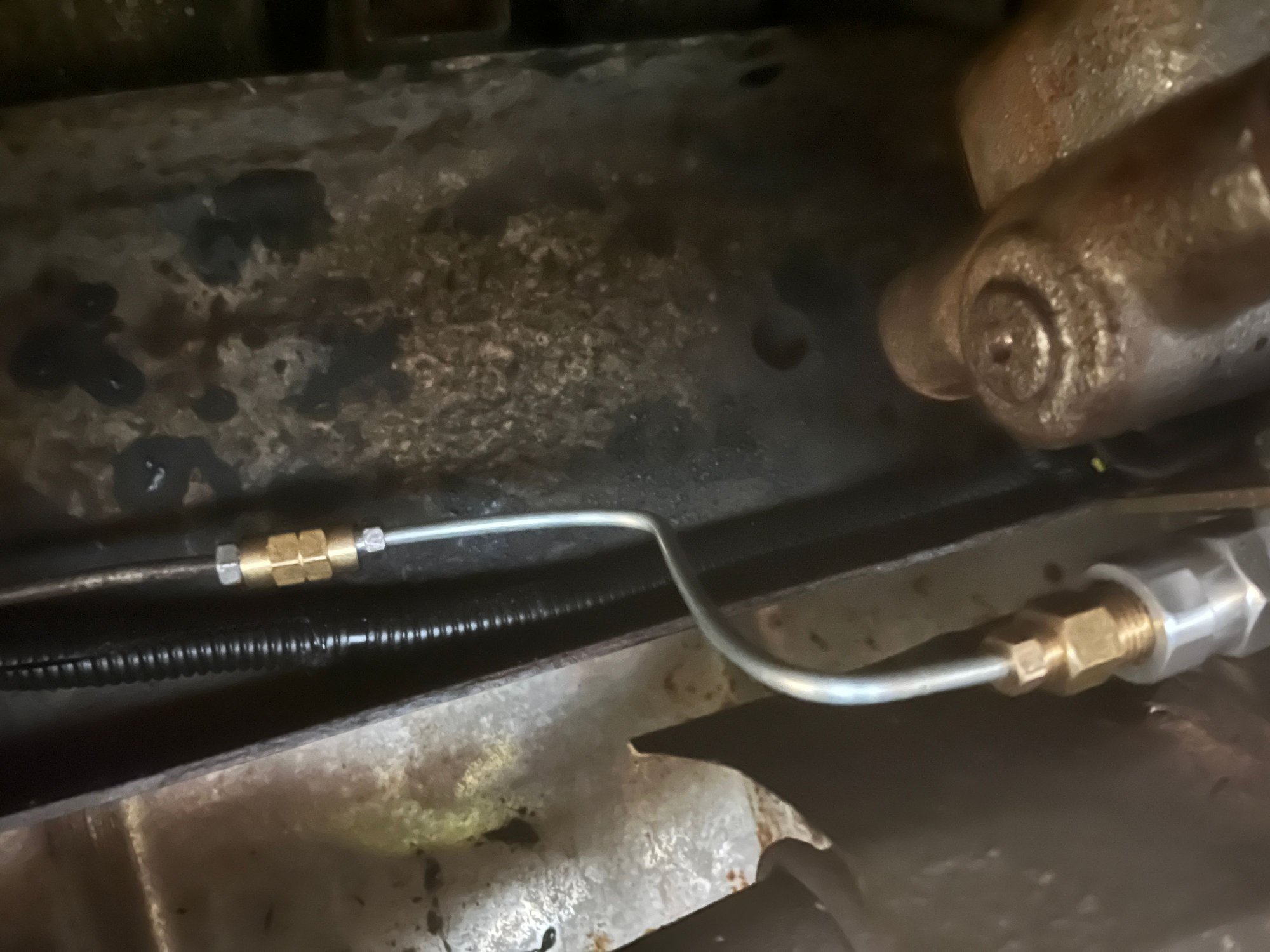

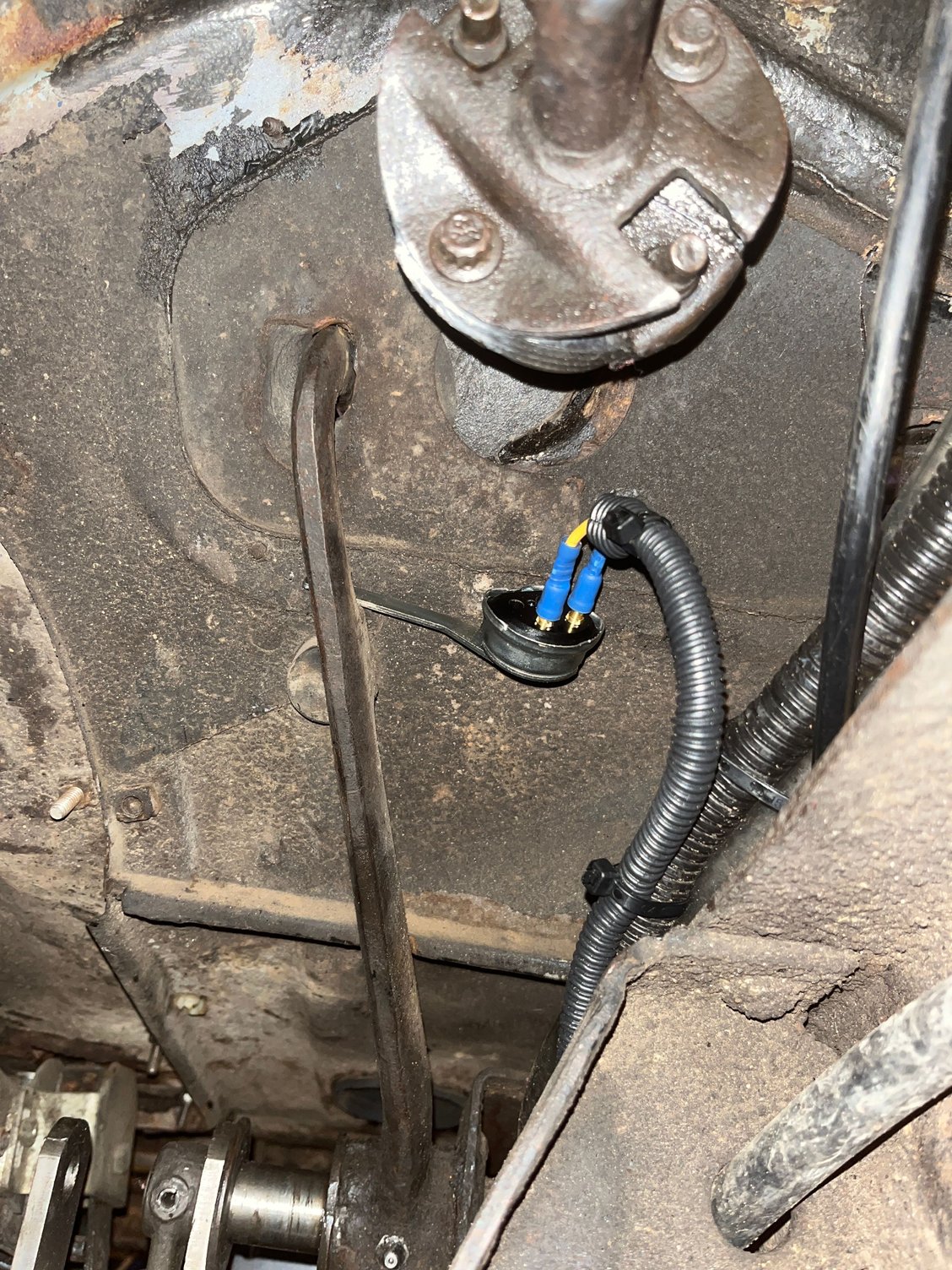

I pulled the trigger and the install went very smoothly. The monster of a construction that came with the upgraded brake system had a lot of parts and custom lines, the more parts the more chance of a leak.

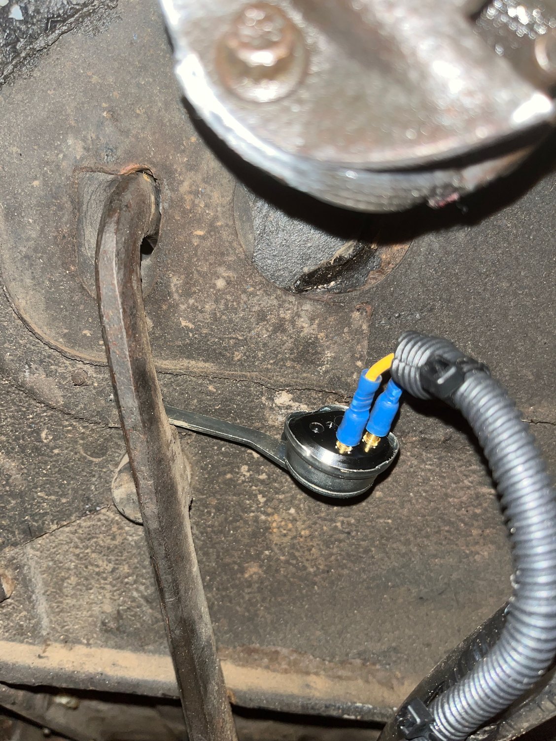

- Used Standard SLS40 pressure switch. One hot wire on one side and when the lever comes up just under a 1/2” you get power to the other side. The unit is small and operates smoothly
​​​​​​- I took out the pressure switch portion and made a one piece brake line replacement, no leaks
- The mounting was easy, #8 sheet metal screws, fit the holes in the switch and not too long, went under the brake pedal arm like a glove.i could have went farther but there is a slight ridge and the arm was far enough to work with no over extension or jamming
- Then I extended the wires from the master cylinder to the new switch, cover in conduit and zip ties.
- Tested and it works great. The pedal travels far enough the switch comes on before the brakes actually engaged fully. The break light should come in with dry little travel, if it only comes on when engaged fully you can have issues.
Will buy a replacement in case they stop making this switch but it was 30 minutes and done.
Replacement brake line, very easy to make
Replacement brake line, very easy to make. Looks like a pinch but it is only the angle
Switch under brake pedal arm with connectors
Closer look at switch
