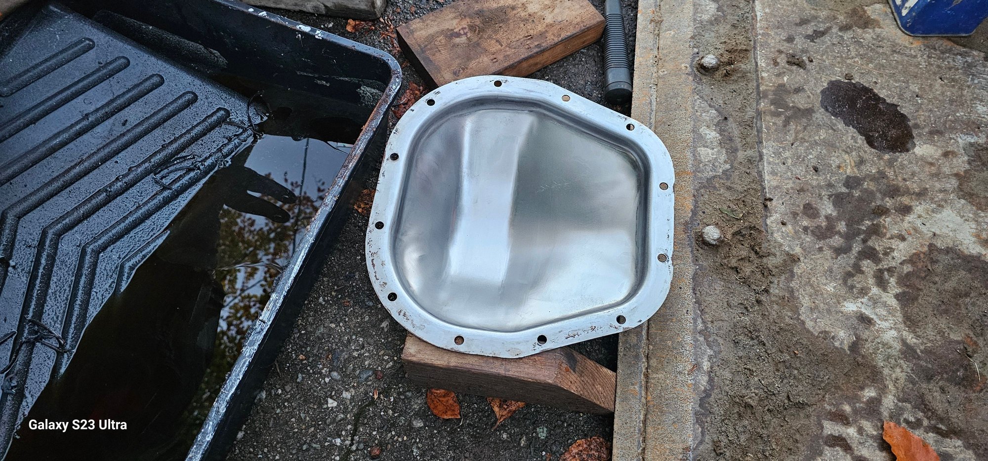

I did not expect the inside of the differential cover to look like this. And I promise you the only thing that I did was wiped it out with a clean & dry
microfiber cloth
