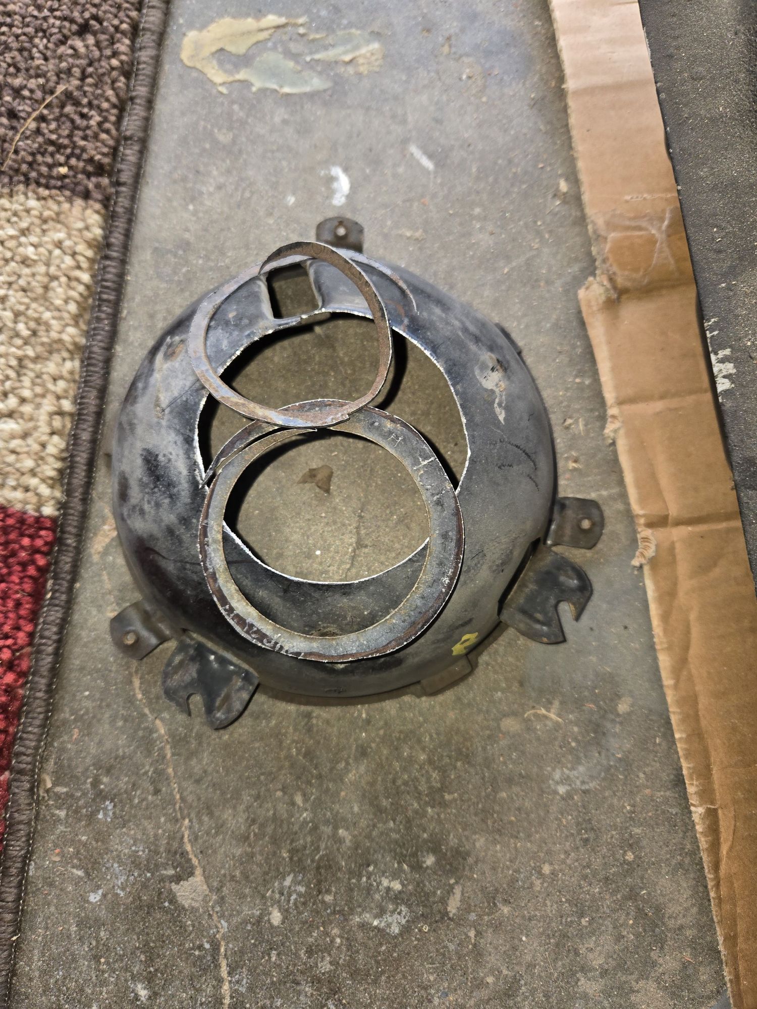

In the following photo you can see the problem: The new headlights won't fit in the bucket. I had to enlarge the opening at the rear of each bucket where the wiring attaches.
I set a light on the back of each bucket and traced around it with a sharpie.
But cutting out that much material means you cut off the factory stamp that says Top, and RH, LH, so I marked the top of each with my yellow engine marker, and labelled them rh and lh.
Of course both my oem retainer rings were broken and I had to order new ones from Amazon. I chose Amazon for the quick shipping. I bought the Dorman universal ring. Not only was each $4 less expensive than the others listed, but Dorman was the only one with the Overnight Delivery option.
I cut the buckets with jig saw and filed the edges. Now I'm waiting for it to get dark so I can test my new lights. I do like the new style headlights and the way they look on the truck. For me, I don't care about things being oem. I want the best product that works well and looks good. My list of non oem is long:

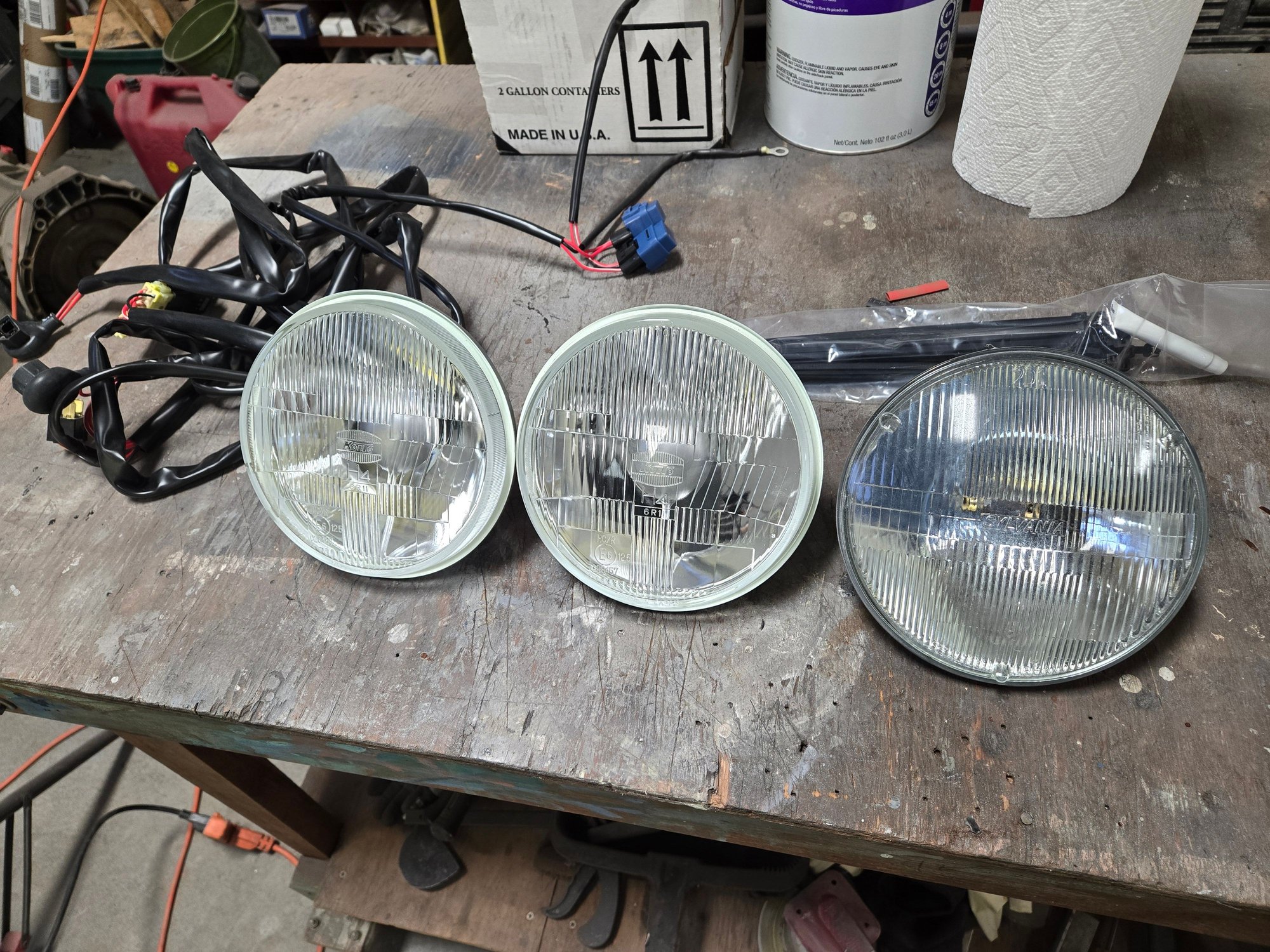

These lights for in the buckets with no modification
These lights fit in the buckets with no modification
New lights vs the old one on the left
New lights vs the old one on the right.
i think they look same as the old one when installed. You would have to look careful to see they are flat.
Overall I think this Toyota kit is a great bargain. The lights are bright with a nice cutoff. The harness is very well made and more than long enough. They include a bunch of zip ties and dielectric grease.
Before hooking up the relays, I plugged the halogen in to the stock harness and then measured the voltage with the lights on. It was only 11 volts, vs 12.6 at the battery. Did they work, yes. But not as well as if they had full battery voltage as they do with the relay harness.
