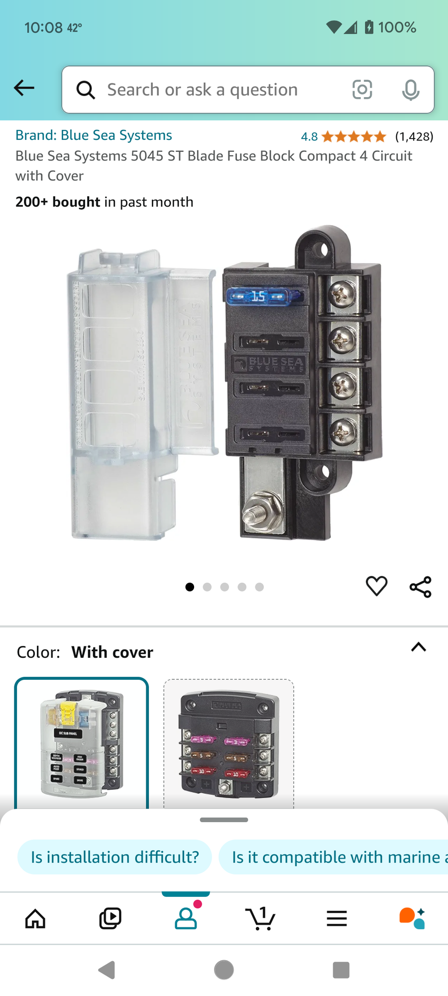

Originally Posted by F-250 restorer
Thanks. I ordered the same combo yesterday and am looking forward to the improvement. Often, when I drove at night, I had trouble seeing the lines in places. I will, as Fuzzface mentioned, upgrade the relays and saddles. I wish I had waited to order so that I could have gotten a better idea--via the forum--of what was out there. You guys showed me that there is many choices out there. That's the power of the forum. Thanks. Now I find that I need to install a power block between alt and battery so that I can access power. Does anyone know of a nice one?
When I did headlight conversion added relays and needed another circuit for in the cab I used the following. I mounted the fuse panel next to voltage regulator on passenger inner fender
