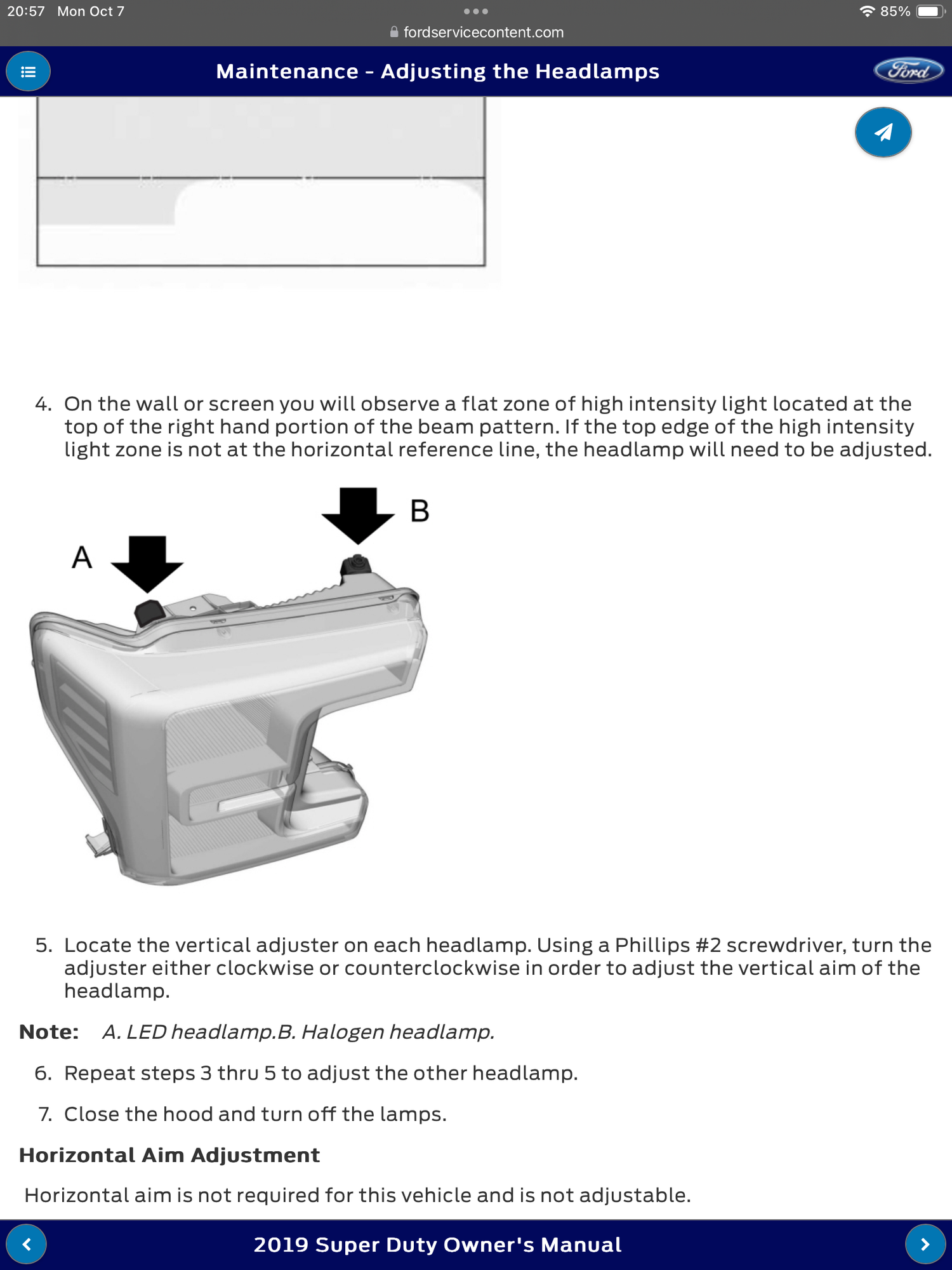

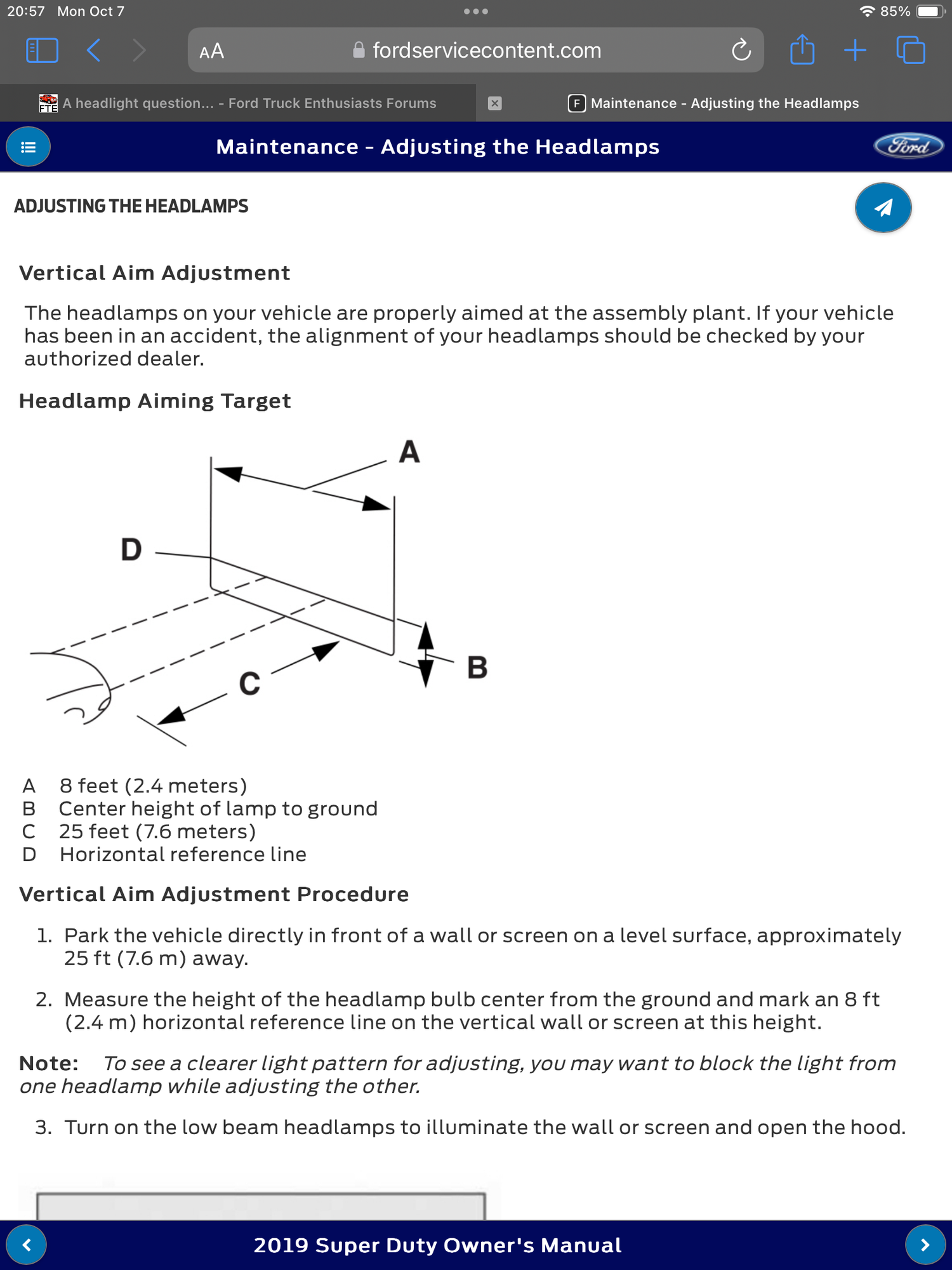

The drivers side is not down but it is adjusted horizontally at the factory and there is no way for you to make horizontal changes. As far as vertical setting, they should be at the same level. Check them yourself as mine were way off when I finally got around to checking mine. This is for a 2019 but the main process is still the same.
in addition, the adjustment screws are known to break easily so be careful with them and use a lot of silicone spray to help them move.

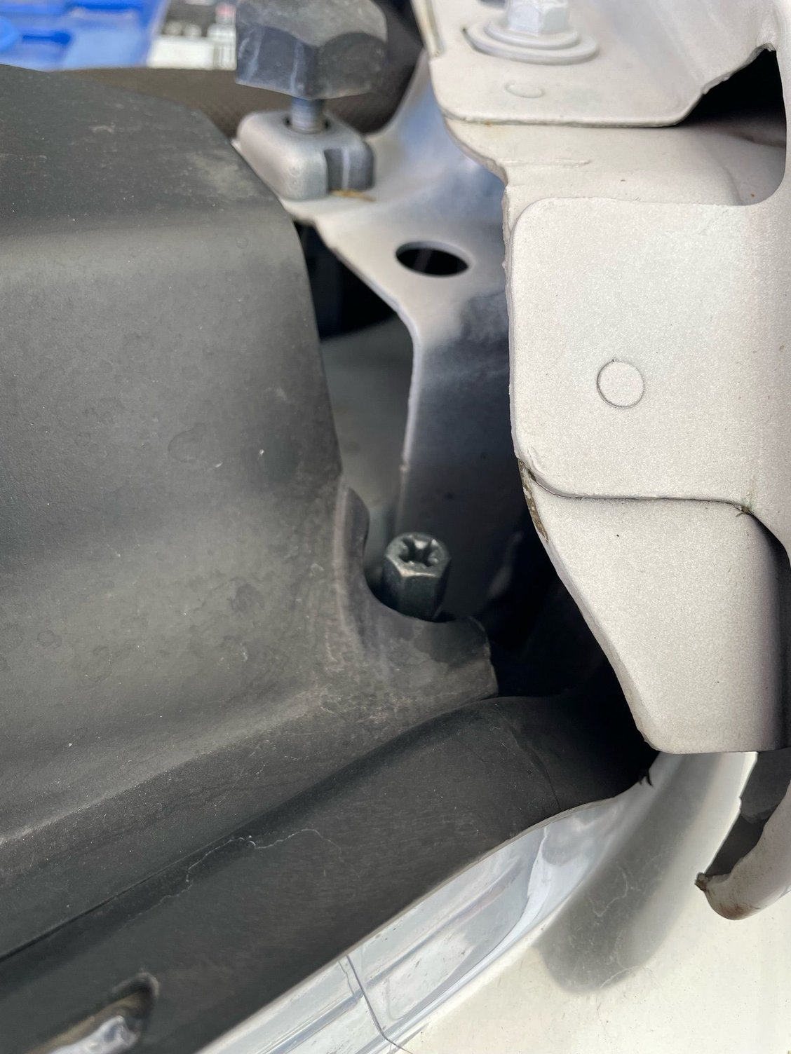

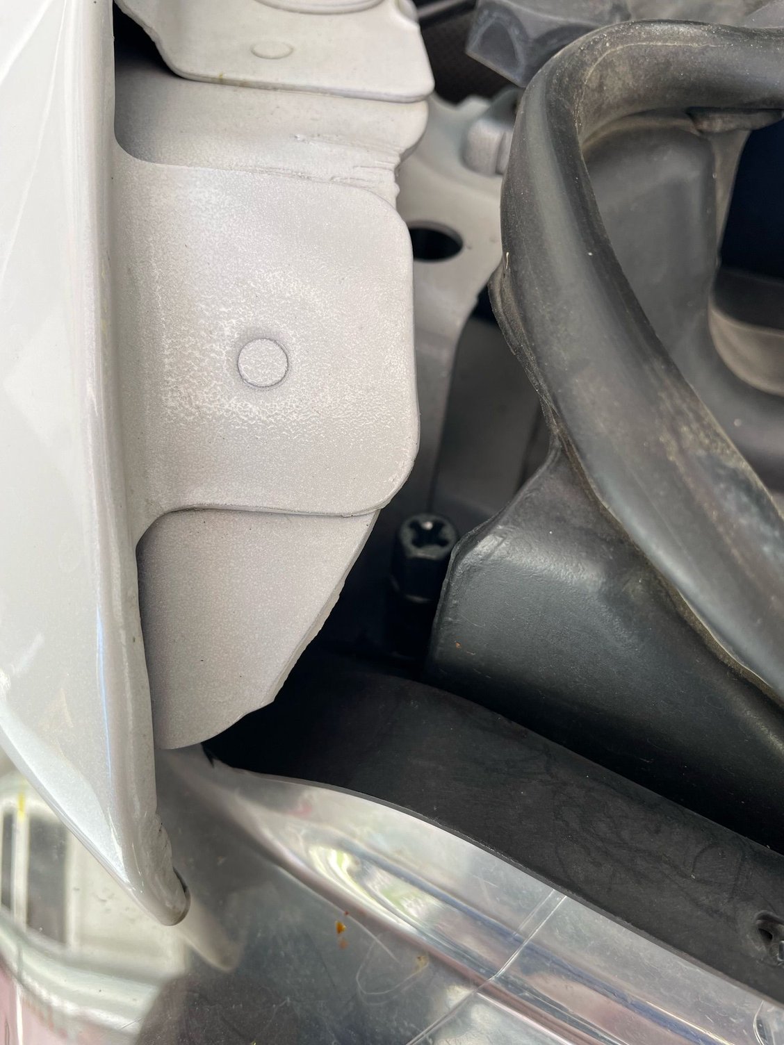

While mine is a 2019, I didn't have to dig as they are right there on top. These are for the LED headlights (see above diagram). I would image the newer trucks should have a similar location.
Driver side
Passenger side
If they don't turn very well, don't force them as once they break, they are set where they break until you get them replaced. Some folks take it to a dealer and have them do the adjustment that way if they break it, they fix it. The downside to that is a technician can break one and not say anything and you will never know. It took me a few days of spraying and letting it soak and then keep repeating once or twice a day until they free up a bit. I set the screwdriver in the Phillips head and just wiggled it back and forth and finally it worked. Still a bit stiff but nothing like it was prior to soaking it down. Every year now, I spray them just to keep them loose.
