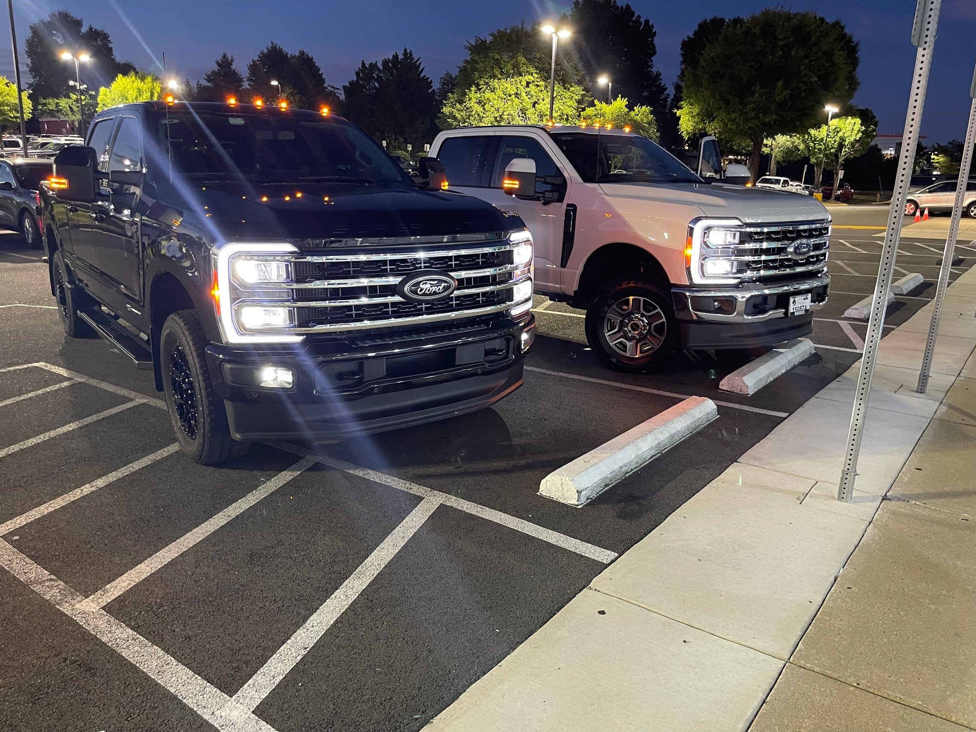

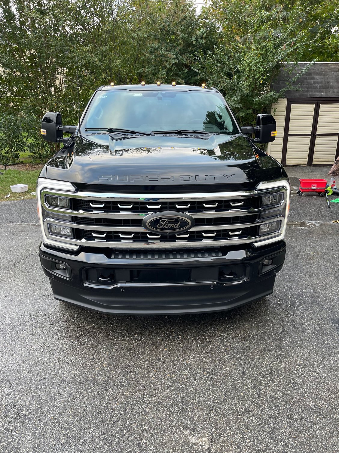

here’s my 23 with led reflectors to reference….
OFF:
ON:

Thank you for the pictures! I agree, I like the look of both of them lit up.
I had the projectors on my 22 Limited so I assumed something was wrong. However I noticed the 23 projectors are 'bending' lights and they have a little animation when you start them up.
